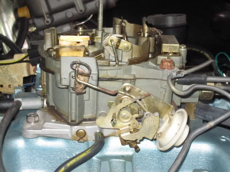

I wanted to thank everyone for all of their help. Finally got around to looking at it and to temporarily solve the problem we removed this piece which was connecting the secondaries and this white round thingy (Sorry - like I said, I am not very knowledgeable at this point) Seems to have solved the problem.
I also ordered the book that was suggested. I'm starting to read through it now(hopefully next time I will not reply with " white round thingy ").
I'm a computer guy, so still trying to learn all of this car stuff!
At any rate, we noticed that my car seems to be missing the kick down switch. I have been poking around the web looking for pictures as I can't seem to find the bracket that the switch would connect to on Jegs or Summit's web sites. I'm still researching this, but if anyone has any pictures, part numbers, or anything like that readily available, please let me know.
Once again - thank you all for the quick responses. Sorry for this delay - just got around to getting my brother over here to help me again.
