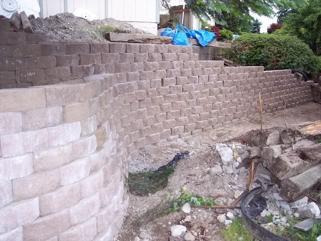

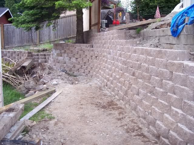

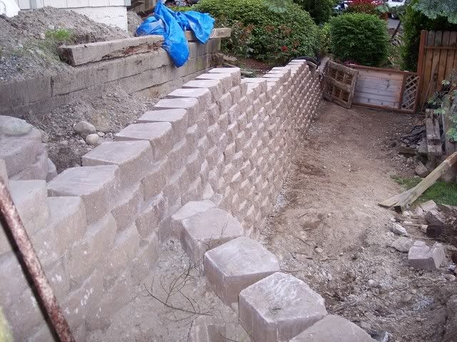

I replaced them (and then some!) with the large landscaping blocks This new wall runs across most of my back yard and all the way down the side yard between my neighbors place (their property is higher) The ties were a piece of cake compared to these (22 pallets in all) @72lbs per block... Anyway this wall will last much longer.
[Linked Image]
[Linked Image]
[Linked Image]

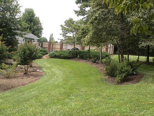

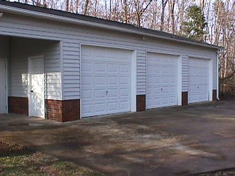

Here's my walls and fences. I had to much linear footage to go with anything but ties. I had to also go lesser grade due to 250 of them, and I've had to replace a few here and there over the last years. After 10 years I started have some issues, but not the lower ones, just the ones on top.
Brick wall around my pool I have treated fences between post for privacy and iron to see my yard.
I can't stress enough that it's got a lot to do with the quality of the ties you get. I just bought a dozen and their weights ranged from around 50 pounds to upwards of 200 pounds. You get some of those 'whoppers' that are soaking up all that creosote and they will last a long, long time. You get some of the ones that are 'light weight' and they probably will not last very long. I think they look really nice. Maybe I don't have any taste in designing but when I come around the corner of the house and see the small retaining wall it's pleasing to my eyes. I think the pics above are beautiful and very natural looking. Man! That must have been a LOT of work!
wow what a beautiful yard you have HO428.you did a great job.
Thanks, however my back will never be the same after that. The wife and I built that wall. It continues on around the house another 50 feet.
ho428, that looks great! Nice yard , nice retaining walls... a lot lower version of that was what i invisioned for Davids....
