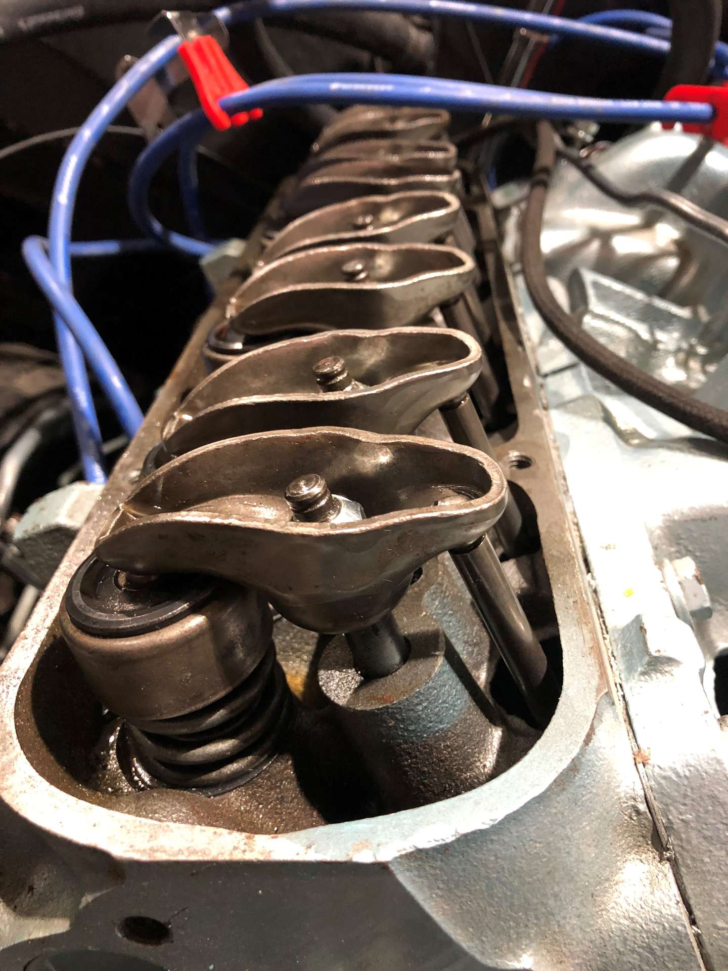

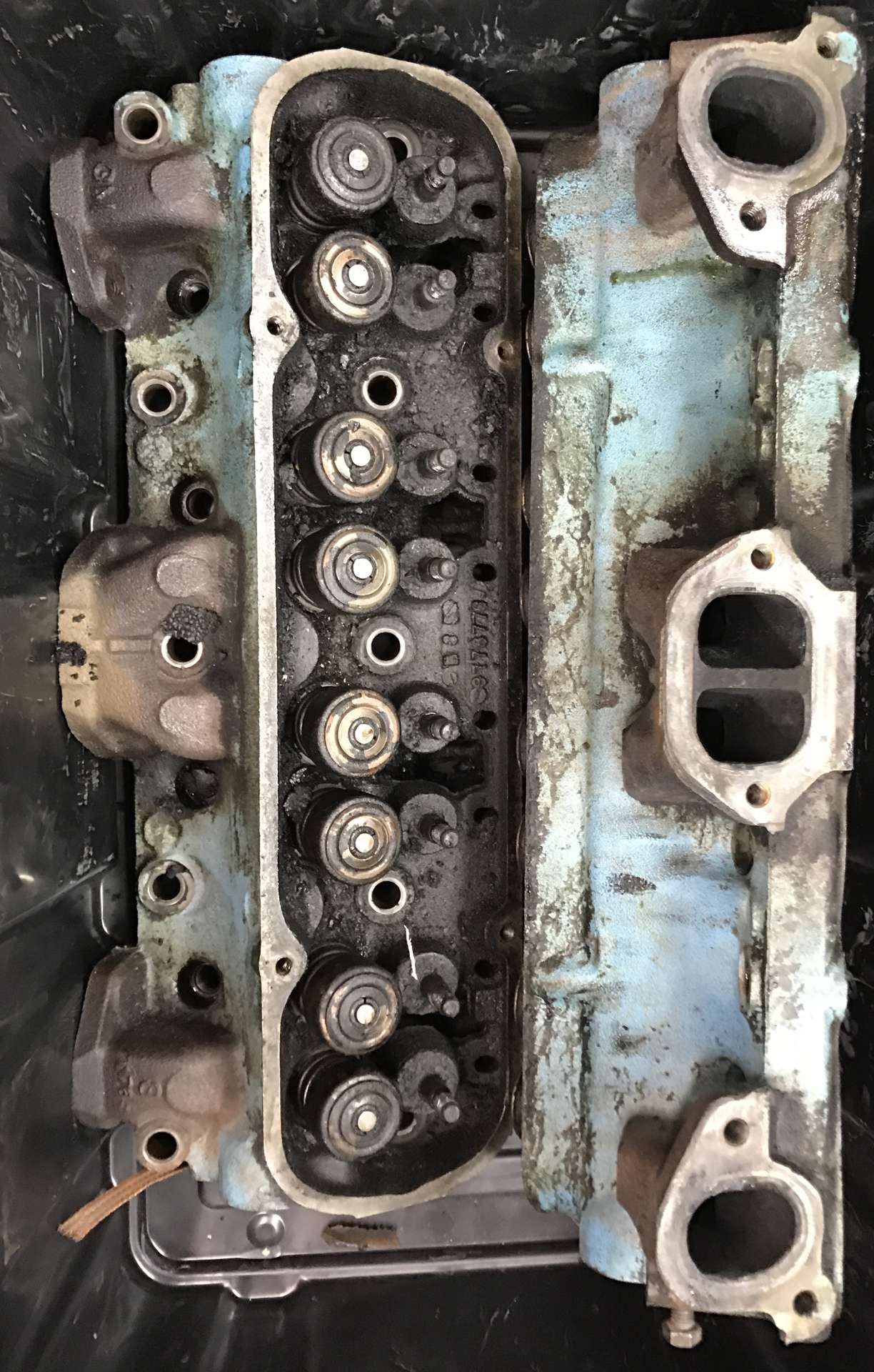

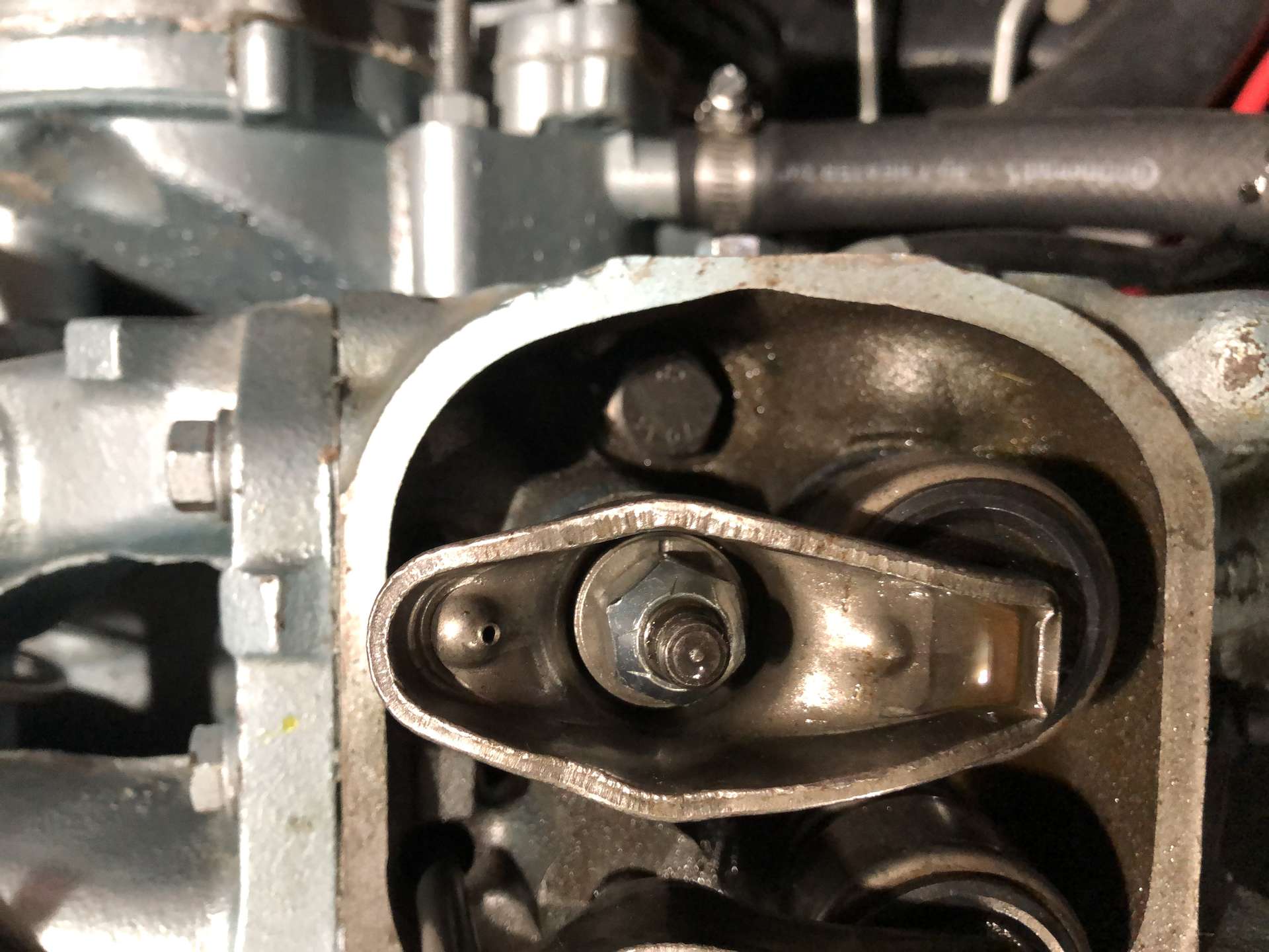

Here is a good one and although I think I know what it is I need to know which rocker arms to get. So here we go. I have a 68 Firebird originally a 6 cylinder and I found a 68 GTO 400 265 HP with the smaller valve heads casting number 14.When rebuilding, I had the machine shop put the larger valves in from 1.92/1.66 to 2.11/1.77 which fit with no problem and it has the stock stud. Here is the issue. After adjusting the valve lash, priming the oil pump and starting the motor the rocker arms began moving sideways and two of them on separate occasions actually walk off and the push rod popped off the lifter(luckily no damage). At first I thought it was just a loose adjustment or lifter that didn't pump up. Then I took a closer look and it looks like the rocker arms are literally touching the top of the spring. It appears obvious that i have to wrong rockers my question is what rockers do I order. When looking online I can't find any rockers for a 68 400 with the smaller valve heads, Should rockers from another year head with the same size valves work? Any input would be appreciated and yes I know someone will say put the right heads on and it is on the table. Ty all

Posted By: Gus68 Re: Rocker arms walking off sideways - 01/16/19 11:46 AM
Do you have proper washers on?
Does the nut loosen?
Posted By: oldskool Re: Rocker arms walking off sideways - 01/16/19 01:22 PM
I thought all Pontiac 400 heads had pushrod guideplates. I see none on your heads. I'd say this might be your problem.
In your lower pic, you can see a small portion of the hole where one of the guideplate hold down bolts is supposed to go.
And, the rockers shouldn't contact the spring retainers. As far as I know, all stock 1.5 ratio Pontiac 400 rockers are the same. I've swapped rockers from 350's, 400's, & 455's. Never noticed any difference, & never had any hit the retainers. I have seen the valve tips worn down to the point where the rockers were almost touching the retainers.

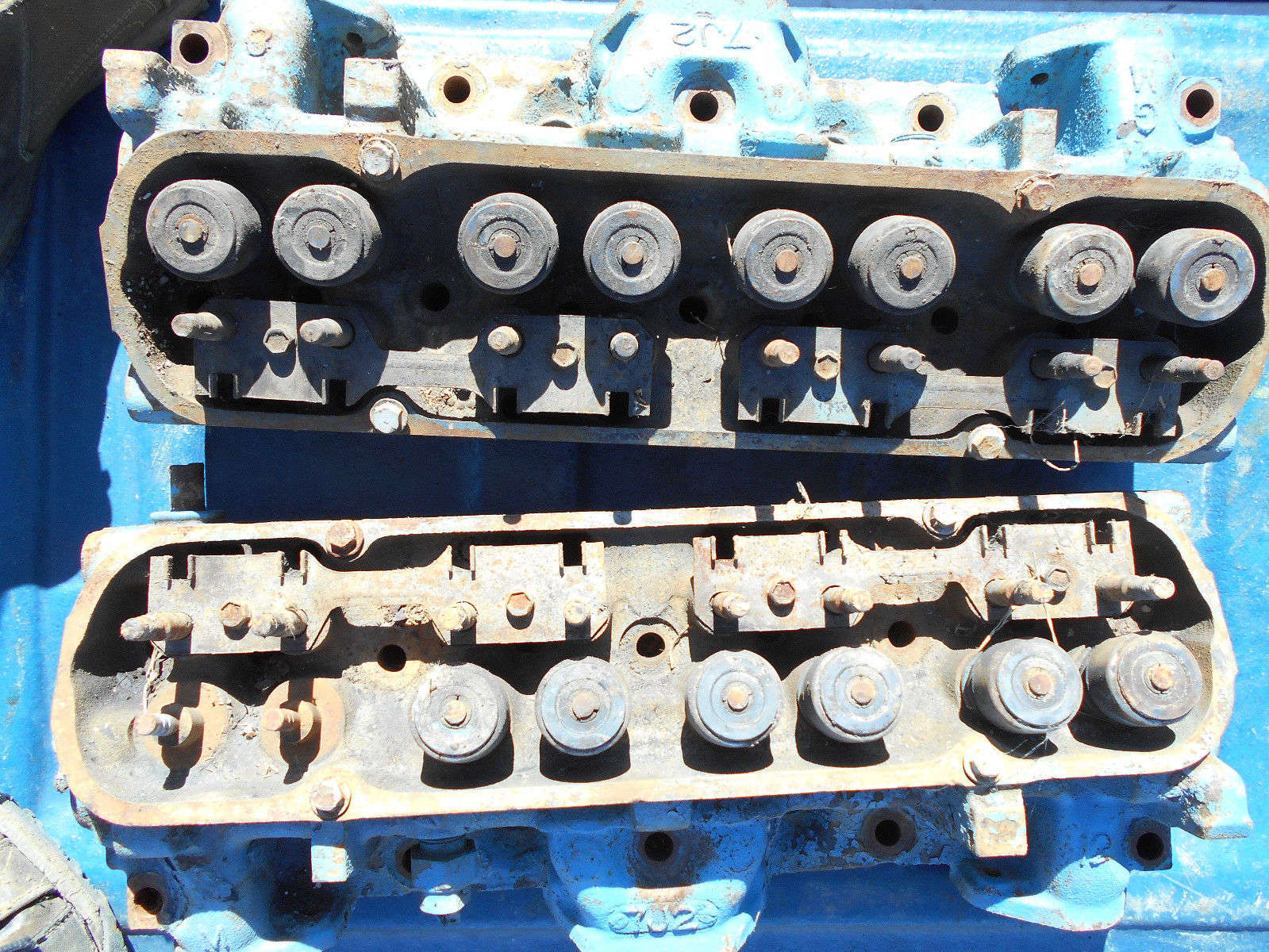

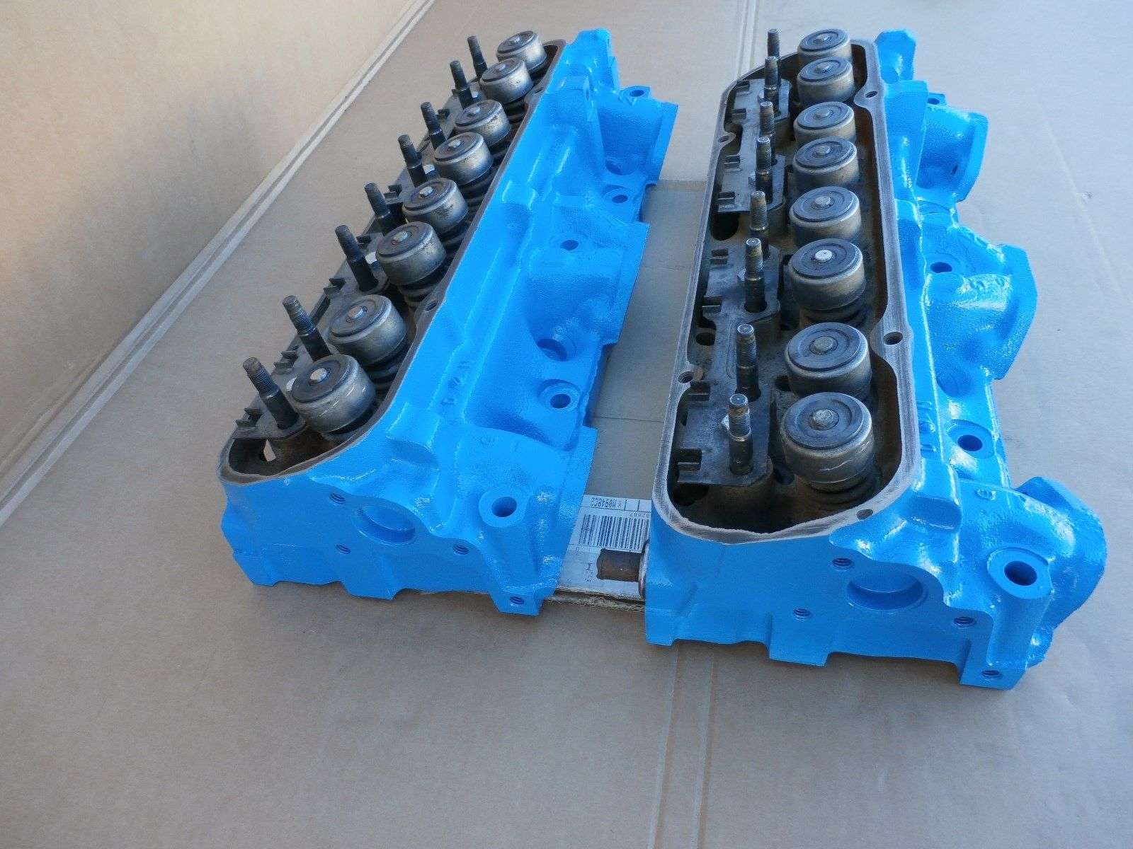

Don't have any pics of #14 heads. But below is a pic of some #11 heads. It clearly shows the guideplates bolted into place. The 2nd pic, of some 7J2 heads, shows exactly where the hold down bolts are located.

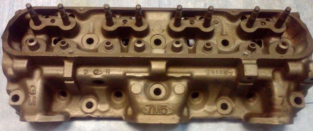

Posted By: Gus68 Re: Rocker arms walking off sideways - 01/16/19 01:53 PM
how bout these...65 TriPower
I changed the pic. This is my correct head for my 389 TriPower. No way to attach guide plates that I can see.
Posted By: oldskool Re: Rocker arms walking off sideways - 01/16/19 02:09 PM
Don't think 389's had guideplates.

Posted By: Gus68 Re: Rocker arms walking off sideways - 01/16/19 03:08 PM
Originally Posted by Mickey
Oldskool is right
You might be able to add the pushrod guides
Take a picture looking down at the head so we can see between the rocker arms
Do you have the stock cam or did you put a bigger cam
I tried to put in new guide plates but no go. No holes to fasten them to.
Posted By: oldskool Re: Rocker arms walking off sideways - 01/16/19 06:22 PM
[/quote] I tried to put in new guide plates but no go. No holes to fasten them to.[/quote]
Isn't that the edge of a hole I see in the bottom pic you posted ? If not, what is it ?
It's right beside the stud, showing just under the rocker arm.

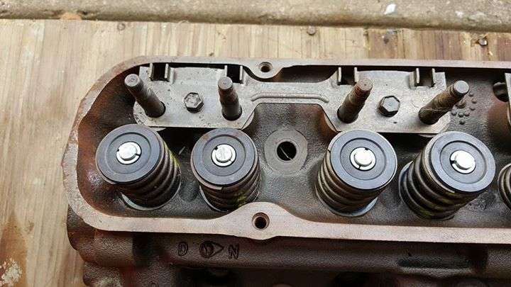

1st pic below is a close up pic of a guideplate bolted down on a small valve #16 head. Are you saying that your heads do not have any bolt holes in the 2 bolt locations shown ? The 2nd pic shows the holes, without any guideplates. As you can see, the bolt holes are between each pair of studs.

Hello and thanks for all the input but now I'm confused.I thought only Oldsmobile's had guide plates, Everything I've been reading says bring cylinder one to TDC, then adjust valves xxxxxxxx til push rods have no slack then another 1/2 turn then repeat for other 8 rockers, I put a mild cam in
Cam - 214/224 duration at 050" // 444/466 valve lift
Push rods - Comp Cams 7851-16
Rocker arms - Sealed power R-1032 New balls and lock nuts
Melling valves 2.11/1.77 length 4.998"

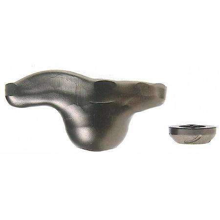

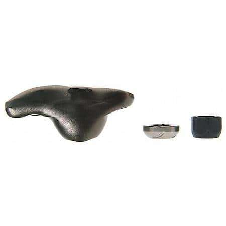

I'm adding pictures of 2 rocker arms, 1 from a 68 400 4bbl Firebird and 1 from a 67 326 I did order a set of the 67's and from the pictures you can see the height difference from the 2 where it's closest to the spring perch. The first from a 68 and second from a 67. One last note is that the valve's I installed according to Melling will not fit a 1968 GTO 400 2 barrel
Posted By: hdnorm2 Re: Rocker arms walking off sideways - 01/17/19 01:31 PM
CRAP, CRAP, CRAP!!!!!
Just looked at the repair manual again and missed the guide plates..... Guess ill be ordering them lol thx for all the help guys
