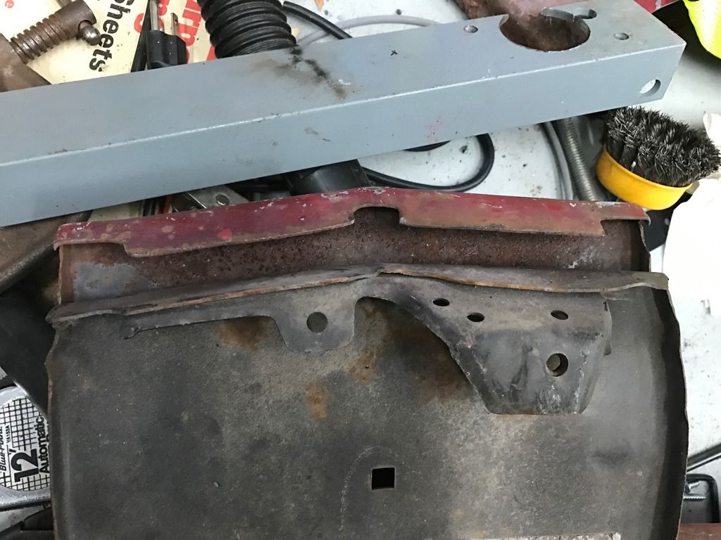

Posted By: D4VE67 Re: 67 Front Valance Differences - 02/21/17 01:28 AM
Here is a picture of the valances laid on top of one another. The one that came with the car had the center section bracket, the one I bought to replace it did not.
Also, I was looking on EBay and there is a picture of a valance for sale that has the center bracket. Which one is correct and what is the difference?

I'm stumped. Perhaps one is '67 and one is '68?

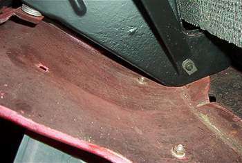

Posted By: Jimc2002 Re: 67 Front Valance Differences - 02/21/17 09:16 PM
My '68 has that bracket. It holds the valance to the hood latch support. I have washers between to shim it to keep from distorting the valance.

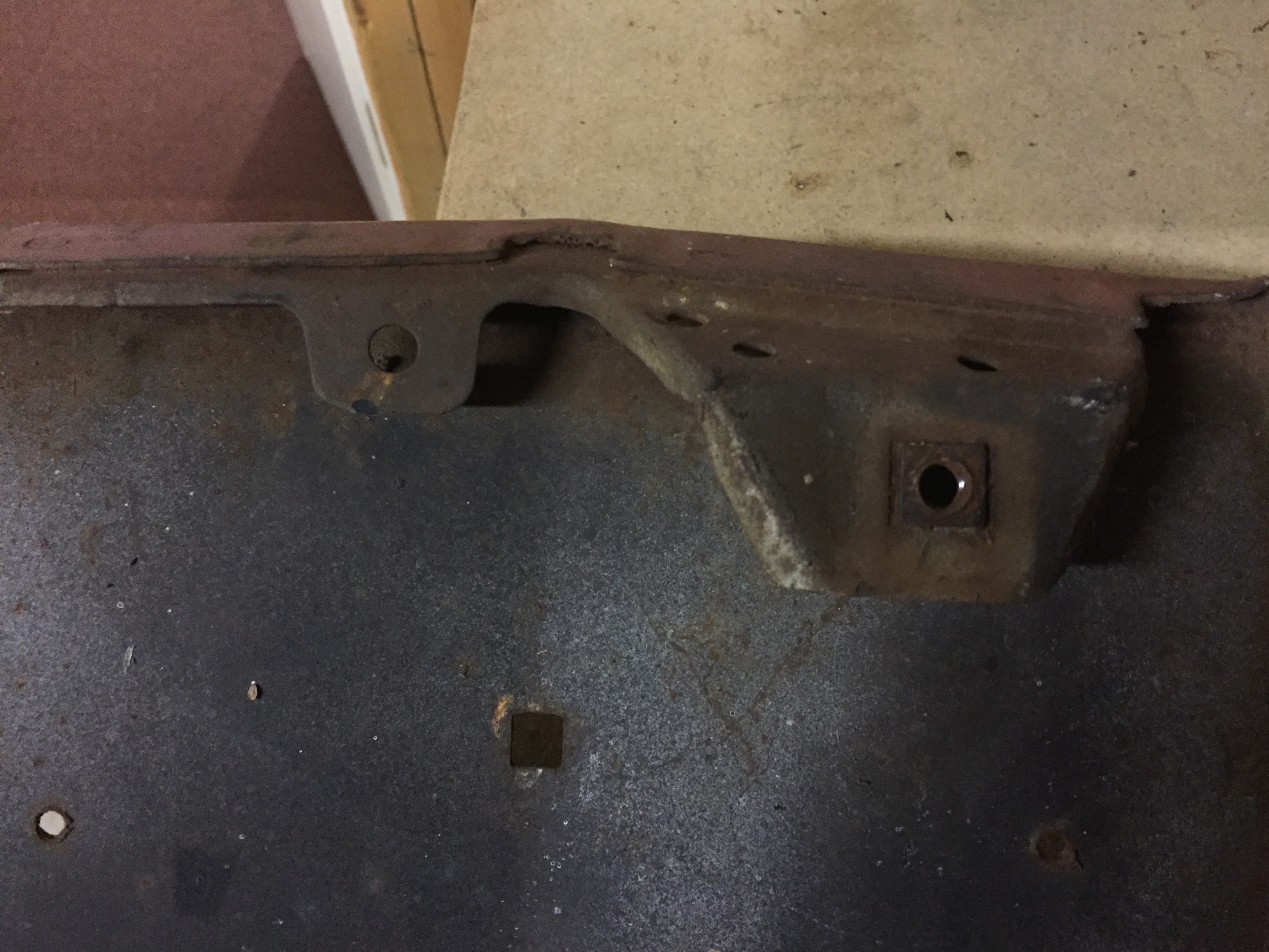

Posted By: HaroldB Re: 67 Front Valance Differences - 02/22/17 12:48 AM
Yes, my extra valance has that bracket.

Posted By: HaroldB Re: 67 Front Valance Differences - 02/22/17 05:17 AM
Originally Posted By D4VE67
I have no idea what, if anything, mounted to that bracket. I have the whole front end off back to the firewall so time will tell..
The hood latch support bolts to it like Jim posted above. You have to have that piece.
