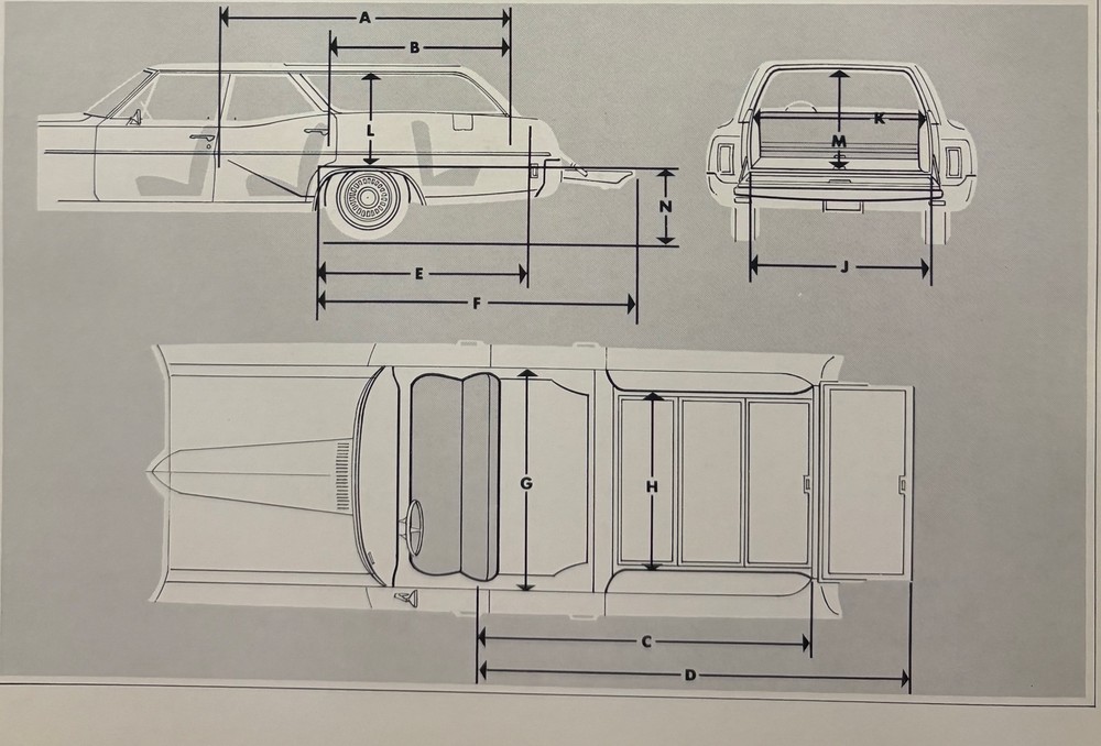

STATION WAGON CARGO DIMENSIONS (l-15)
Catalina |
Executive Safari |
Bonneville |
Cargo Volume (cu. ft.) |
91.7 |
91.7 |
90.8 |
Under-floor Compartment—2-Seat (cu. ft.) |
8.9 |
8.9 |
Under-floor Compartment—3-Seat (cu. ft.) |
4.2 |
4.2 |
3.9 |
Length (inches) |
A. Cargo—Horizontal distance from top rear of front seat-back to inside of tailgate at belt |
84.5 |
84.5 |
84.5 |
B. Cargo—Horizontal distance from top rear of second seat-back to inside of tailgate at belt |
49.7 |
49.7 |
49.7 |
C. Floor length from back of front seat at floor level to inside of closed tailgate |
93.7 |
93.7 |
93.5 |
D. Floor length from back of front seat at floor level to end of open tailgate |
121.6 |
121.6 |
121.4 |
E. Floor length from back of second seat at floor level to inside of closed tailgate |
60.7 |
60.7 |
60.2 |
F. Floor length from back of second seat at floor level to end of open tailgate |
88.6 |
86.6 |
88.2 |
Width (inches) |
G. Maximum width of cargo space at floor level ahead of wheel housing |
63.2 |
63.2 |
63.1 |
H. Minimum distance between wheel houses at floor level |
48.9 |
48.9 |
48.9 |
J. Rear-end opening width at floor |
52.3 |
52.3 |
52.3 |
K. Rear-end opening width at belt |
52.4 |
52.4 |
52.4 |
Height (inches) |
L. Maximum height—floor covering to headlining at centerline of rear axle |
30.6 |
30.6 |
30.3 |
M. Maximum height of rear opening—tailgate open |
28.7 |
28.7 |
28.4 |
N. Platform height of load floor—curb weight |
25.6 |
25.6 |
25.9 |
