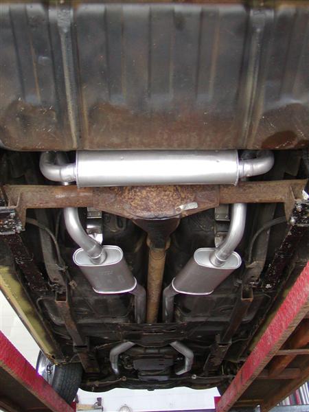

Hey guys, I need to ask a couple of questions about my new exhaust. I guess my car never had the convertible middle brace on it, I always thought people were talking about that brace that goes over the end of the transmission.
My new exhaust has already been installed, and from the pictures can anyone tell that if I ordered a brace it will actually fit on here? over the X part of the new exhaust? my thoughts are that it would not.
The guys that I had install it, said it was not easy and someone that could not cut pipe and weld would have had major issues.
Also I told the guys to cut the ends coming out the back over the rear axle off short and add chrome turndown tips out the back, I am almost wishing I would have just left the full 2.5" pipe out the back with them bare maybe, what is mosts peoples preference? I am just not sure.
It doesn't look like the brace will fit. The best way to have your exhaust done is by having the cross brace installed and have the shop fab the exhaust.
As for the tips I have mine turned down at about 45 degrees just past the rear tires. Hope this helps.
Hmm those are the exhaust set fram RARE, not sure why they did not fit better, I know most of you are more for getting the exhaust localy custom done, but really thought these would still fit better, either that or something was installed wrong?

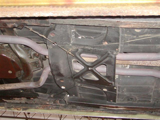

BTW thanks for those pictures Vikki, I printed them out, going to take them in to the shop, cause no one understood what I was trying to say. 1 pictures worth 1000 words!
Vikki, is that one of your cars? Wow, that looks like a nice clean install!
Yes, that's my yellow 'bird. It took about 5 hours to get that fit, but the shop wasn't going to call it done until it looked just right. They even ovalled the tailpipes as the originals.
It will not. It's way too low.

What are the raised casting #'s on the center exhaust ports just above exh mans? If you want extra clamp load for your exh manifolds, Spotts Performance has brackets that bolt to front and back of the heads and over the ends of the mans.
And if you want to use the convert brace, find or make spacers to put between it and the body. Think "Pypes Performance Exhuast" makes a kit.
That would bring the X brace pretty close to the ground with all that pipe sitting under the belly. And it's pretty close to the "041" cam profile too. Seemingly a lot of cam for a 350 auto. Let us know how it goes.
