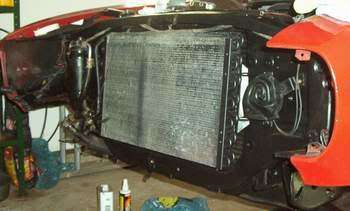

My buddy took 3 69 firebirds apart plus some other Pontiacs. Put all the horns in one box. So Im looking for a pic of the High Low Horns for my 68. Part #s if you have also. Maybe a pic where they bolt at? Thanks in advance. Never have had horns on my car. Always just yelled get outta the way.
One horn bolts to the center hood latch support. About midway down there's a bolt hole that goes through an angle stamped in the support. I don't know where the second one mounts but I'm looking to add a second to my car.
I don't know if 67 is the same but mine had one bolted to the right side of the hood latch bracket and one bolted to the front of the rad. core support just below where the voltage regulator is on the other side of the support. I don't know if that is more confusing than helpful but that's where mine are at. EB Texas
I do have a extra 67 400 coupe rad support that still has the horn in the position that I mentioned. I am putting my 67 back together now so I will take a picture and send it to you. It will show pretty good the position I said it was in. I have never put a picture on this site so I may need to just email it to you if that is OK with you. I will try to get the picture on Friday. EB
Tom, What markings are you looking for. Mine say "H" in a circle and the below that Delco Remy. Is there something else on the horn you are looking for? EB
I believe that's it. Is that the horn on the driver's side? My horn is in the center and marked with an "L"

Well, I see you got pics. I have more if you need them just don't know how to put them on here. Let me know if you want them or if you have what you needed that's OK too. EB
EB, if you have pics , you can go to "file manager" below the reply box after you hit reply.....it will then browse to your pics , then you upload (max 5 per reply box)
Hope this helps...
