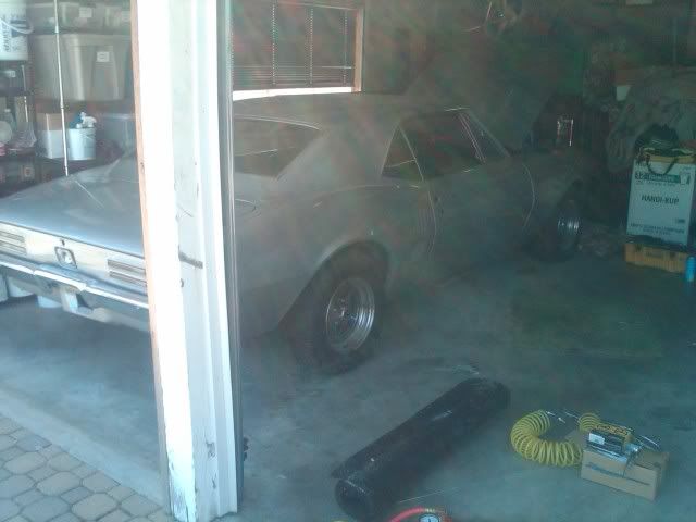

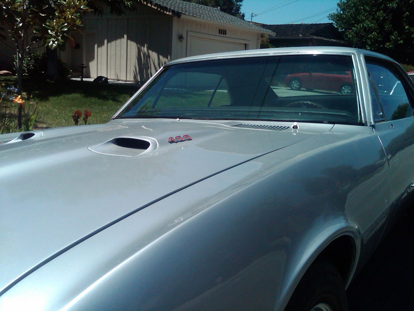

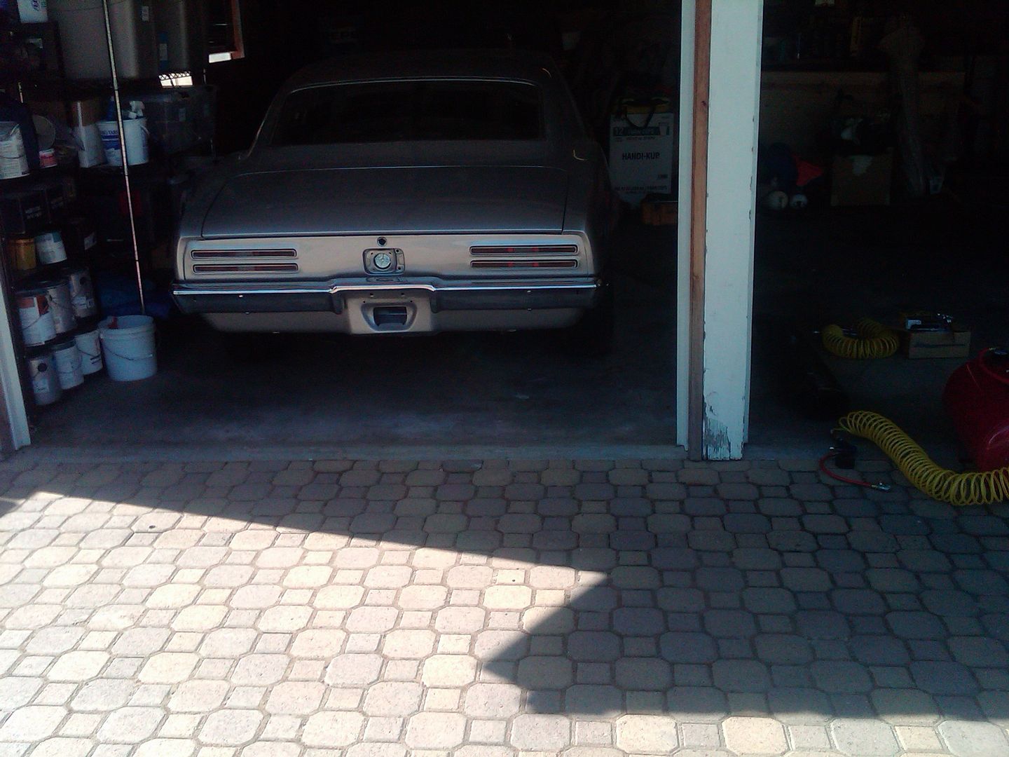

Yay! So picked up a sleeping beauty! This bird has been hibernating on and off for the past 10 years. A lot of resto had already started, body in extra clean shape, no rust, interior almost completely redone. It is an original 400 with a column shifter 400, pretty sweet!

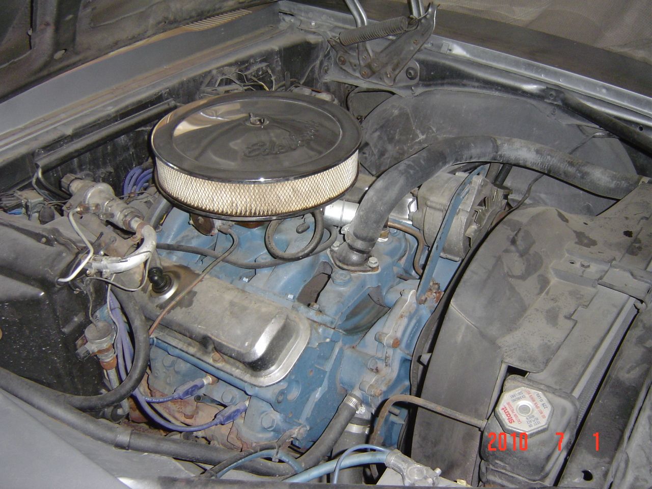

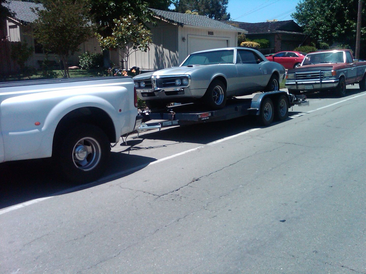

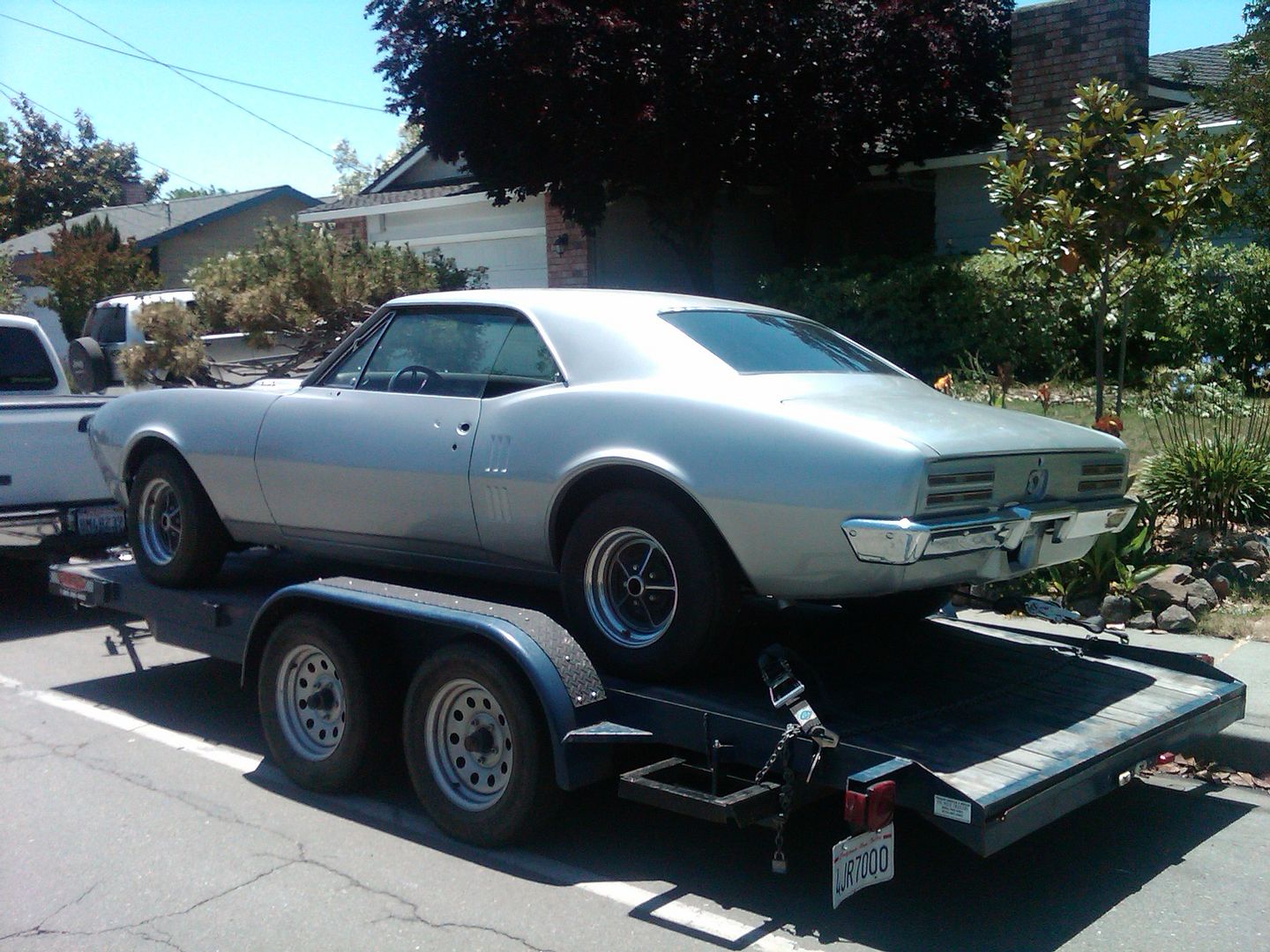

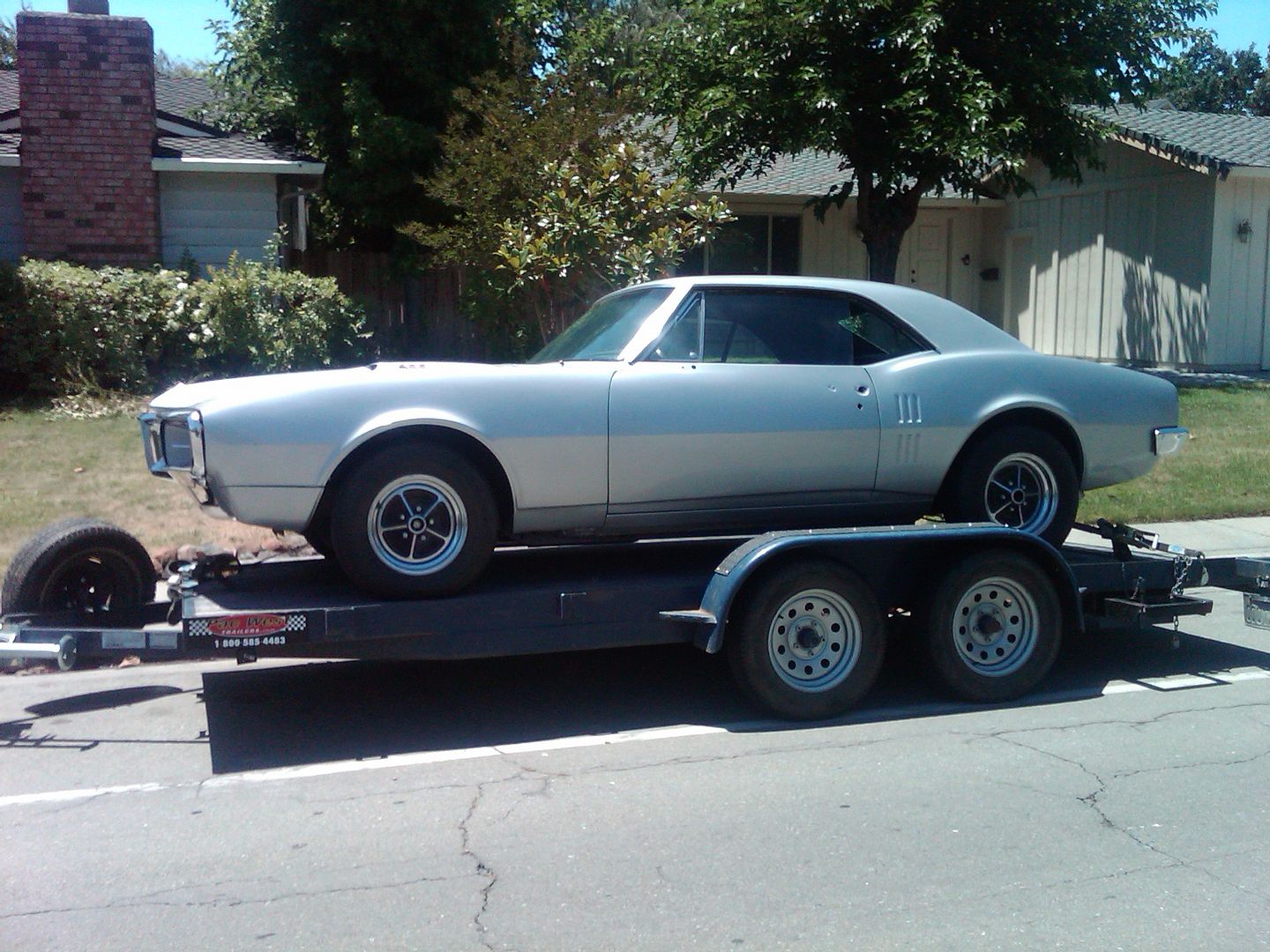

It took a bit of time, but was able to make her run and go on the trailer on her own. Popped spark plugs, poured some PB blaster and oil on the cylinders, plugged a new Battery (Optima), some starter fluid, and after a couple tries on she went
She is running VERY rich! At a minimum, I need to check and clean the carb, need new spark plugs, remove old gas (thankfully the tank only has about a 1/4). Planning to redo all fluids, any other recommendations?
I appreciate all help and tips as I am not a total car newbie, but am a Bird newbie (I like working and building Jeeps for rockcrawling), and this forum has a lot of great info and knowledgeable people. Forgive me if my questions are too newbie, but I gotta learn somehow

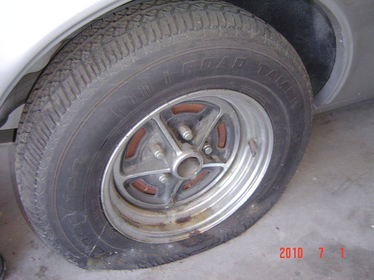

The tires are shot, how often do you have to almost scrape the tires from the floor to move the rig? I brought a tank and popped some air in so they are decent rollers. I was afraid they would just blow up through the cracks!!
I got a few boxes of parts, trim items, etc. Need to go through them and see what is missing.
Plans for the Bird is to make it a driver and work slowly on the other body and other cosmetic stuff.

1- Need to get new tires, what size can I fit without major issues on a first Gen Bird? I bought for some extra $$ a set of original American racing wheels from the seller. They are 14’s, seem to be mag or alum, very light. I am not 100% sure on the actual rim width, the fornts are narrower than the rears. Measuring between inner lips the fronts are about 6”and the rears are about 8”. What size tires can I fit on those that will work on the Bord? Any tire recommendations? Want good tires, but also keep the retro look, BFG T\A’s? Cooper tires? the seller mentioned I will need to run some spacers to clear the rera wheels (he included with the wheels) The wheels I got look identical to these, any leads on where can I find the center caps? (I love the stance on this Bird)
2- Retro audio. Thankfully the dash is original and has the original stereo cut-out. I saw a few retro audios online, any recommendations? I do not want to spend $600 on a stereo, Was shooting for something like this. Any other ones that will give the retro look and are in the $200 or so ballpark? 3- Where can I find the rubber for the front nose\bumper (between fenders\valance and front chromo bumper? 4- Vendors you recommend out there that will carry the misc stuff? I.e. I have some of the cranks for the windows, but they look like missing the small rotating knobs 5- Tacho and Rear spoiler? I believe the 400 67 came with the rear spoiler? It has the 400 hood, but no hood tachometer. 6- Suspension. I am thinking lowering the suspension all around some, maybe look into hotchkis? Do I need to replace the torsion\sway bar on the front as well, or the stock will suffice?
I see you have the Bjorn / Buick rim details going...
1. Do a search about tires, there have been endless threads about this. 2. Ditto 3. Used, here or Epay. I don't think there is a repop of these. 4. Ames, Classic, NPD, some others. Classic has rediculous shipping prices, but they are in CA, so maybe not so bad for you. Try classicindustries.com. 5. Hood tachs were an option, not stock for the 400 model. These can be found used, or repop. Rear spoilers are for Camaro's, not Firebirds. (ditto for front spoiler) 6. Many options out there. Most through Epay or repro houses. Stock front sway bars seem small, but overall stock suspension leaves a lot to be desired anyway.

2- Also when the car starts, the infamous “GEN” light on the dash lights up, what is that?
Your alternator is probably discharging. Have it rebuilt (do not exchange it).

Thank you! And regarding your gen light issue, it may be a sticky regulator. My '67's gen light comes on from time to time, sometimes goes off by itself, sometimes stays on for many days. I've had the entire charging system checked, and everything seems to be fine. The regulator was brand new from Ames, and I called them about it. But their take was that it (the regulator) was an electric part, so I was SOL. (never got around to complaining on this site about that one). Anyhow, whenever it stays on for more than one drive, I give it a rap with a screw-driver, and it seems good to go for another month or so. this has been going on for two summers now. I'm just lazy about replacing it.
So that possibly could be the issue with yours. Try a couple of good raps with a screw-driver handle and see what that does.

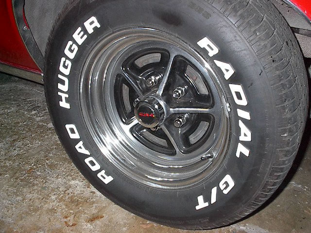

I like the rims! lol...I have 235/60/14 BFGs on mine now as I couldnt get the 245/60/14 Road Huggers anymore, you can add PMD centercaps to these...check my picture
the missing center part buy from Ames...you can get dipstick from Ames too... http://www.amesperf.com/ ....it doesnt need a hood tach unless you want one...betcha Ames has one too!

thanks, I will check on the regulator, that is what I think could be the issue or another ground, etc as the rig was probably taken apart for paint. Ah all teh fun gremlins to get started on can not wait
Thanks, the tank looks surprisingly clean and solid form the outside. I am hoping to avoid dropping the tank, but does not look too bad with the small amount of gas. I will try syphoning some of the gas out and bypassing the lines with another electrical pump. Getting the residues without getting the tank out will be a PITA, but only way to tell.. you guessed have to drop the tank
She is running VERY rich, any tips or suggestions on what to get started? I am going to replace all
As far as gas what do you guys recommend octane and brand wise 91-92, and any brand works better than other, Chevron, etc?

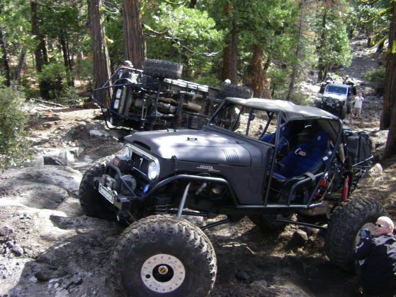

Bjorn very very cool! My wife is from Sweden (Boras\Gotteborg area), were in Sweden are you from?
We should be heading to Sweden sometime in the next couple months Loved wheeling in Sweden with Volvos!
The pic of the buggy is at Fordyce Creek, really nice trail not too far from the Bay Area. I am in the Dubllin\Pleasanton area.

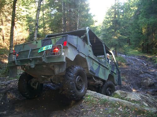

I`m from Stockholm, my buddy here is from Gothenburg though...also had friends in Borås, they moved 3 yrs ago to Gränna
here`s another Volvo I had before , it was no 60 of 90 prototypes built for the Laplander..it came with a B16 , 65 Hp, single down draft carb., but I replaced it with a 1972 Volvo B18 engine, 115 hp with 2 carbs...as you can tell I once rode dirt too...
