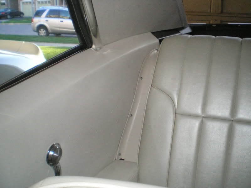

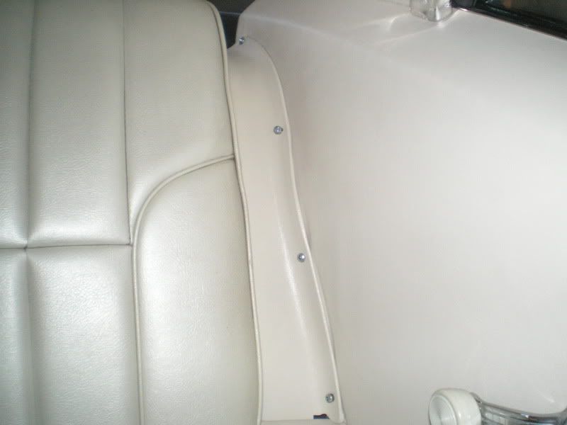

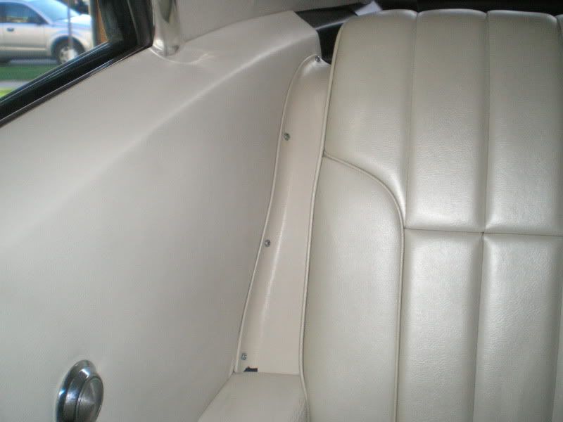

Sorry for the delay, here are those pics. The picture of the piece on the RH side of the car looks a bit off in colour. The first pic of the LH side piece is the actual colour (must have been the flash or something that made the RH piece look off):

Thanks. Those pieces just look funny to me. Like they were an afterthought or something. My wife didn't think I had them installed correctly because you can see the screws!
It is correct, and the colors never matched perfect when new either!
