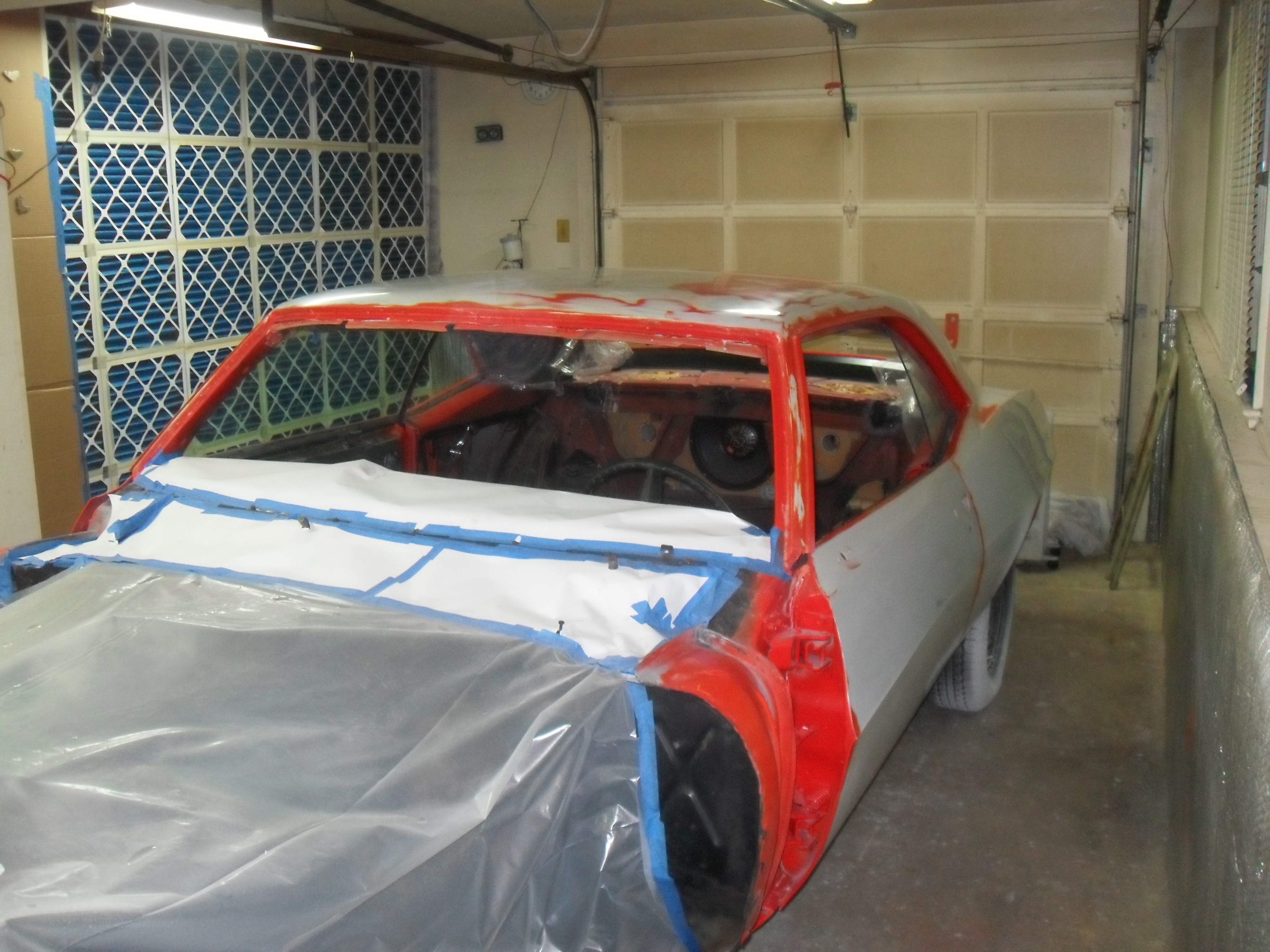

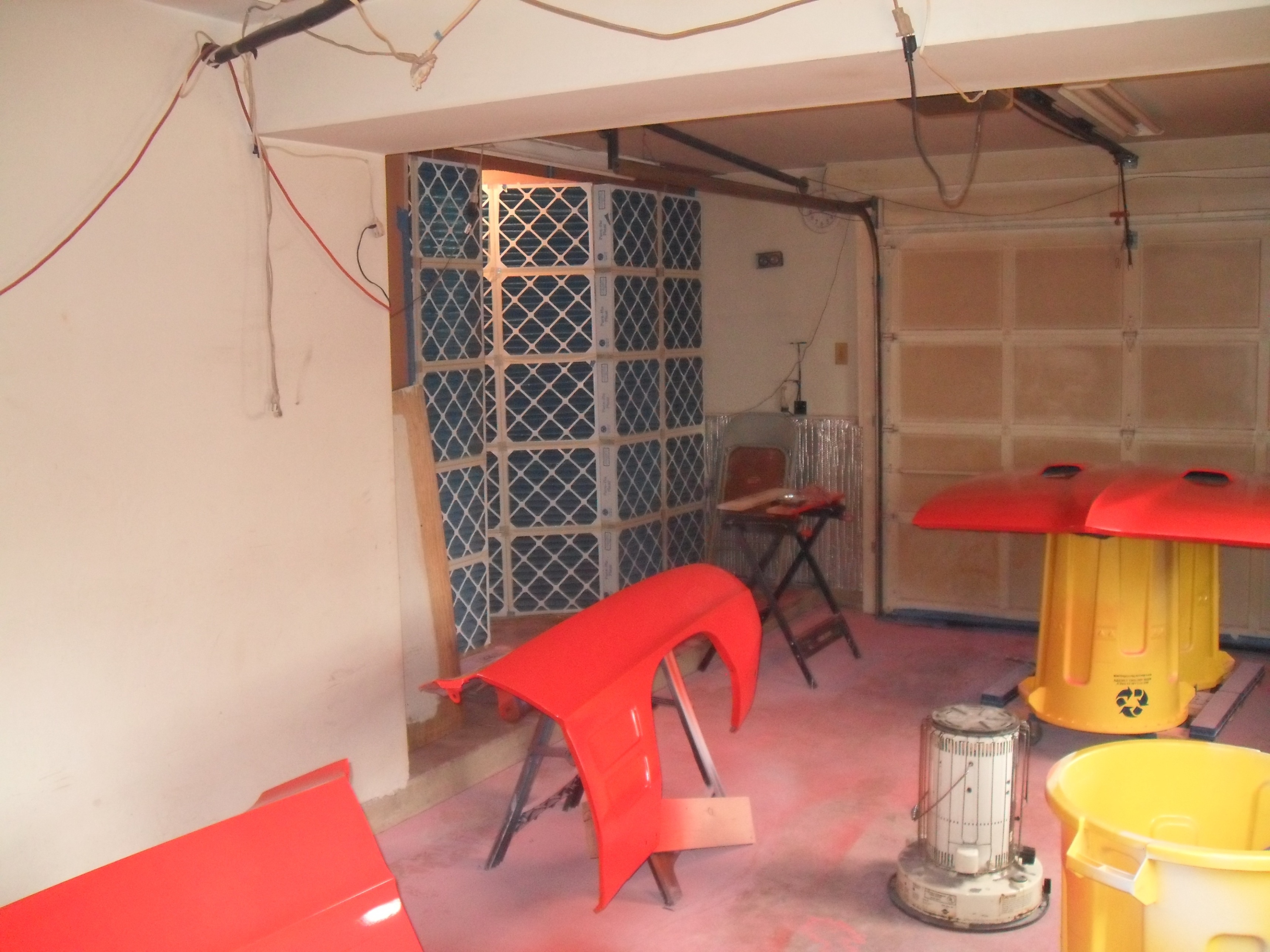

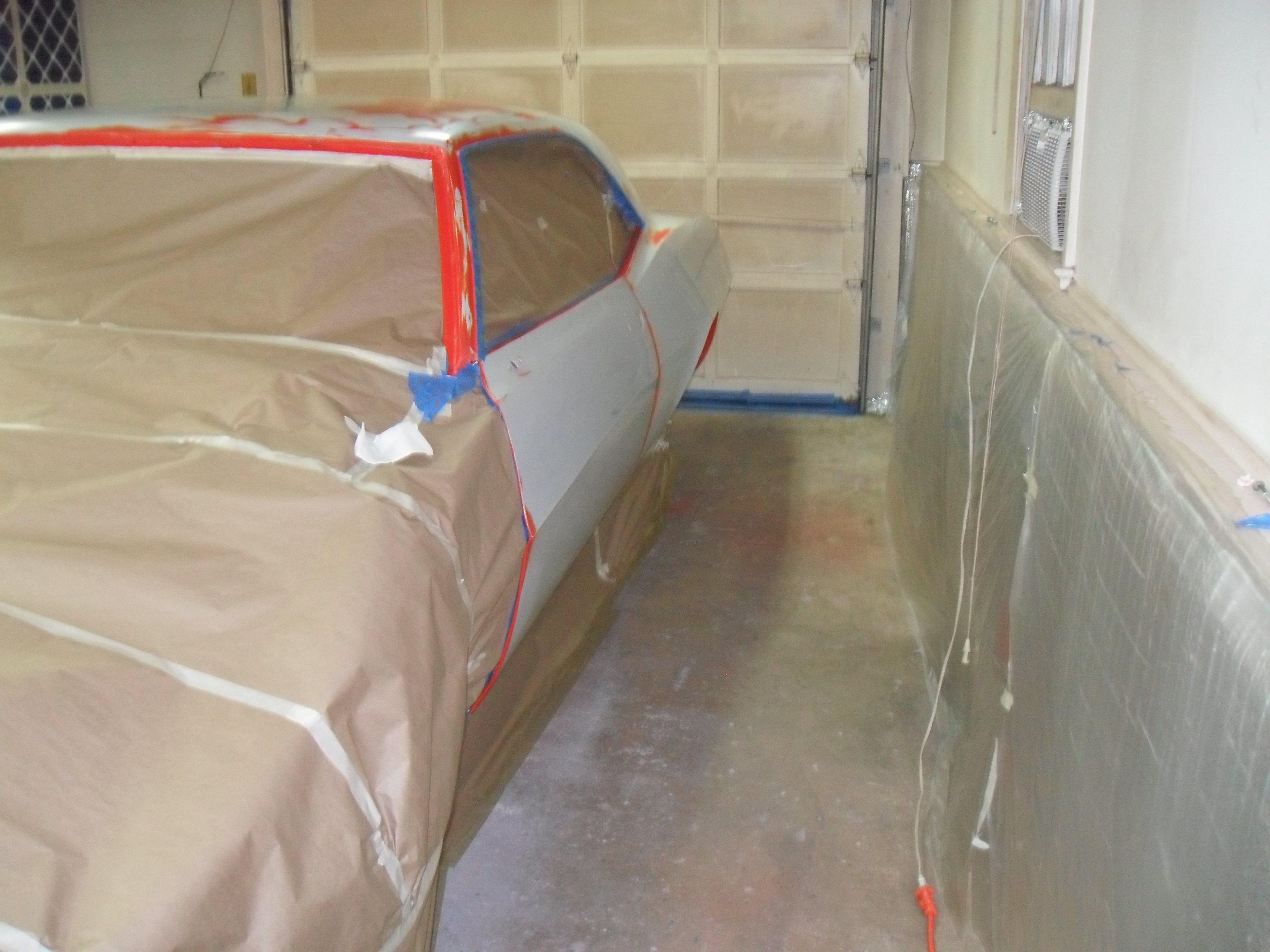

TY. I painted it in my garage. $300 for paint, and I shot it with a $9.95 harbor freight hvlp using an air line running direct from the compressor, about as ghetto as it gets, minus the spray bombs.

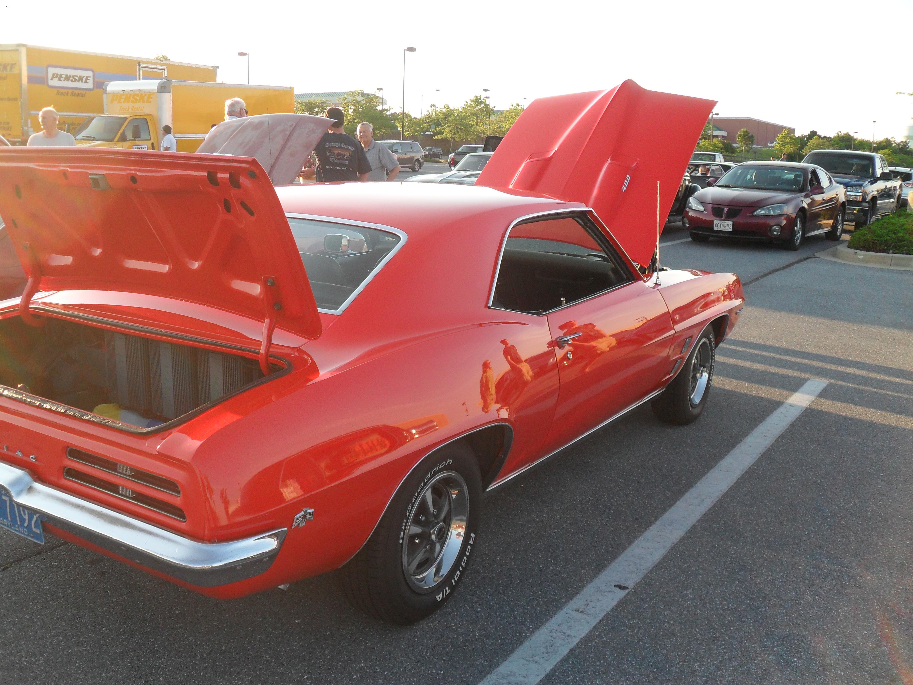

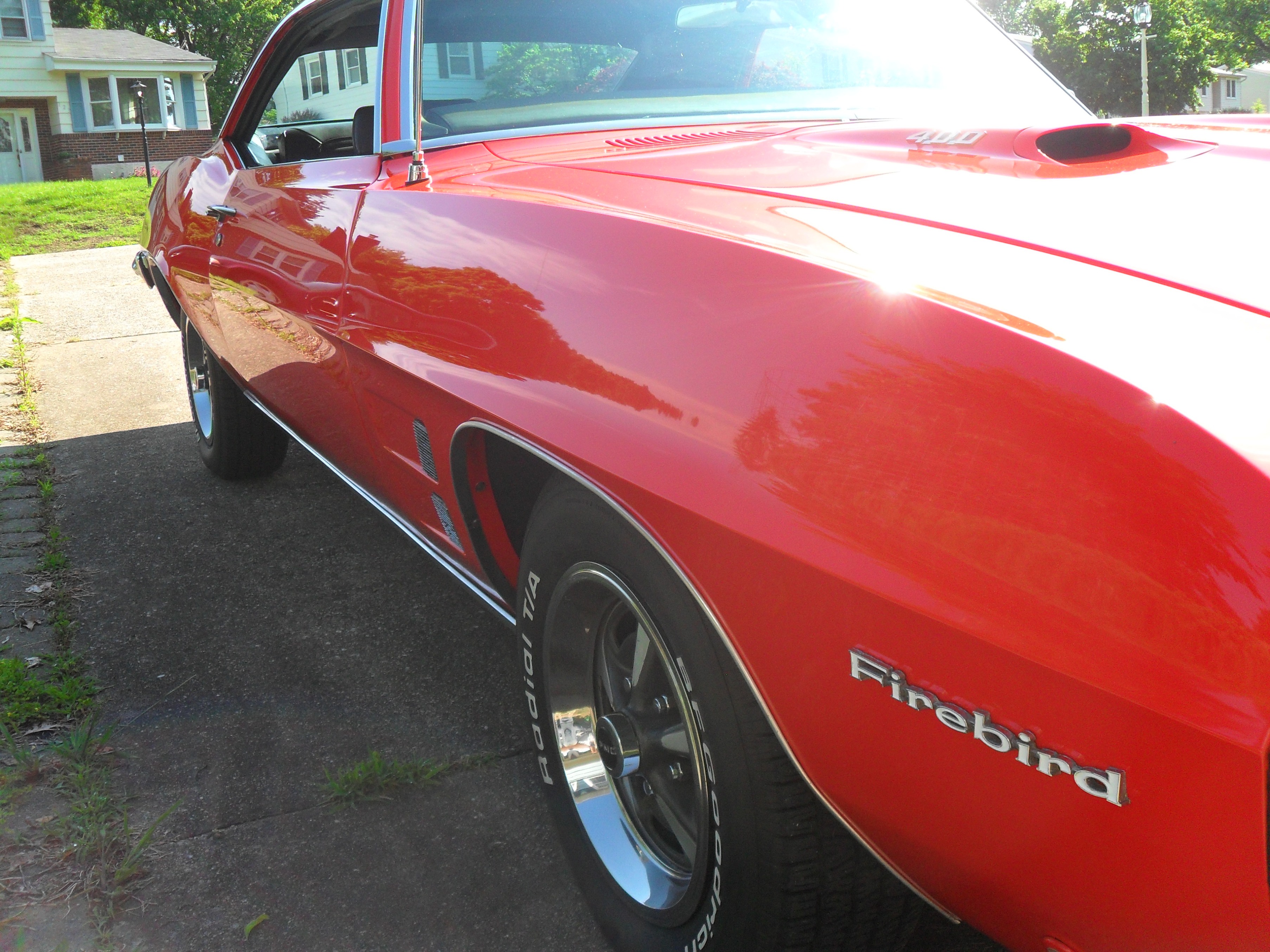

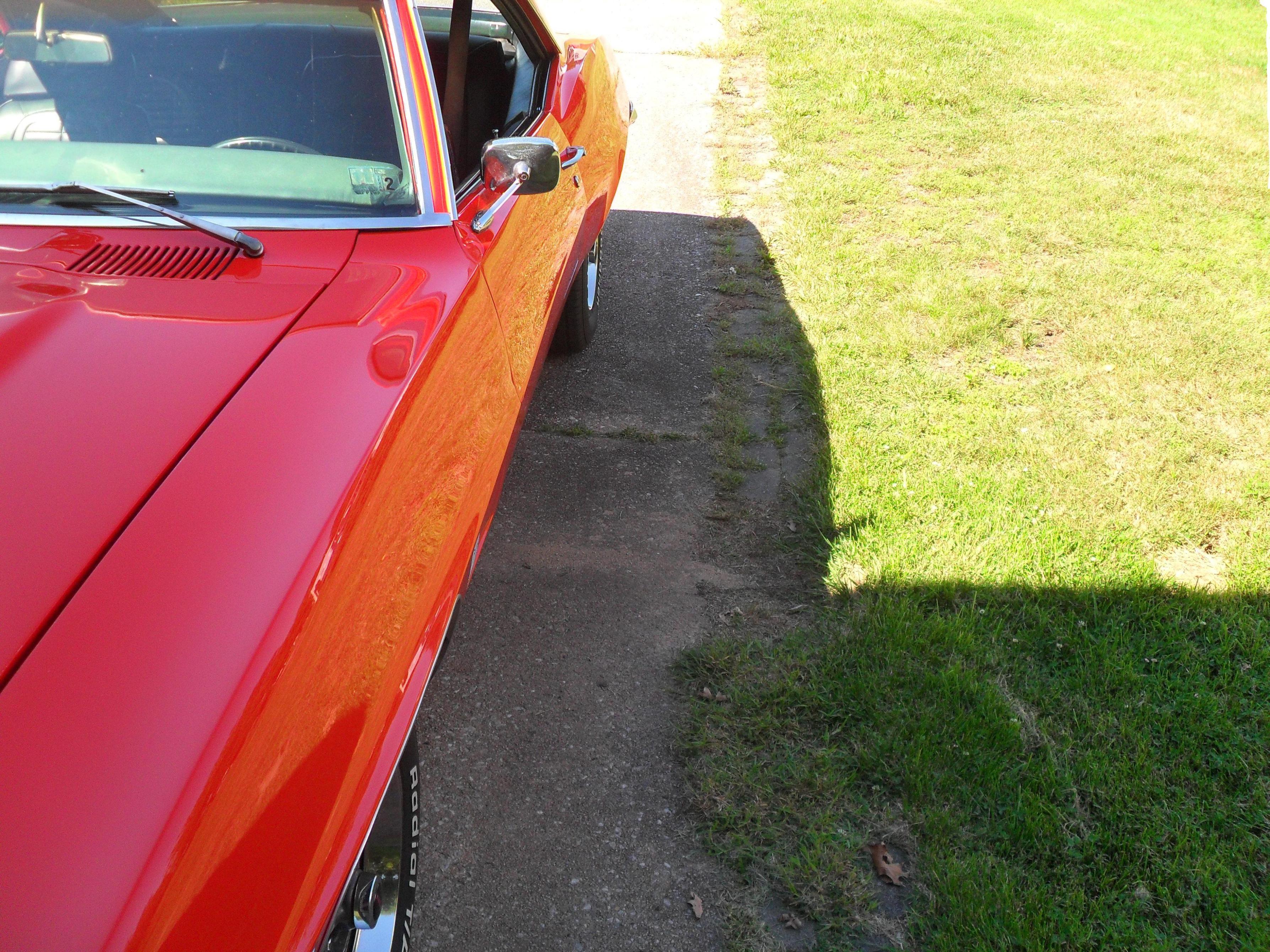

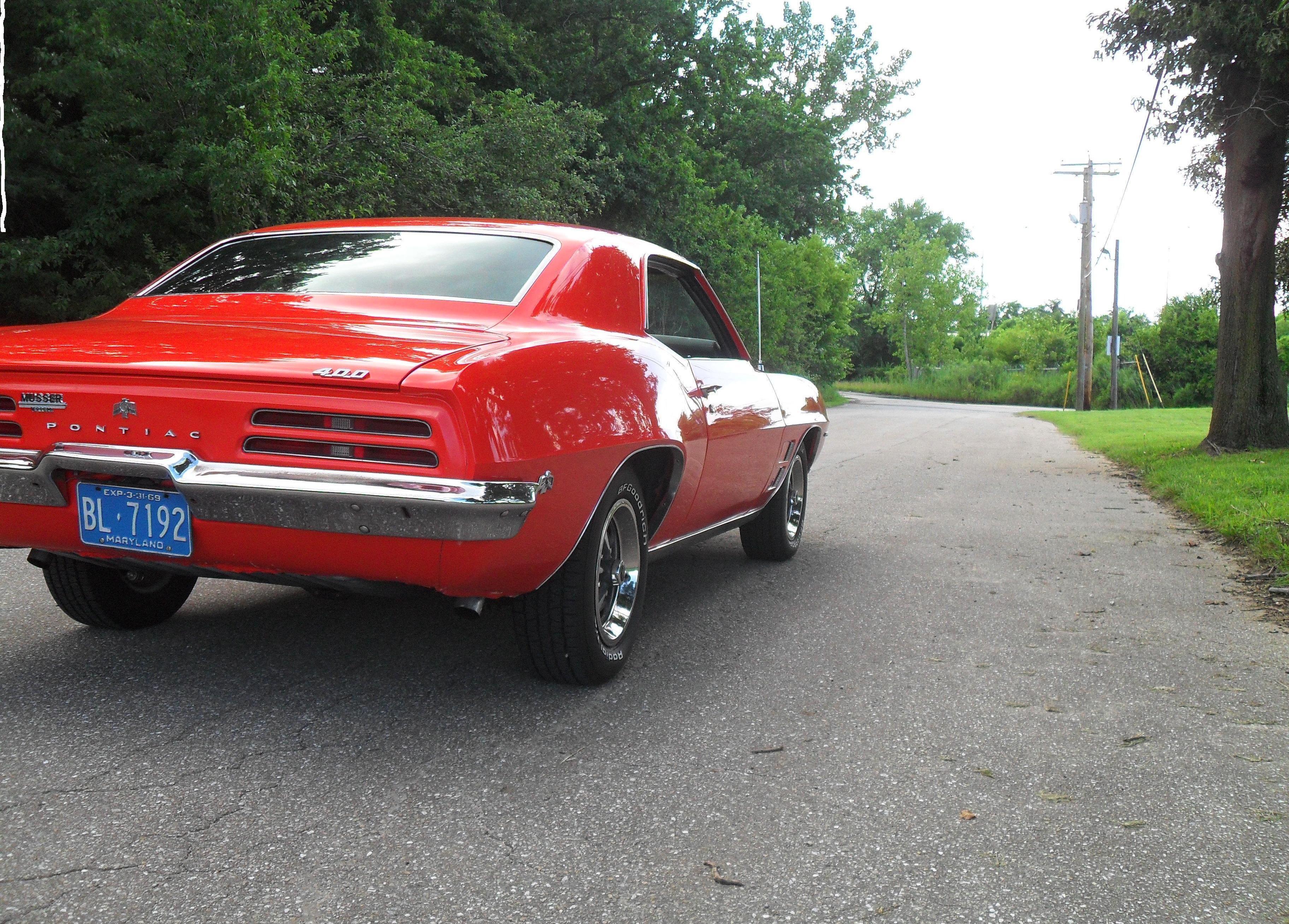

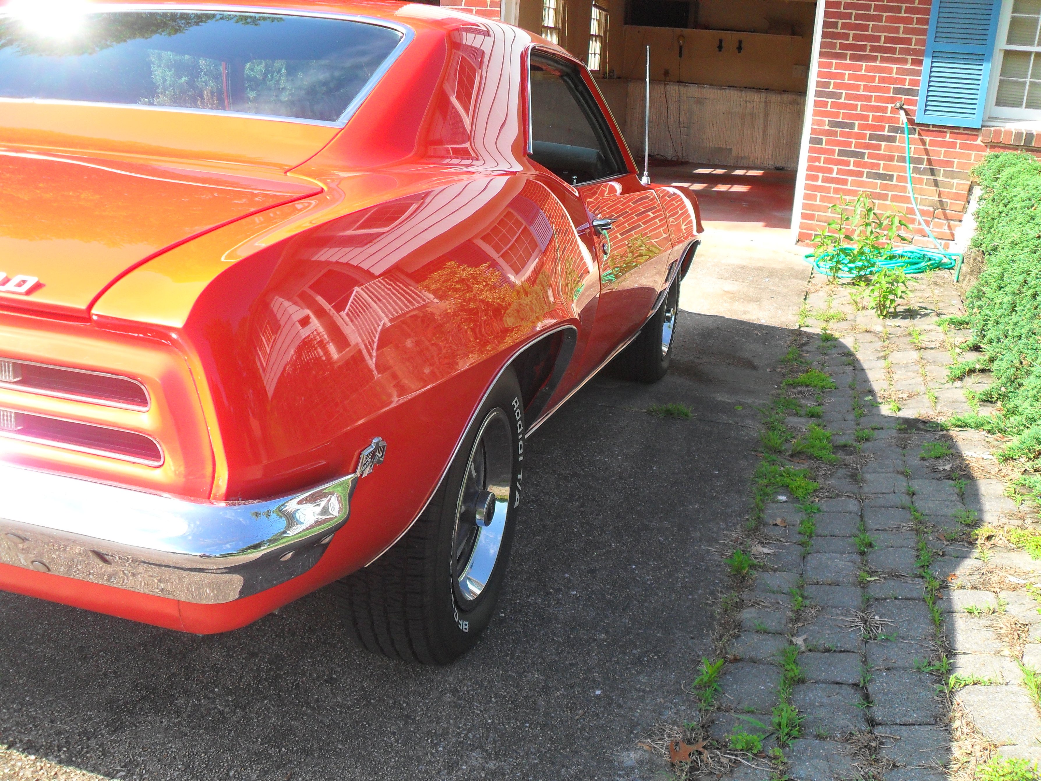

Actually it’s extremely dull, much less shine then what you see on other cars. I just don’t feel like rambling on with a why-it-shines technical explanation. In a nutshell, the surface manipulates the light to create an optical illusion.
As the first week of June was passing, I was beyond sick and tired of working on it, so I roughed it up, burned it a little, called it done, and spent the summer enjoying it.
I picked up where I left off on the second week of December, but I haven’t been relentless at getting it done. I have never pretended to be someone whom I’m not, so I don’t mind saying that I’m in uncharted water at this point.
I know that I can bring it to a higher level than in the pictures. The thing is whether it will be minimal or an explosive before-after. I’ll have to burn it to be positive, but it looks like the difference will be exponential. But there I go thinking again. I’ll post pictures when I’m done because it cannot turn out worse.
