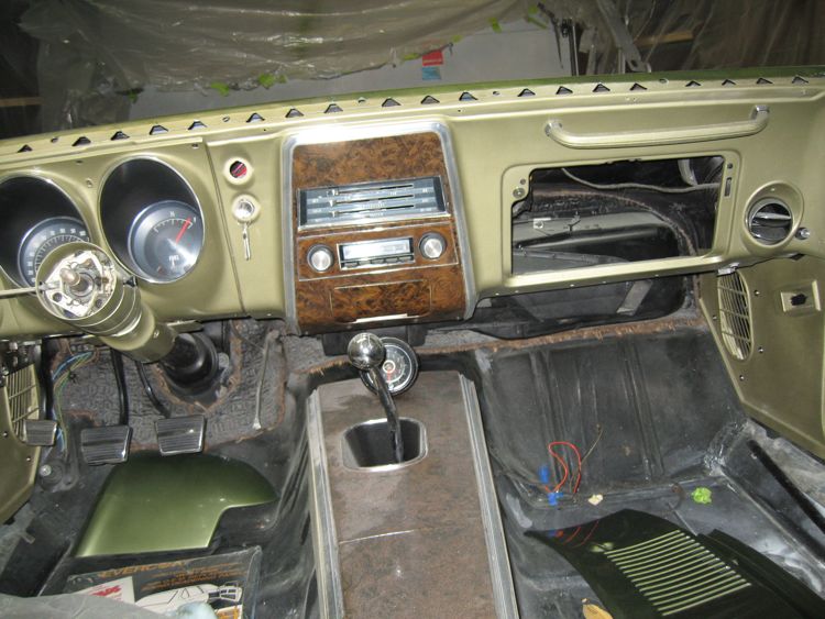

have a part color matched. i think its semi gloss. i painted mine with a base and polished it out so it has the semi gloss color i wanted. it turned out great. here is an old photo
Yes, semigloss. Most of the Pontiac repro parts places sell interior paints that work well. You will be looking for a lacquer for hard surfaces (such as metal) as opposed to the vinyl dyes for soft parts.
