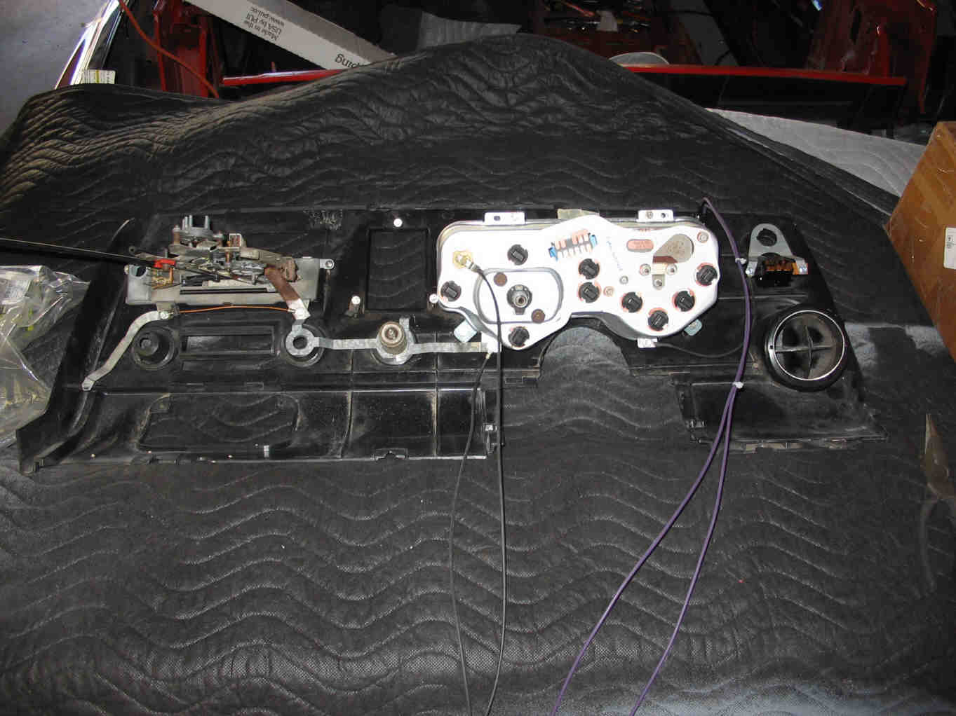

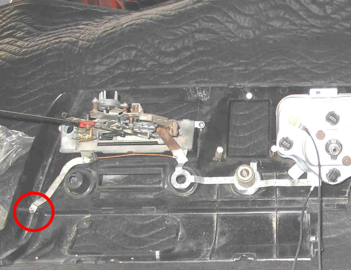

OK, Ill try and do this from memory. To remove the plastic dash panel, there should be 4 screws along the top into the dash pad. Another 3 or 4 screws along the bottom edge. That's the easy part! You also have to get an arm up behind the dash to release the pin on the light switch shaft and remove the shaft. You can then remove the retaining nut on the headlight switch. You will have to release the speedometer cable from the housing and the wiring harness from the instrument cluster to give you enough play to pull everything forward. Here is where you need to have the ashtray out (and the glovebox liner may help too.) Take a look at the first pic, the circled spot shows where a stud comes from the dash panel, goes through the metal dash and has a nut on the inside of the metal dash. This one is a real pain to get to! (There is another mounting higher up, but mine didn't have a stud in it.)The radio wouldn't have to be out, but it would be easier if it was. Either way the knobs and shaft nuts have to come off. There should be enough play in the heater cables to get the dash pulled out and the you can disconnect them. Oh yea, You also have to drop the steering columb or you won't be able to pull the dash far enough toward the seat. Be carefull pulling it out there are several little clips and screws holding wire bundles etc. to the back side of the dash.

One last thing - did you remove the nut on the inside, lower right of the dash bezel? I forgot about this, but got a different bezel myself today and was reminded of this.
