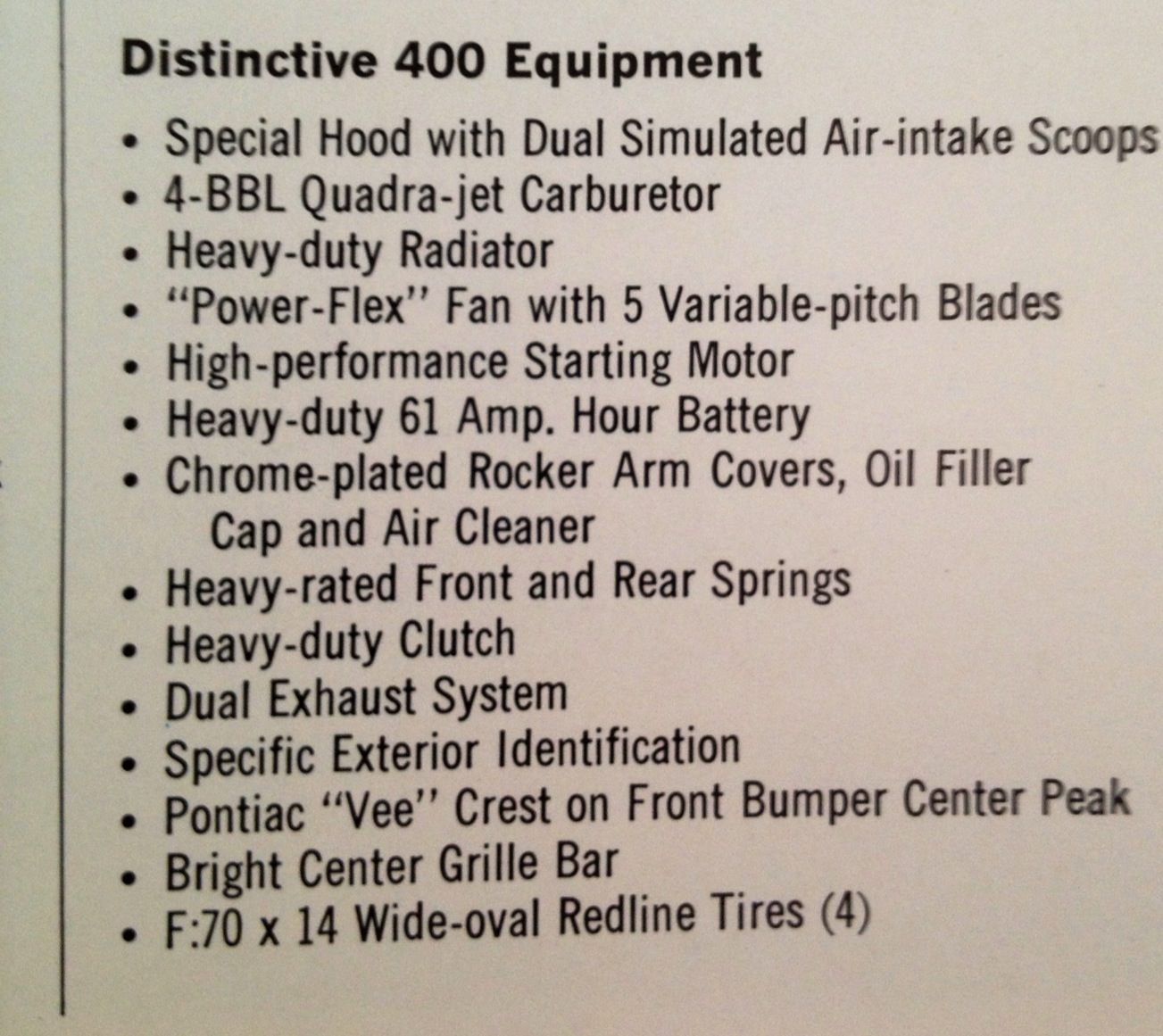

I didn't think the birds came with a flex fan from the factory...thought it was only the 4 blade and then the clutch type???
-Jeff
Here are some pics from the 68 Firebird Sales Album...
Gus68 #269314 05/14/13 02:56 PM
Here are some MORE pics from the 68 Firebird Sales Album...

There were a crapload of fan combinations for these early birds (more than really made any sense). Vikki saved me from throwing away a stock 7 blade flex model for my Sprint because I also originally thought the same thing.

Awesome! Thanks so much Gus68. I guess I better not throw this one out. Pics even show the correct color.

I remember someone on this site about six or seven years back trying to tell me the one on my 400 'vert was not original. Looks identical to the one in Gus's pictures.
