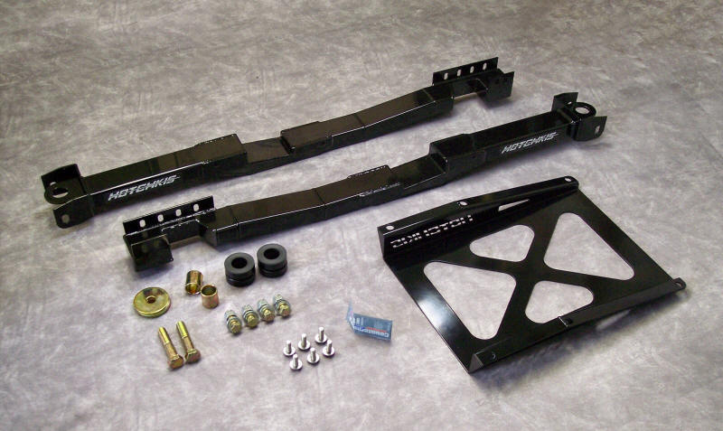

Here is the new Hotchkiss kit with "hi-tech" x brace.

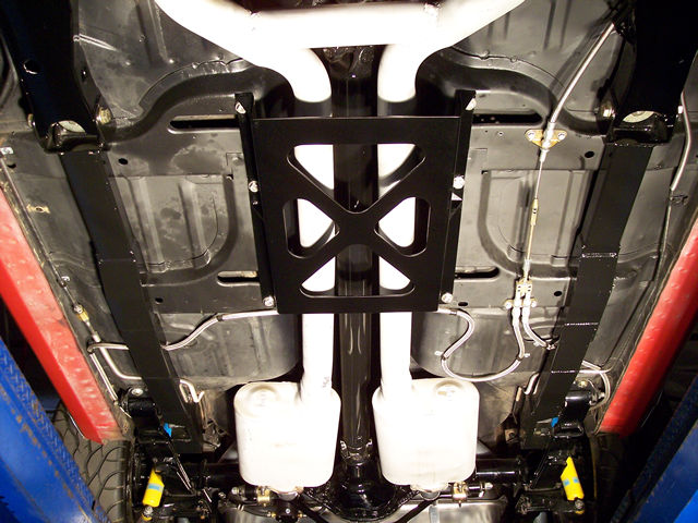

Here's one more from the Hotchkis site. $567 for the kit.
