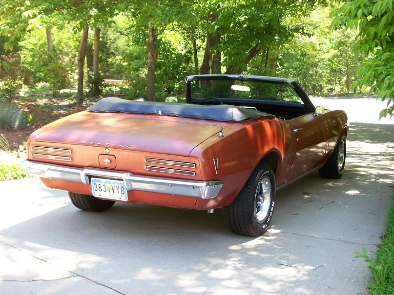

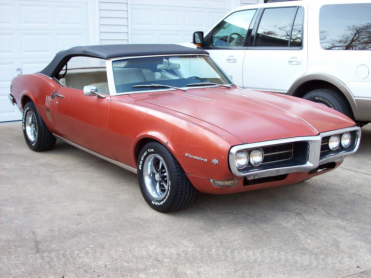

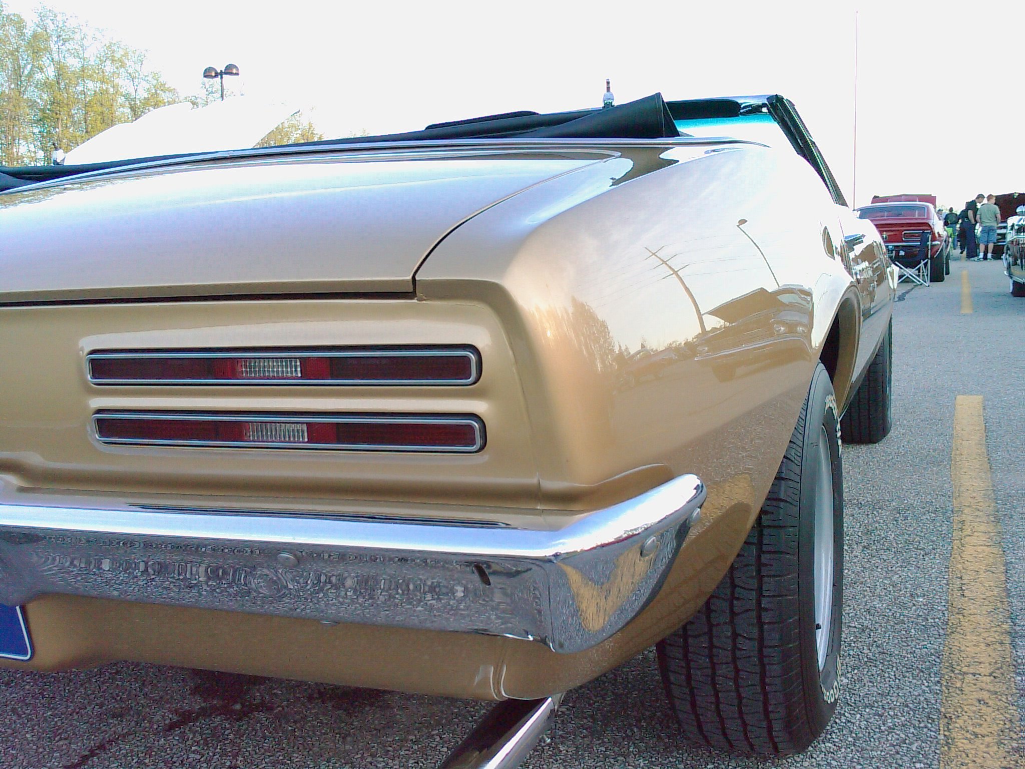

With 14x7's on a '67-8 don't go with to wide or tall of a tire. I get minor rubbing from P235/70R14's on a sharp turn with grade change @ stock hight. But that is the only time I experience rubbing. With the '69's, they have a skosh more room in the tubs, so keep that in mind.

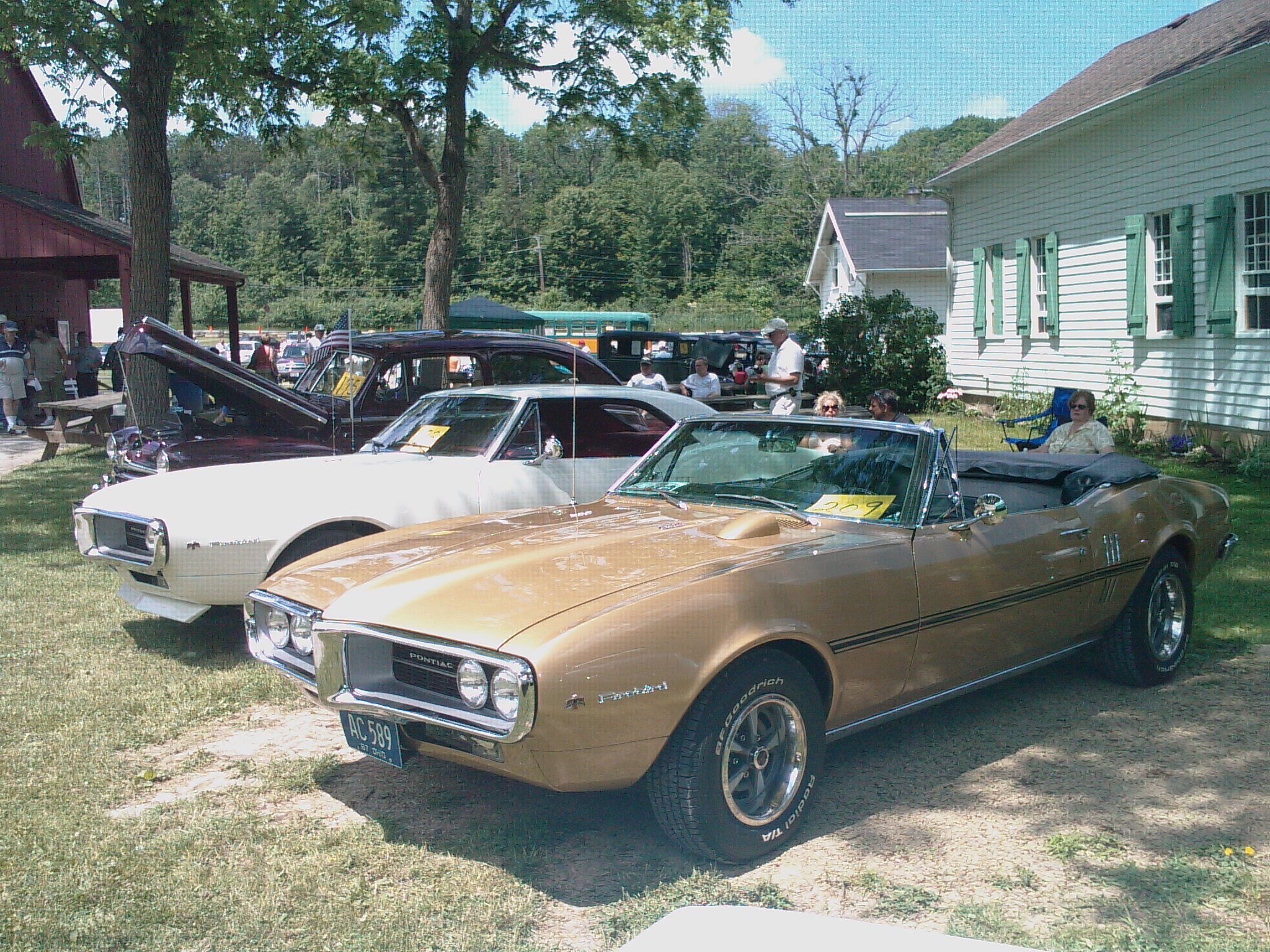

I really appreciate the pictures and size specs guys!
The 215/70 14 BFG's look wider than I thought they would, do you have 7" rally II's? Does a 215/70 appear wider on a 7" rim than a 6" inch rim? Maybe I should go with those or 215/65 x14. If I stay down in the 215/65 x14 to 215/70 14 range I can buy the redline radials, twice the $$ than BFG's but they look cool, what the heck right, I'm already blowing money on new Ralley I rims.
They're 7" with 4" 1/2 back space. The BFG's do seem a bit wider than other 215 I've seen out there. eg. Kelly, Cooper, Goodyear... I don't think there would be much visual difference in size on 6" rim. But the Back spacing may effect the appearance somewhat setting in the wheel wells.
Redlines on Rally I's is a sweet combo especially if you go with the red lugs too.
