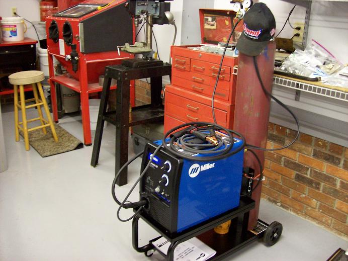

Vikki, I have the 140 Autoset and love it. I bought the gas too and my first job was welding up a cart for all of it. I found mine at the local weld store that had been returned. I paid about $800 for the whole setup. I'm still trying to get the hang of panel repair, but things are looking up. I have 110V 20A circuits as well and have even run it on a 25' cord.
