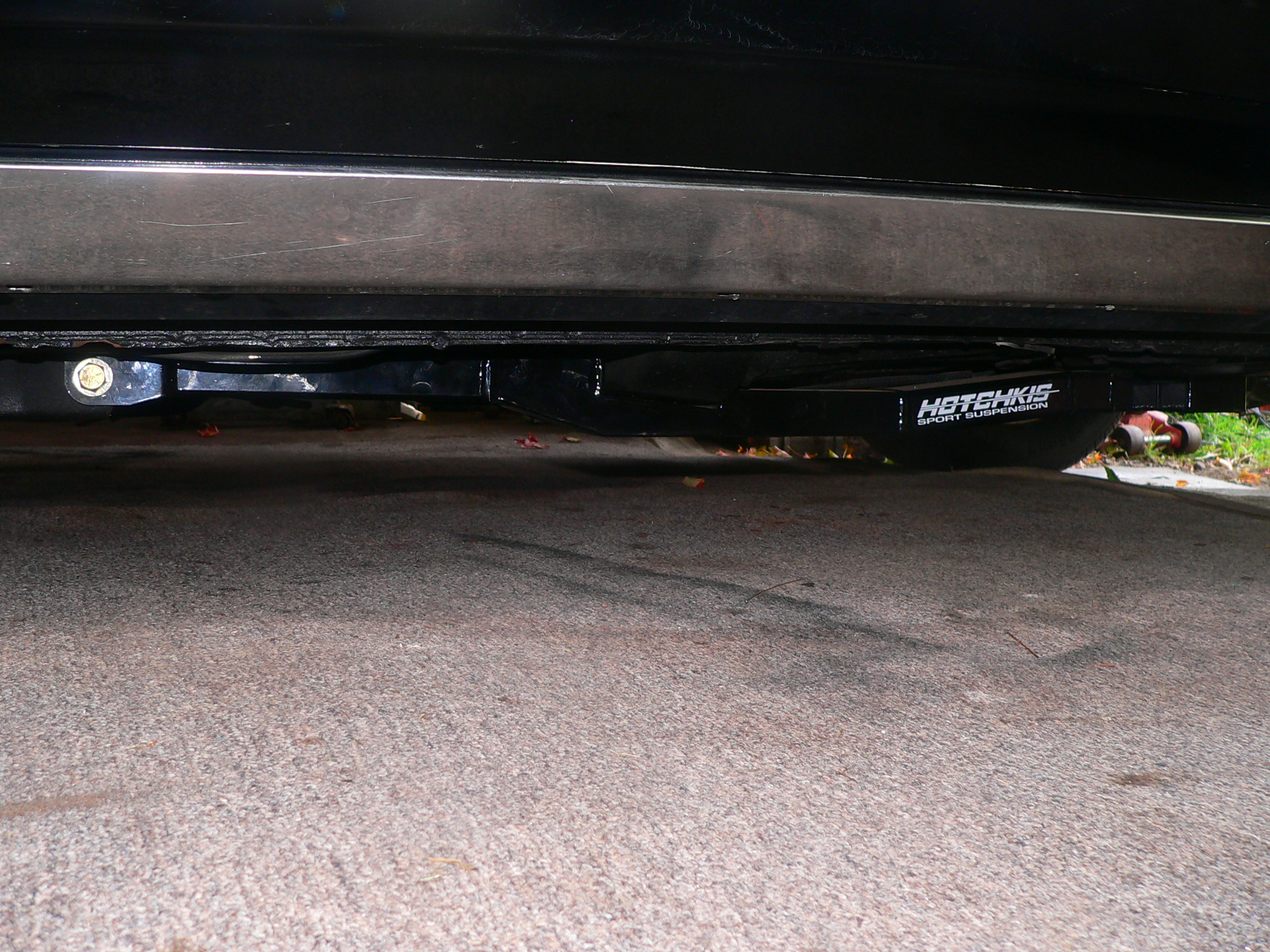

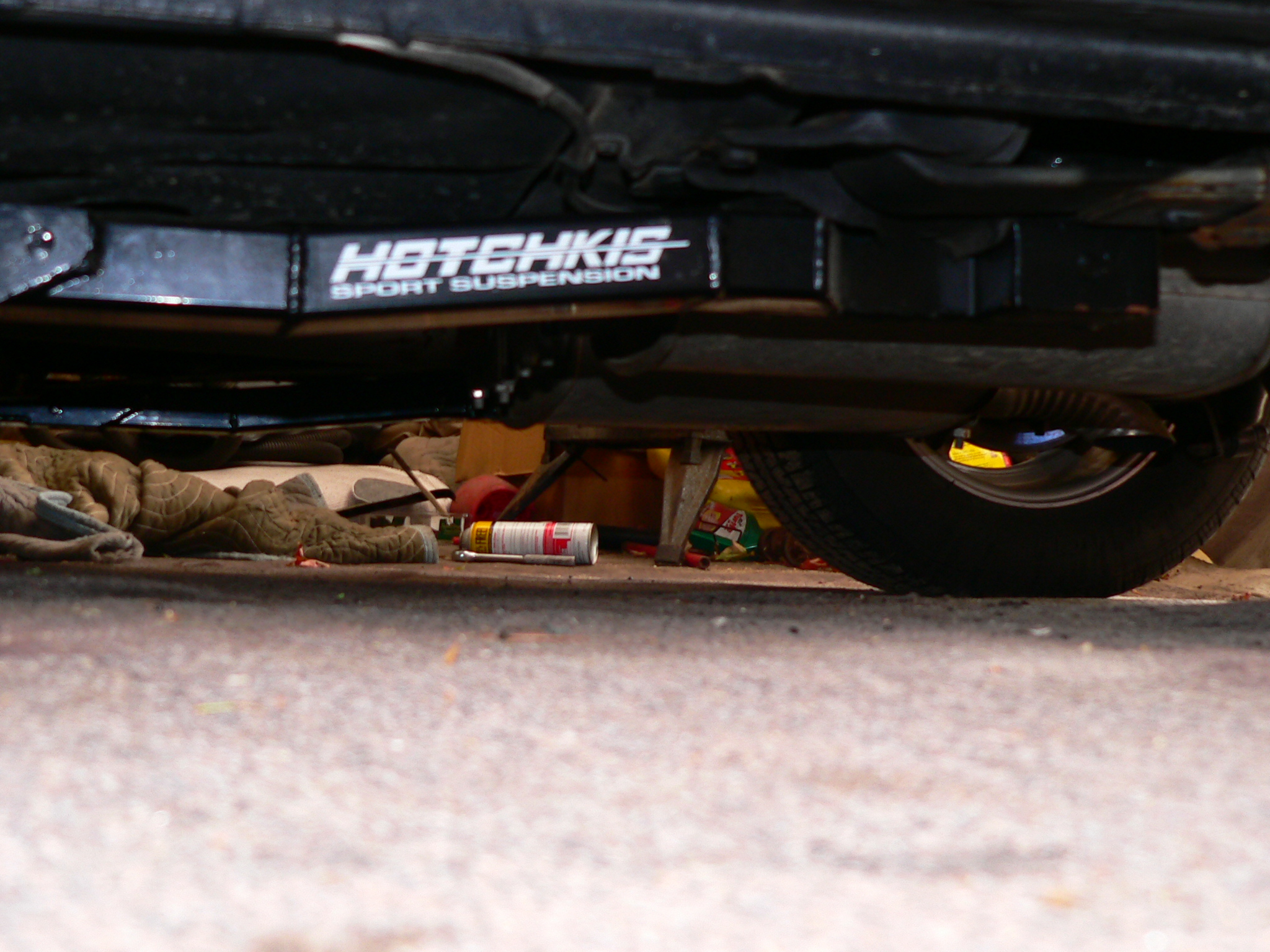

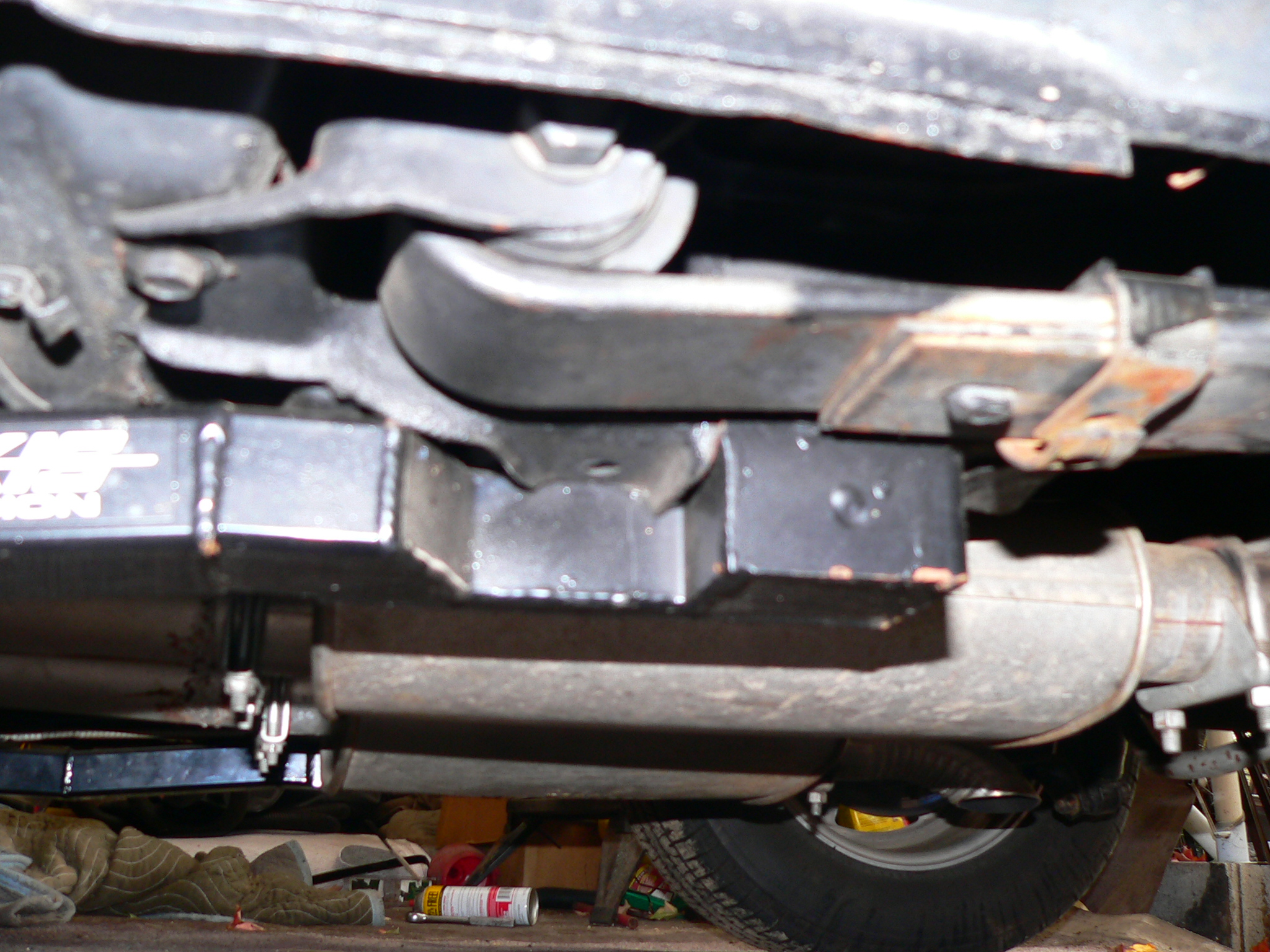

There are several manufactures that now offer FG convertible subframe connectors. Some require modification others don't. Global West 900C or Hotchkis 4008 are the ones I'm considering.
My convert subframe connectors are welded front, rear, and notched and welded to the floor brace. It's exceptionally strong, I can jack it up on one corner and the doors still open and close.
Be sure to change the subframe bushings with a very durable type first, as once you're welded they are in for good. The previous owner of my car missed this step.

I heard the Global West ones were supposed to be good because they don't mount to the rear spring perch which is not very strong, but to some other part. Anyone that can confirm this, and where do the Hotchkis mount to?
