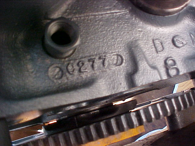

I don't think any or not many 67s have vin# on block. the block casting # is on rear of passenger side head. the date code is by distributor. Did the data plate have 3F on it?
I have a June '67 built Firebird and there is no VIN on the original block.
HOWEVER, there is a motor unit number stamped on the block that matches the one listed in my PHS documents. That's about as "numbers matching" as you are going to get along with the right casting numbers and dates.

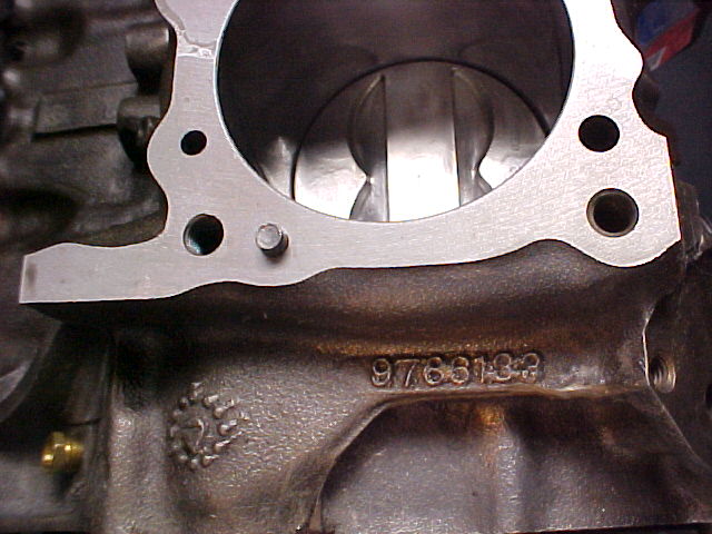

Also, real early 67 400's (cast late 66 and maybe early 67) have the 8786133 next to the distributor with the oil plug going through the middle of the number.
