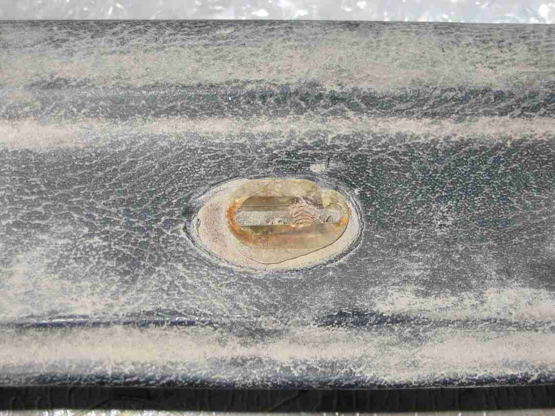

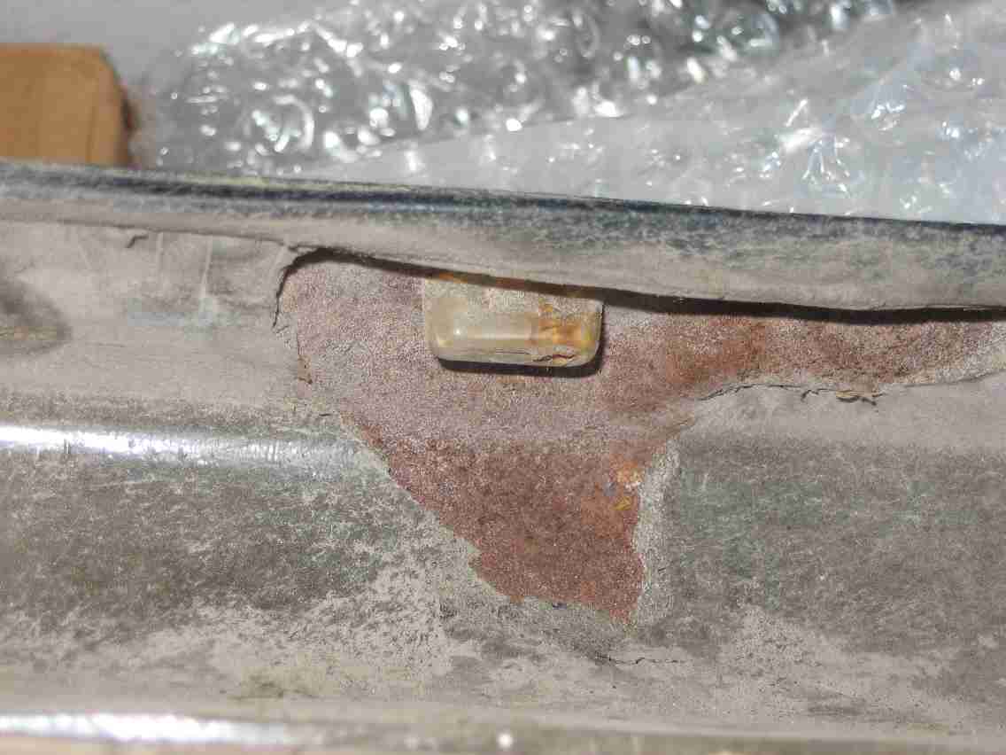

Not a nut plate that you're looking for. There are oblong nylon plugs with a slot that allow you to screw the instrument cluster to the dash. They grab and hold the screw. They pop right into the steel of the dash, and when you take the screws out they usually crumble apart.

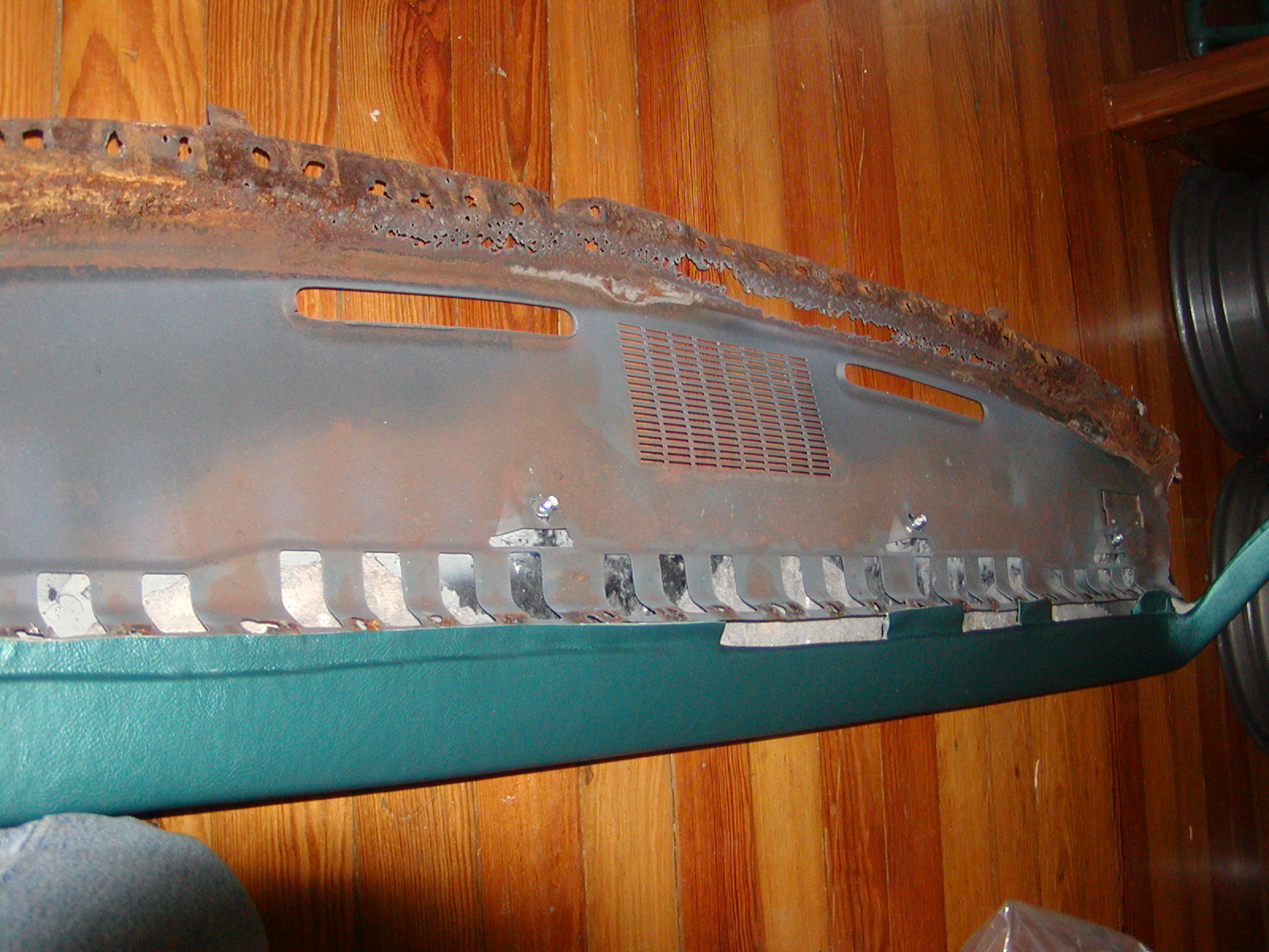

Yes, original dash pads had metal backing. The urethane dash pads sold by NPD (for '68) have a steel insert; the "premium vinyl wrapped dash pads" have a fiberglass core.

When I put my dash pad back in I didn't have the plastic inserts that fit up into the slots where the instrument panel screws in. I found a package of various sized nylon inserts at either AutoZone or Advance Auto that contained a couple of correct size, so I had to buy a couple of packages. They snap right into the metal slots and hold the phillips head screws perfectly.
