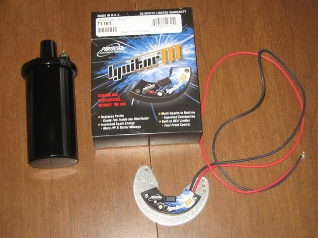

This one takes the place of your points and an ignition box like an MSD. It's also got a built in rev limiter. I like their products and thought this was cool so I thought I would share it.
The instructions are asking to remove any ballast resister if the car had one. It said they are normally a white block in line. I do not recall my car having one of these. Can anyone confirm if our cars had one?
Also, they are saying no solid core spark plug wires. Are the factory reproduction wires considered solid core? EDIT: They are not.

Our cars did not come from the factory with a ballast resistor, but came with the resistor wire instead.
If you have an Ignitor II and did the wiring conversion to supply 12v to the coil during run, then you are ready to play. If not, you will want to provide full voltage to the ignition system.
Where is the resister wire physically located? I am not seeing it on the schematics. I also really do not want to cut up the new harness I have, so can I run a parallel wire instead?

It's the wire that runs from the bulkhead connector to the coil positive. Yes, you can disconnect it at the coil and fold it back and tape/tie it back, and disconnect it at the bulkhead connector and tape/tie it back, then install a new non-resistor wire along the bundle and wrap it in.

I don't think it is necessary to remove the calibrated resistance wire with Ignitor II or Ignitor III. Check your instructions or call the tech line. The Ignitor requires the full 12 volts, but i believe the next two versions do not.
