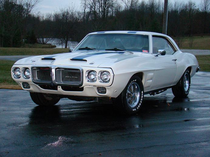

My rear suspension is all new, but it sits about 5/8" higher on the passenger's side. I looked at it for a while last night, and I have a couple thoughts, but wanted some feedback before I went at it.
I put new poly pads around the springs where they meet the brackets, but it prevents the lower brackets from being bolted on fully. In fact, I think most of the off balance rear is due to one side being bolted down slightly more than the other.
Should I just remove the lower pads altogether so that it sits better? Or should I try to even out the stance by trying to tighten one and loosen the other until it balances? This might not even be the right solution at all.
I'm not familiar with shims for leaf springs, either. How does that work? Thoughts?
