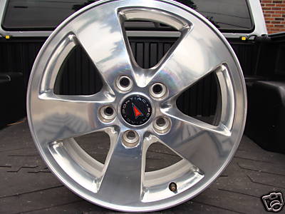

Does anybody have any experience with wheel spacers? I want to put rims and tires from a 05 Grand Prix on my 68 Bird. I know the bolt pattern and back spacing are not right but have found wheel spacer/adapters that could possibly get me where I want to be.
Unless the bolt patterns are the same, longer wheel studs won't be much help. What you probably will need are metric wheel studs if you plan to use the GP's lug nuts. They are probably metric.
