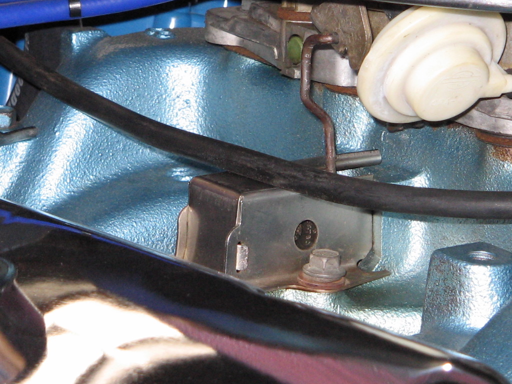

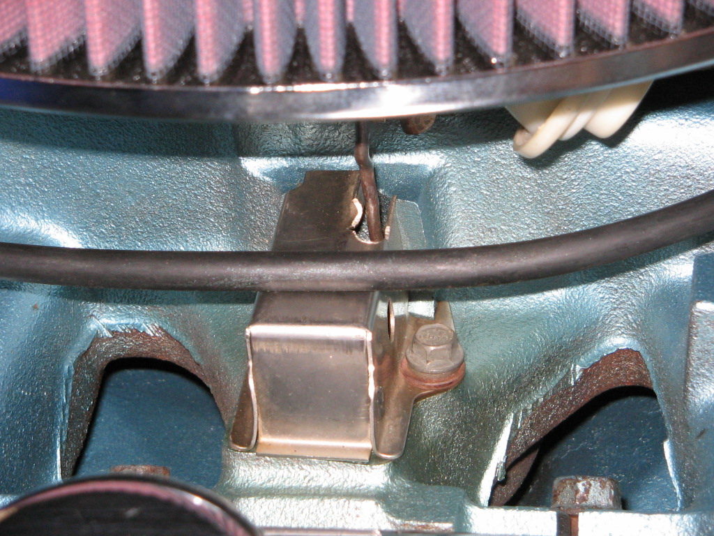

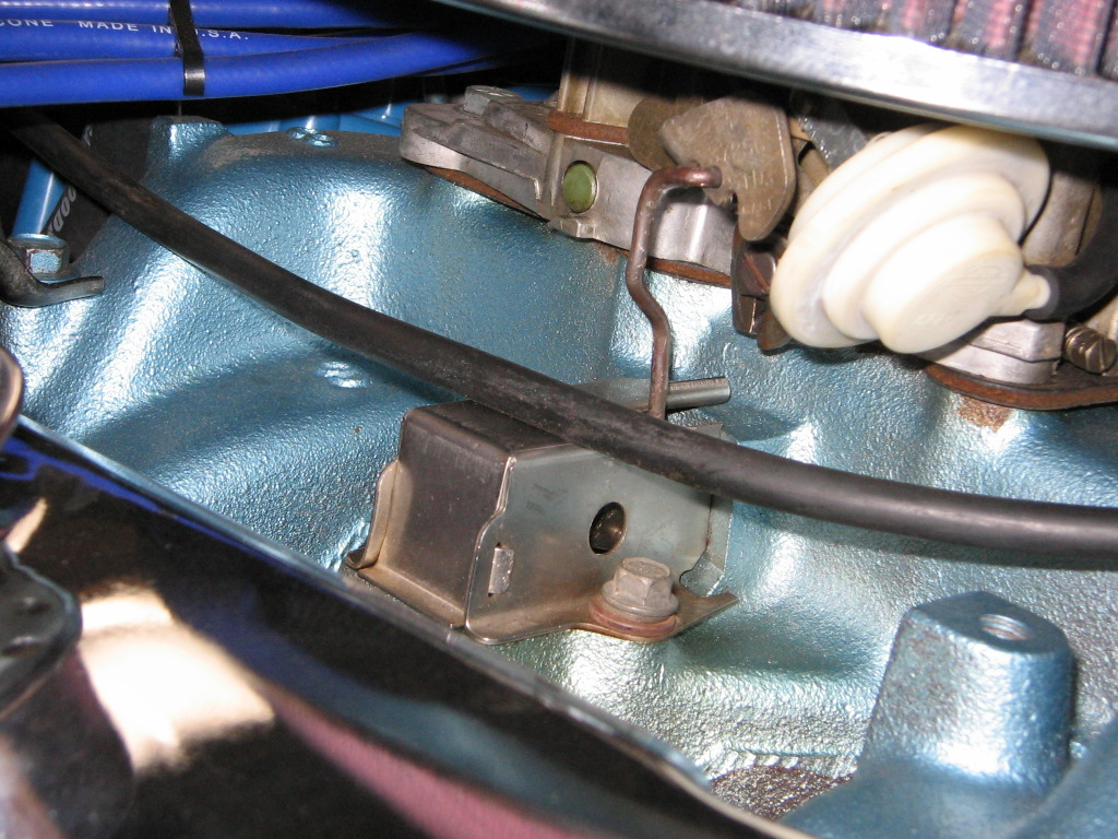

You should have what is called a divorced choke. It bolts to the stock intake manifold on the passenger side. They work ok, but electric is preferred and there is a carb company that now makes divorced electric choke setups. I'm gonna pick one up. Here are a few pics of the choke on mine.
they can be adjusted with a flat blade screwdriver through the hole in the side of the housing. just puts more or less tension on the bi-metalic spring which the rod is attached to. they do take some trial and error to get set-up, but work ok when they are.
