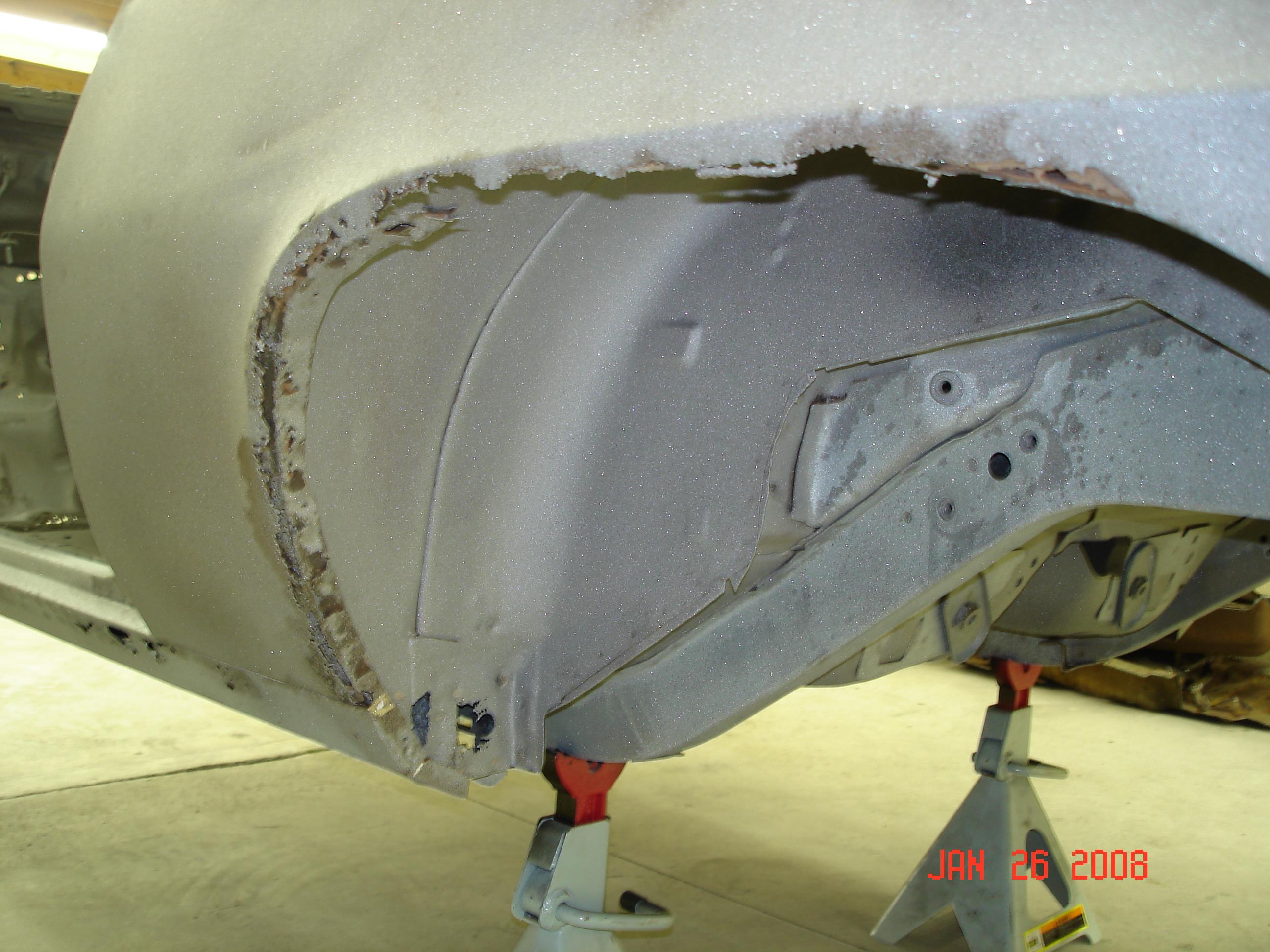

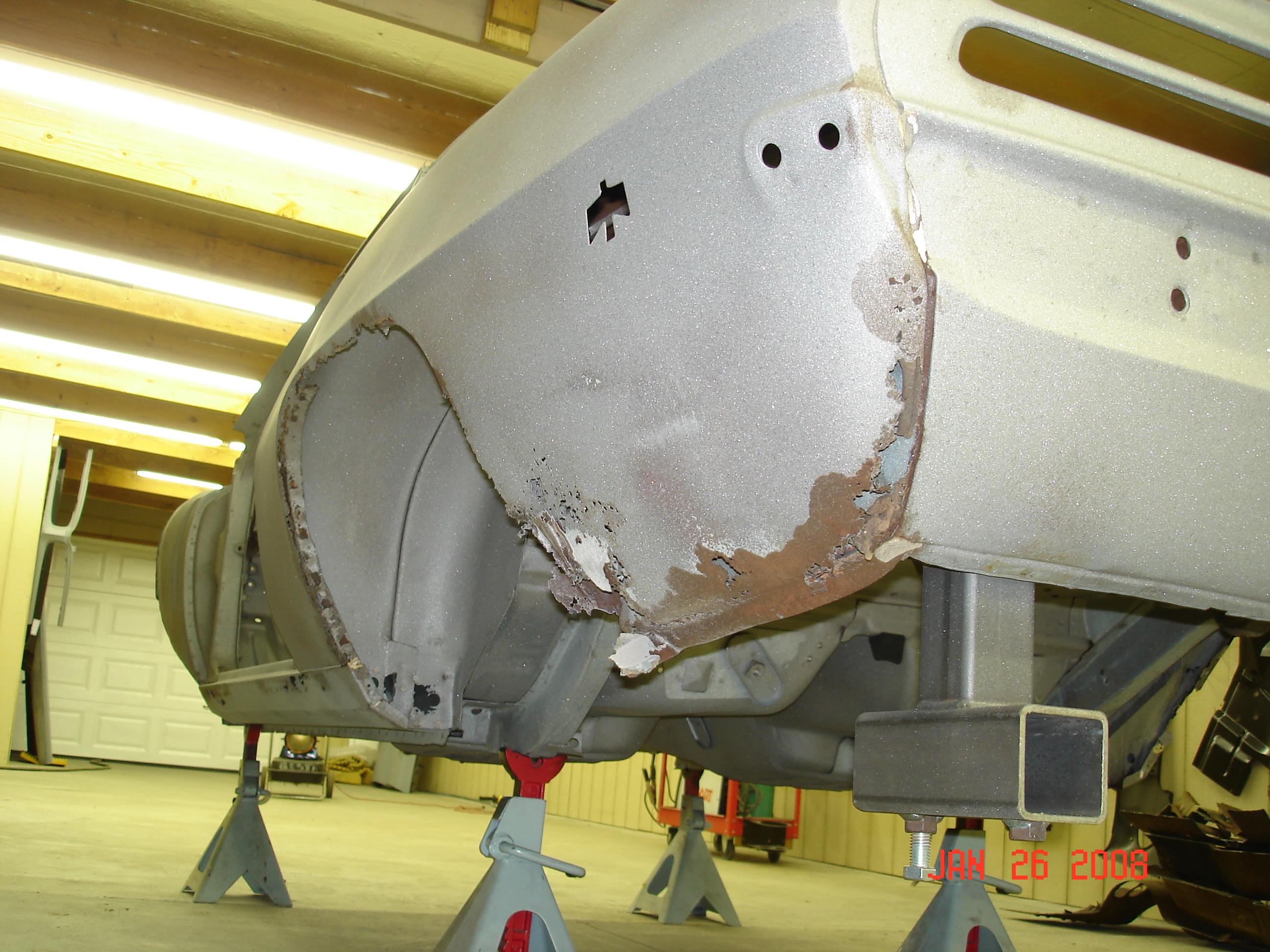

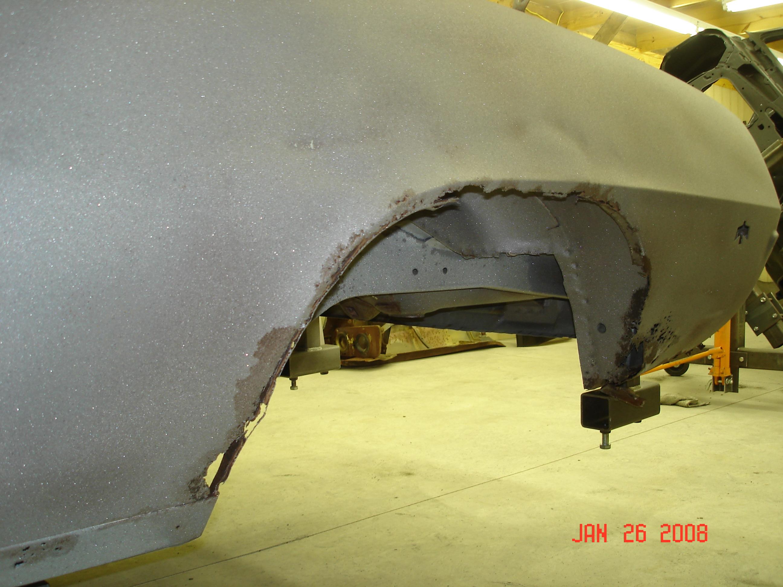

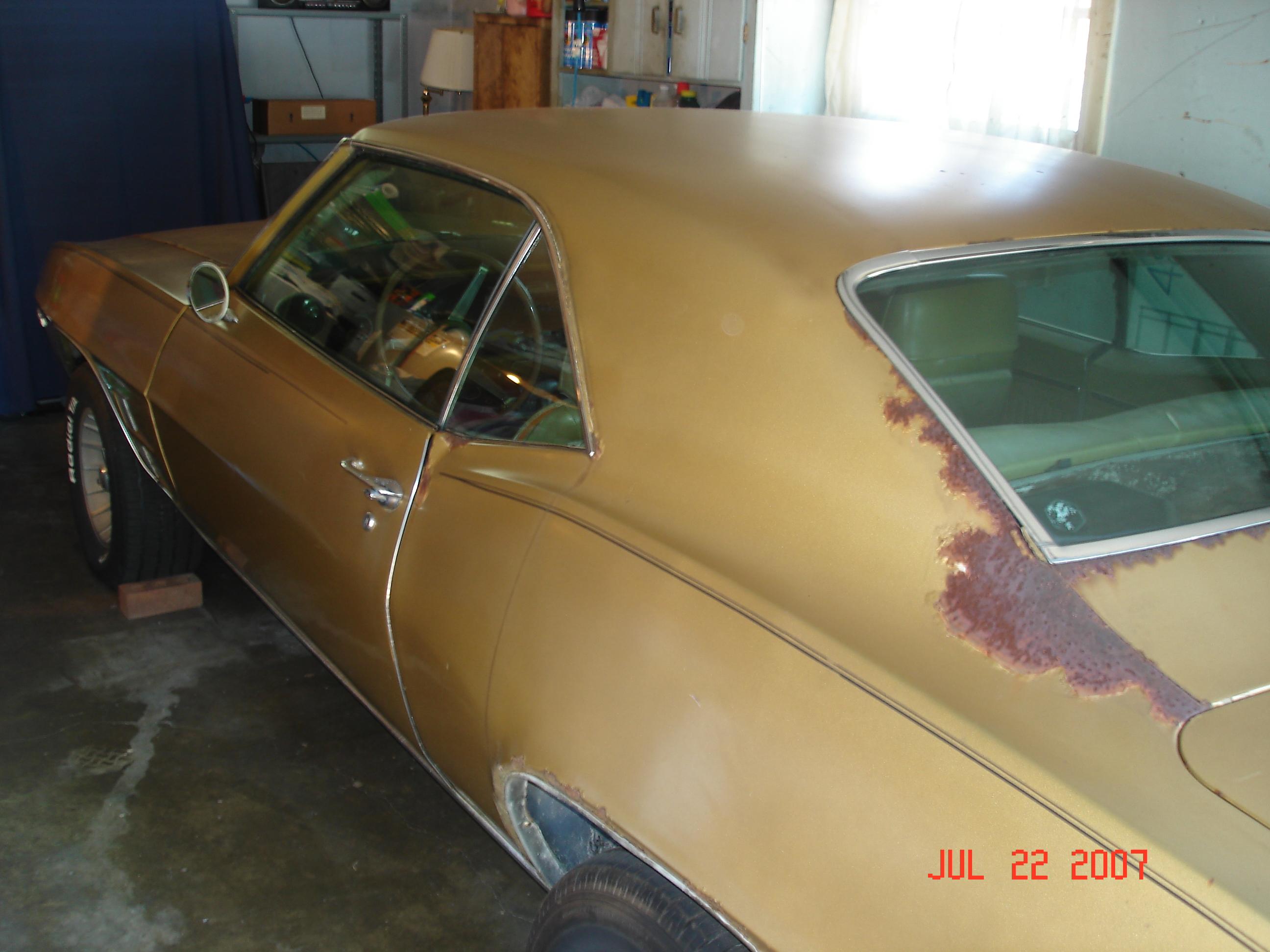

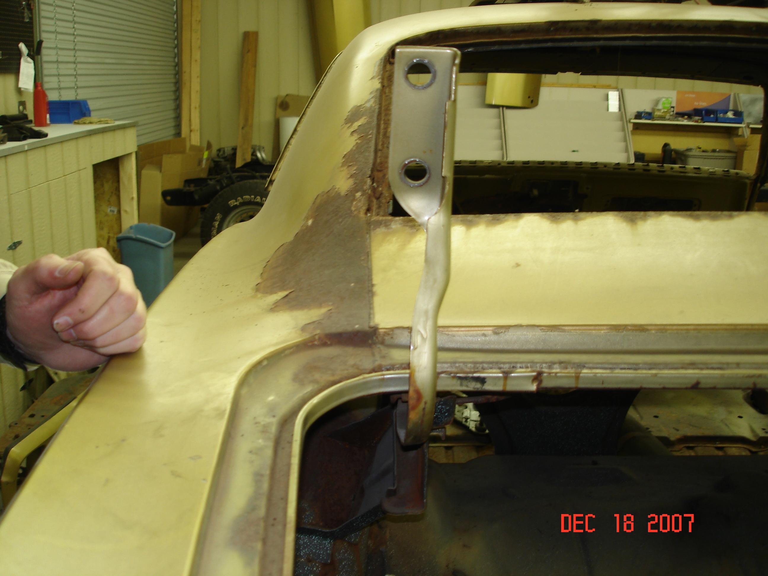

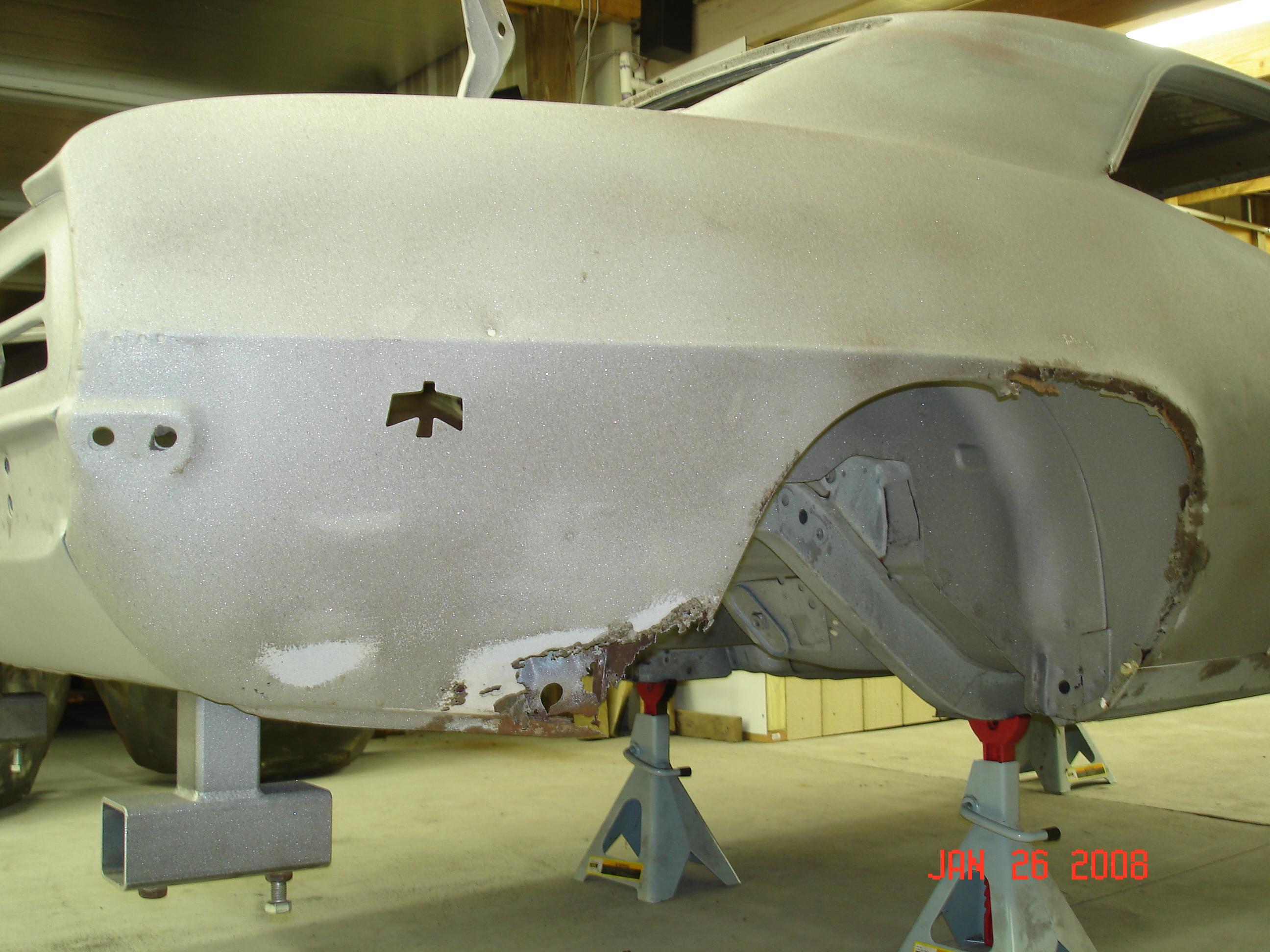

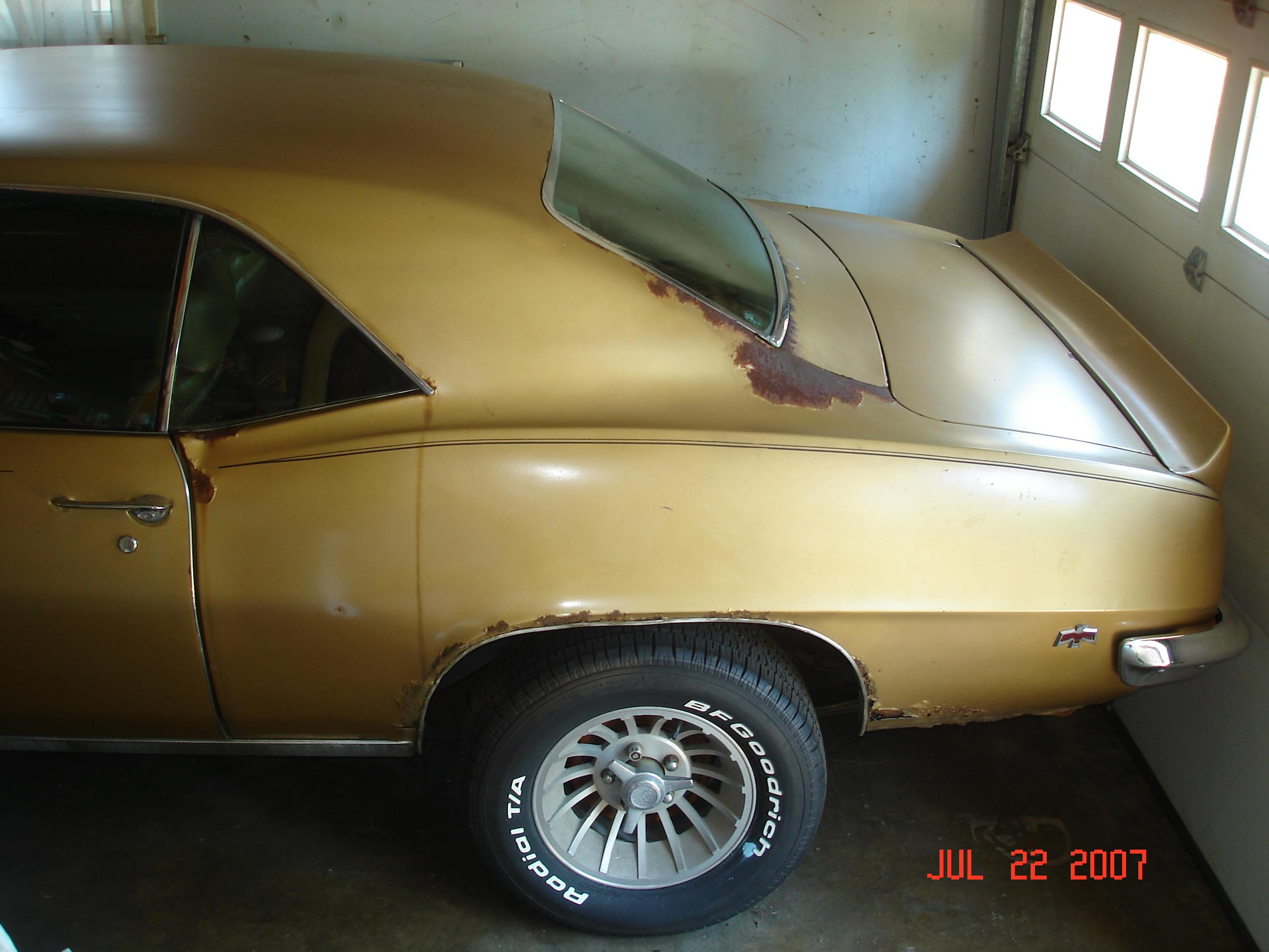

There is a big pitted area on the quarter where it meets the window. There is a small dent close to the small window on the side, and rust has eaten away some of the area around the wheel and lower part of the back quarter. (All of this is on the drivers side quarter)

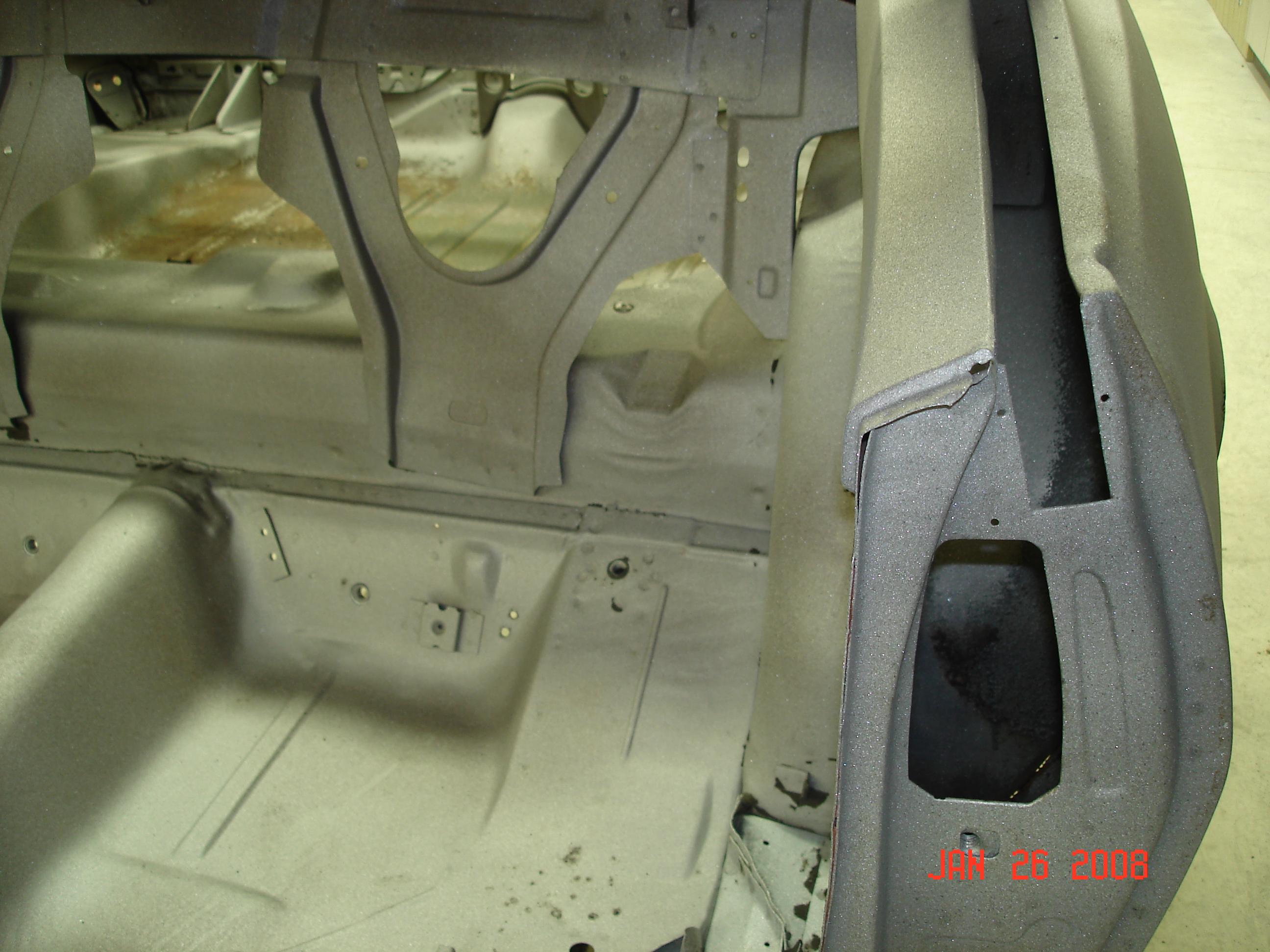

The passenger side quarter has very little pitting close to the window but has the same rust issues like driver's side.
I thought about putting a Full Quarter on the driver's side but patching the passenger's side.

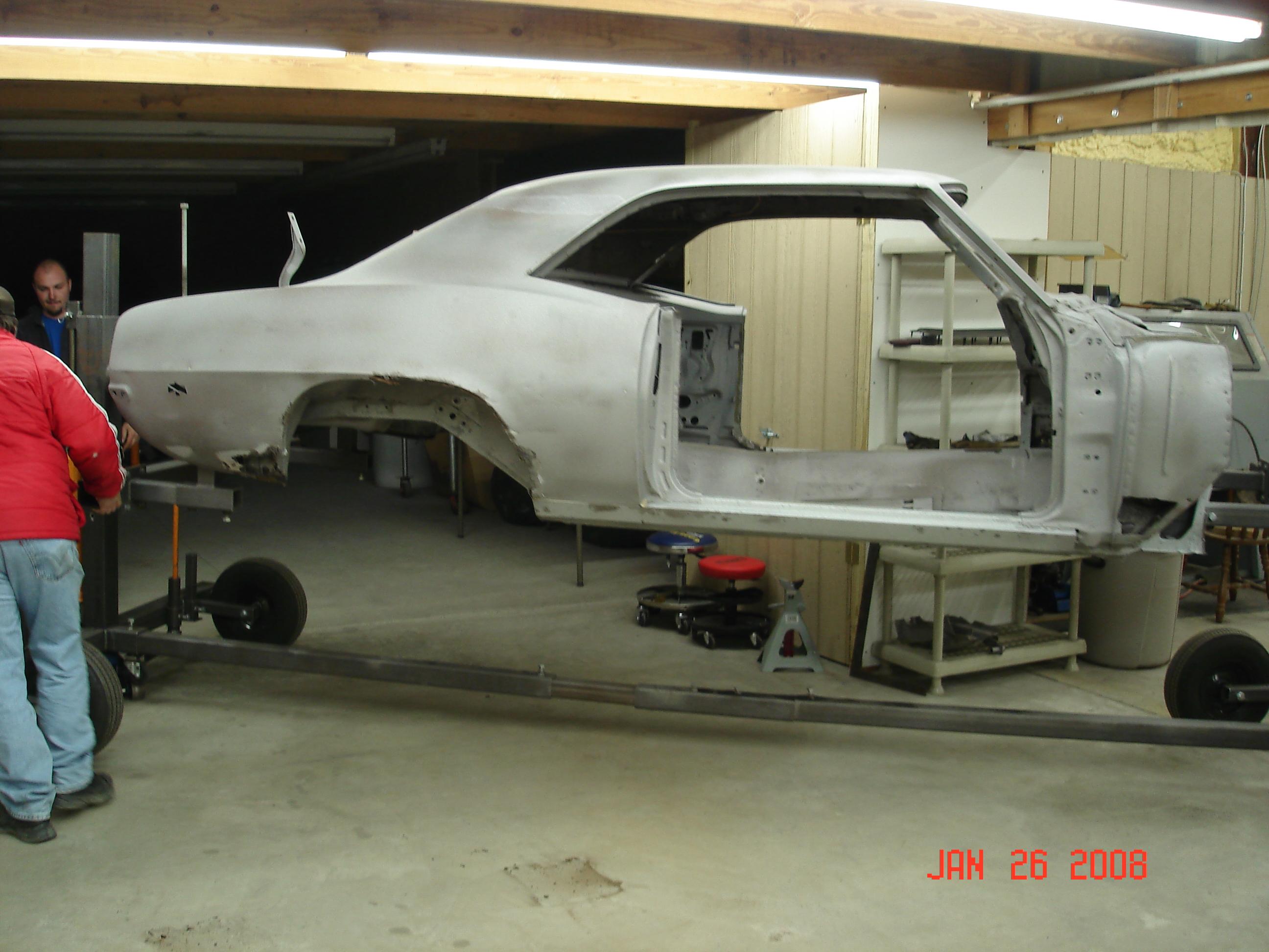

Also, I am going to need a full truck pan so using a Full Quarter would give me the opportunity to put a complete full truck in without cutting it into.
I would like to keep all original metal (but it's just a basic '69 Firebird with factory air, 4-speed, 8 track, etc.)as possible but I do not want any trouble down the line with patch panel work showing through the paint. I would rather take care of the problem now since the car is down to its shell.

Ron, I have just completed removal of my drivers side quarter panel, and I can tell you it is time consuming for sure. I would not remove any metal that is good where possible. That justs creates more work. It looks like you can get away with a skin on the passenger side (from what I can see, and an inner wheel house)?
You may still have trouble with a full trunk if you don't have the tail panel off? I just removed mine last night...that had a million spot welds to deal with.
