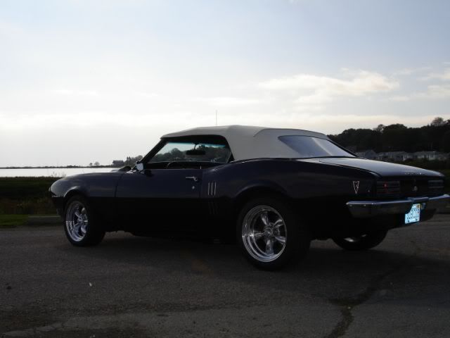

I have 17in. TT IIs on my 68 Convertible. I will try and post some pictures. I will also check to see the backspacing I have. Can't remember off the top of my head. I did alot of research and measuring when I did this. I would recommend you build a gauge to measure the room you have in the rear to ensure you have the correct clearance. What I found when I did that is that I had almost 1/2 in more room on one side than the other, so you need to measure both sides. I have the info on building the guage, just requires a flat piece of aluminum stock, and threaded rod/nut. Pretty easy. The setup I am using would need to be special ordered because it is not a stock set up. The guy I bought from orders this configuration in quantity since he rebuilds many Gen 1s. It'll be tonight/tomorrow before I can get more info. Do you have an email address I can send the picts to incase I can't get them uploaded?
Here's what I've got. I'm running 69 front Disc Brakes, and 2nd Gen Rear disc brakes on a 70's Nova rear end (same dimensionally as 1st Gen FB rear end). Car is lowered 1 in. all the way around, with stock fender wells. I have a slight rub in the driver's side rear if I have passengers in the back and I hit a bump. This is minimal and I plan to fix by rolling the fender's slightly this winter.
The Wheels you are looking at I don't believe will fit on your setup. I bought my wheels form Newstalgia Wheel in 2006 for $1080 including a wheel installation kit, and insurance. The rears were more expensive since they are a "custom" size.
Front set up: 17X8 (4.75BS) TTIIs w/ 235/45/17 BFG g-Force Sports Rear set up: 17X9.5 TTIIs (5.5BS) w/ 255/45/17 BFG g-Force Sports
