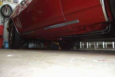

Ok, finally got to wax the new paint, and am ready to install the exterior trim. I have run into a couple of problems, but the main one is the rocker panel mouldings. The previous owner filled in the holes it appears for the brackets that hold the mouldings on. The holes underneath the body appear to all be there however.
Sorry to ramble, my question is placement of the L type brackets that the mouldings hang over before securing them underneath. I don't really know how they are supposed to look, so if anyone has pics, and measurements, I would be very appreciative.

No measurements but here's a picture I took when I last had the moldings off my '68 six years ago:
'68 400HO Conv.

that helps a bit, thanks. I wish it were in the body by fisher guide, but alas I have been unable to find it.
