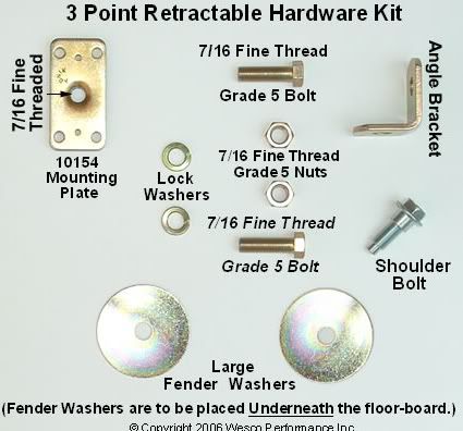

The "kit" I bought was from wesco performance, and came with a mounting plate that fits underneath your sheet metal, and the shoulder sash bolt fits into it.
Looks like this:
That was four years ago; there may be better ideas / solutions out there now...
