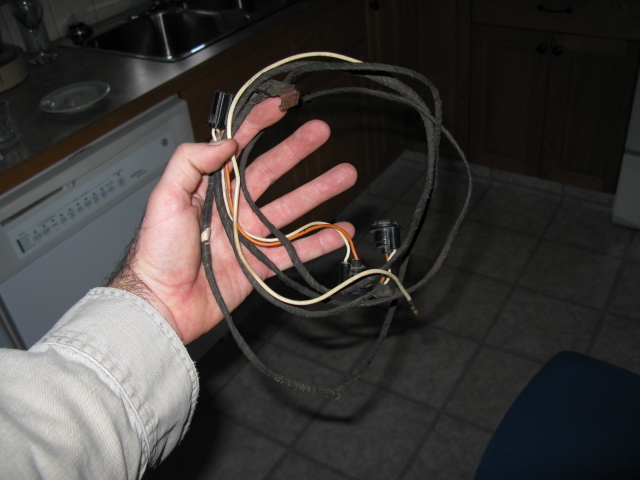

I can't find the right door and courtesy light harness hanging anywhere under my dash so I guess it did not come with the light harness I bought. I see in CI there is a harness that looks like it is what I need. pg.680 top right of the page. part#CA72725. Is that what I need?
If memory serves, those come off of the main wiring harness under the dash.
My new main wiring harness included them.
Yeah, I thought mine would have also but it did not. It just has a plug over by the drivers side door jamb and it looks like you plug in there and then run it up and over to the right side. Thanks

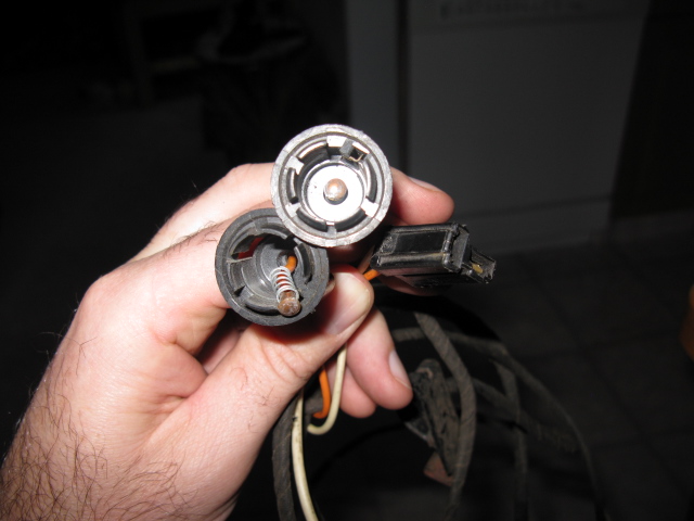

Yep thats it. There is a better pic on page 273 right side middle (has the sockets for the bulbs). Looks like 67 & 68 have different #'s. Do you have the metal courtesy lamp brackets? You will need 2 of them. They are there on the same page.
Yep, that looks like it is what I need. I do have the holders but not the lamp holders. I have not looked for those yet. I also need the switches for the door jambs. Is CI the best place to get these things or are there better places to look? Thanks
Just notice that the harness has the lamp holders on it. oops!

Well I got my harness off ebay only to find out when I installed it that a previous owner tucked the originals wayyy up underneath the dash. So I have an extra 43 yr old original you can have if I can find it. If you are not interested CI, Ames, etc. are all pretty close for price and service. Just avoid ebay Tamraz. I've heard horror stories.
