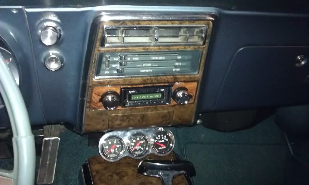

I finished up the radio and speakers this weekend. I did have to take apart the center section of the dash along with the glove box. All in all wasnt to bad of a project and sounds fairly good. The wood could of matched a little better.
