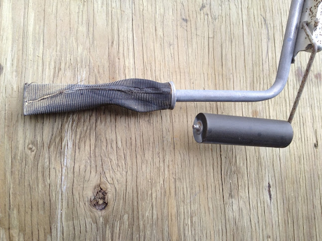

Other than originality, is there a functional reason to get it with the return line? The reason I'm asking is that mine originally had the vapor line, but when I replaced my tank, I could only find the single line version & now I'm having difficulty filling the tank. Need to fill slowly & still only get 6 gal in; would the vapor line help?
At $60 plus shipping it made a lot of sense rather than border jumping. I took some pics and will post tomorrow.

I was going to say that Ecklers (Ricks) has the sending unit with fuel line and vapor line because I just purchased one myself.
The other thing I was going to say is in the beginning of this thread you mentioned Earlybirds has one and I am assuming that you are talking about Earlybirds in Canada and not my company, Early Birds which is in Ohio. Like I said, I have purchased one for my own Firebird but I am not selling them right now.

Saw your post and called Ecker's Tech Support to verify that they were compatible. THe return was a little shorter than stock but other than that, it went in with no issues.

The problem I have with "Rick's .." is it's described as a '69 sending unit. 68 (6427857) Firebird sending units have a different part no. than a 69 (6428667).
The tanks and gauges are different for 68 and 69 so I would expect the sending units to be different.
But...the picture they have at "Ricks..." looks fairly close so maybe there are describing it wrong.
Anyone have a stock 69 pics of a fuel sending unit?
Installed the sending unit the other night and installed the tank with an AMES dampening kit (didn't take pics of the two sendres side by side which would have been helpful (they looked identical with the exception of the shorter return SST line to the sender); only so much daylight with the storage space.
Tonight I poured 6 gal of 91 octane, non-ethanol and it read 1/3 full; added another 6 gal of the same and 2/3 full. I have 5 more gal of the good stuff that I will pour tomorrow and see where it ends up.

The eBay auction tank sender looks to be a bit more correct than the Rick's Camaro's unit regarding the length of the return/vapor line. The price is a little better as well (paid $75 with shipping).
