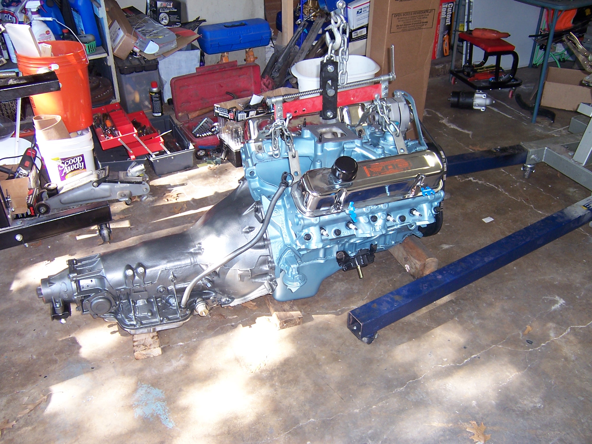

going to break it in on a run stand first weekend of May then hope to drive in mid June.

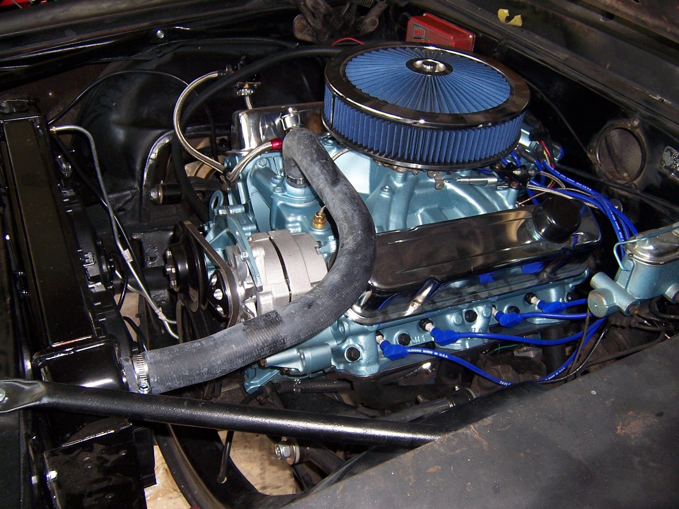

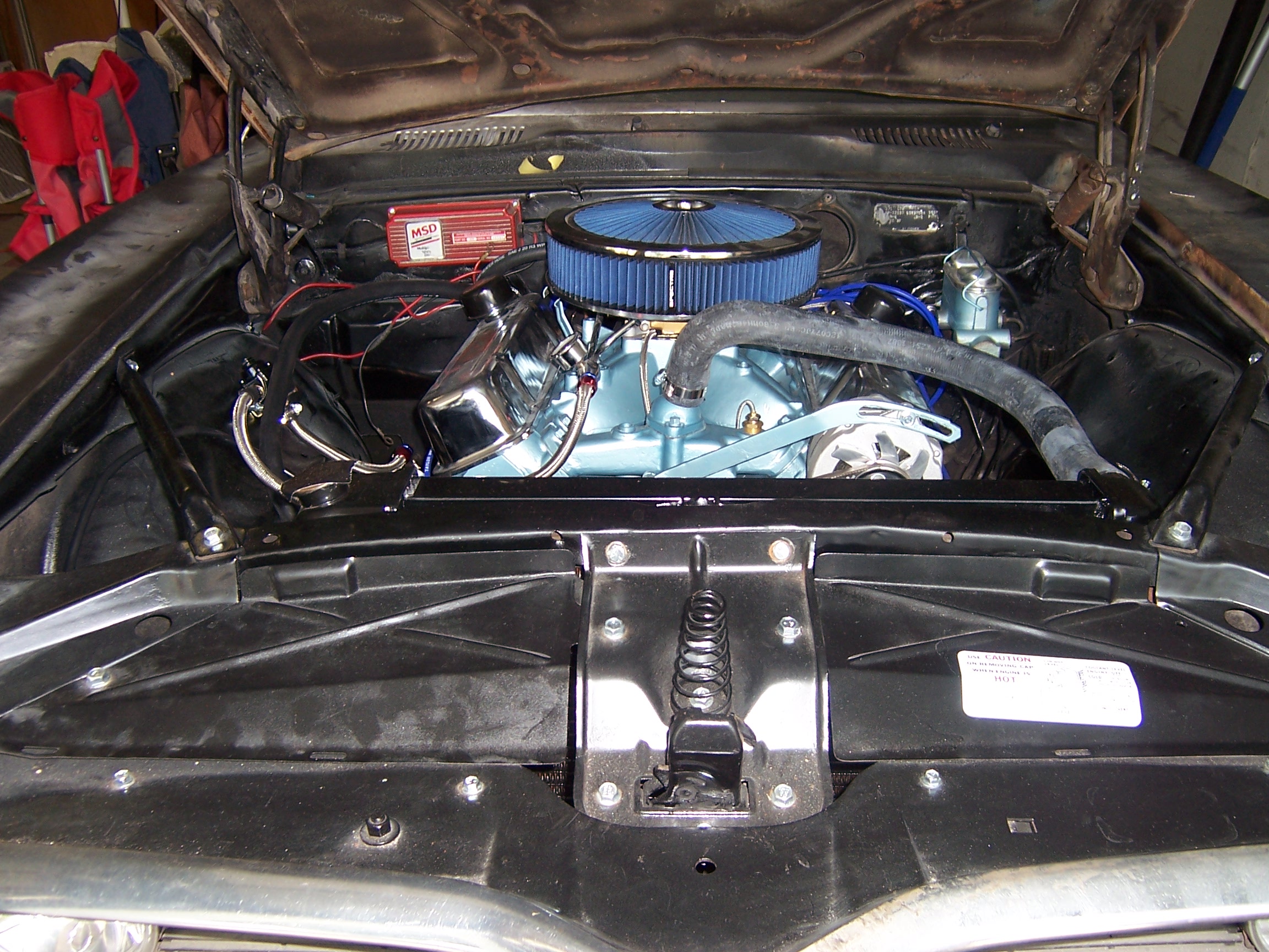

ok heres an update...engine and trans in with headers,lines and hoses...little bit of electrical to go and i can start her....then the exhaust,wiring harness,drive shaft,caltracs,rear brakes and gears,gas tank....etc

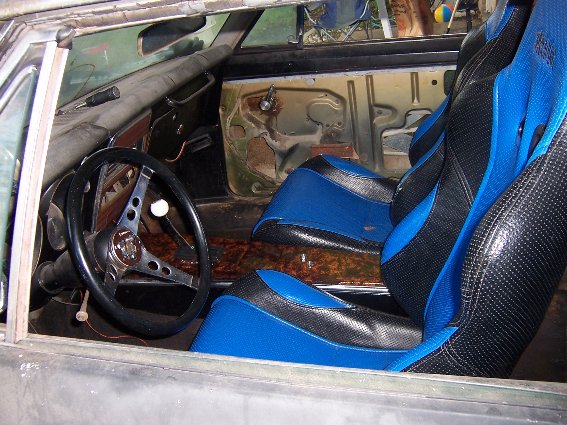

So the interior should of looked like this.. just swap the black color for gold..
Kyle
67 Verdoro Green 400 Front bench w/auto on column Now excepting- free, ready to bolt on, Pontiac Aluminum Heads... Thanks to John(Hammered)-- This project is REBORN!! http://s903.photobucket.com/albums/ac237/lupdiesel/
yes kyle exactly like that all though mine was not an a/c car.....but it still have the gold back seat,rear gold side panels and a set of standard gold belts....seems this car was a wierd option car...lol
