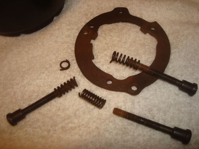

You do need the springs. I hope they show up in my picture.
You will have one larger spring for the horn and like mentioned two springs for the turn signals.

I believe these are the springs you're talking about.
Joined: Aug 2012
Posts: 104
J Offline
Joined: Aug 2012
Posts: 104
Yes,Yes,Yes Colorado68 thats the springs!!! Please tell me you have some spares to sell me? or who and where I can get them? or?? Although they dont look quite like the ones that I have now. My column 2 out of 3 springs are different (one broken) I suspect that there not original anyway? Already hit the local hardware stores and got a couple that I would have to cut but I'd rather have the correct or near close to match springs to use. I'm still cautious about using other springs because i'm not sure what there for in the column. Thanks.

I just went thru this ordeal a few months ago myself. I ended up finding springs at NAPA. Not the "correct" springs but if you take one of your springs to them they can match them up pretty good. I recommend springs that are stiff (hard to compress). The reason for the springs is to create resistance to the round colar when you insert and turn the turn signal assembly back on the steering column. it was quite a PITA job!
Once the turn signal assembly "locks" into place you then tighten those three screws AND YOUR DONE.

Wish I had some spares, but sorry I dont. 68convert is right and would try NAPA like he suggested.

Colorado68, is there anyway you could measure the length of that spacer inside the large sping in your picture. Mine is missing. Wondering what the length and possibley the inside diameter.
