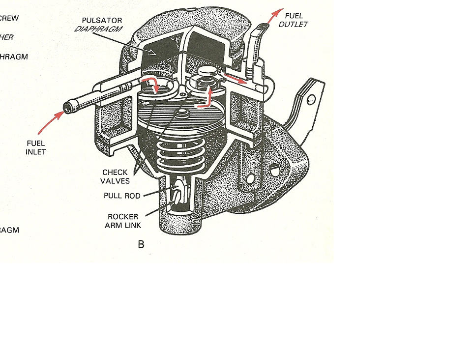

I still maintain (and not all agree) that the design of the rochester fuel inlet will allow the fuel to flow back to the gas tank if the 2 check valves in the fuel pump don't seal, and the carb needle doesn't seal or is off the seat. The pump will still pump fuel up to the carb even if the check valves don't seal. To check you will have to crimp off a rubber hose in the line somewhere, but if you are all stock it will be all metal. Then you would have to remove the fuel pump suction line from the tank and see if any fuel is coming back from the carb, through the fuel pump (may take a few hours to see).
