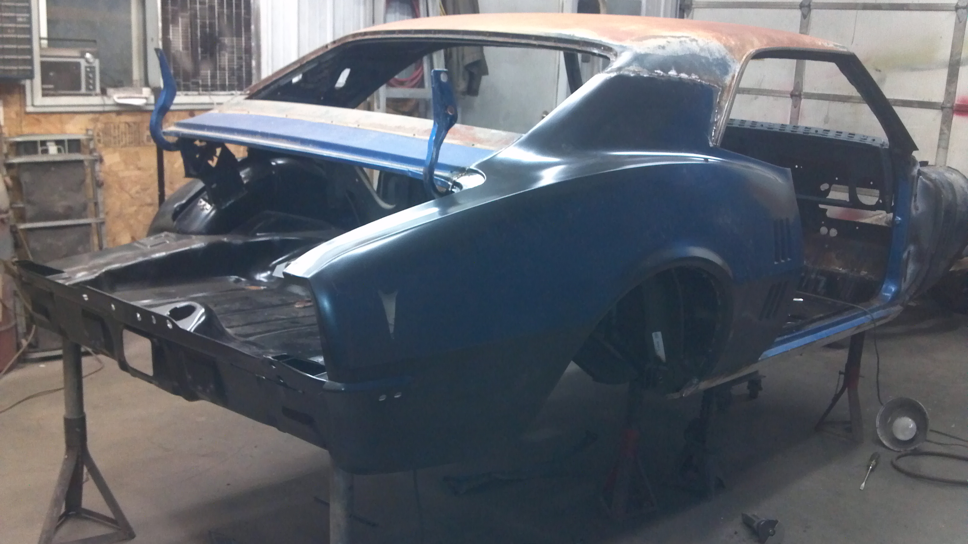

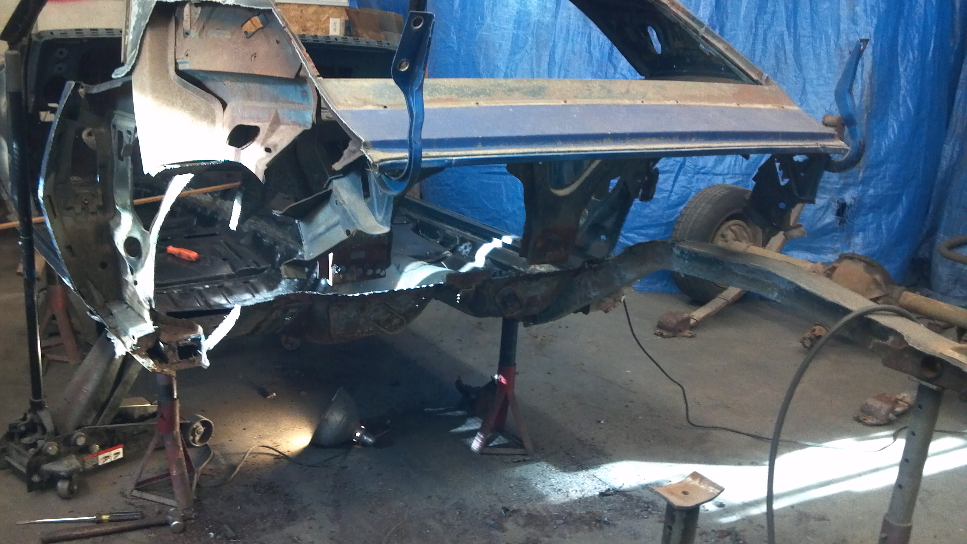

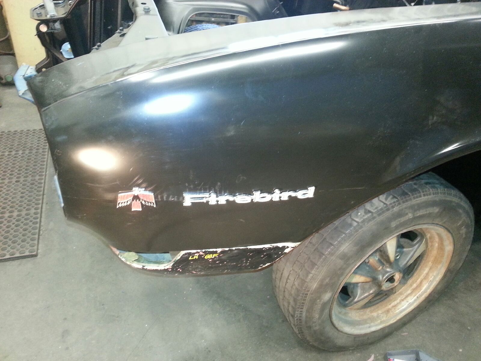

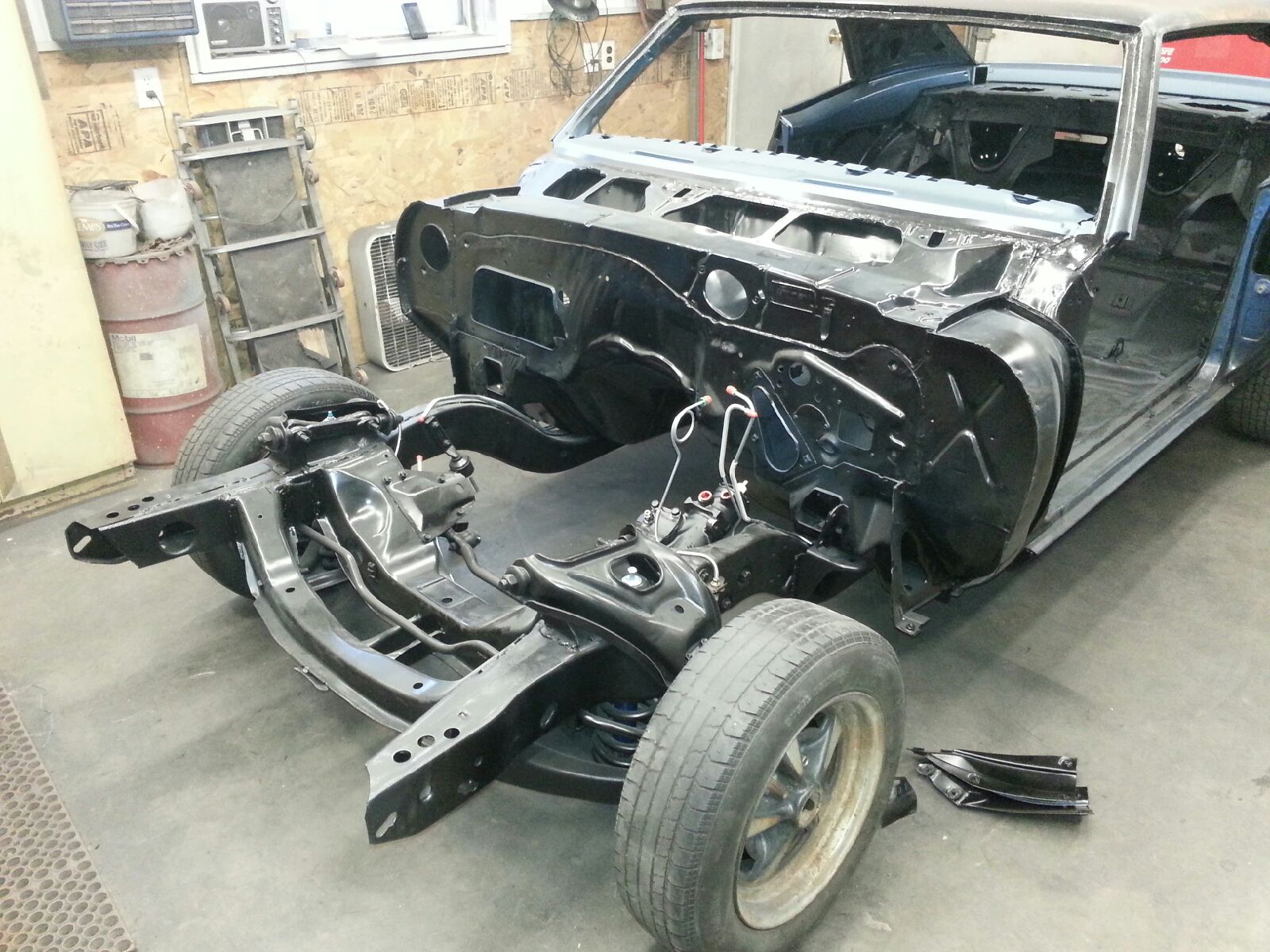

Thought I'd update you on progress now that the '67 is gone.
I get a kick out of that last shot. grin

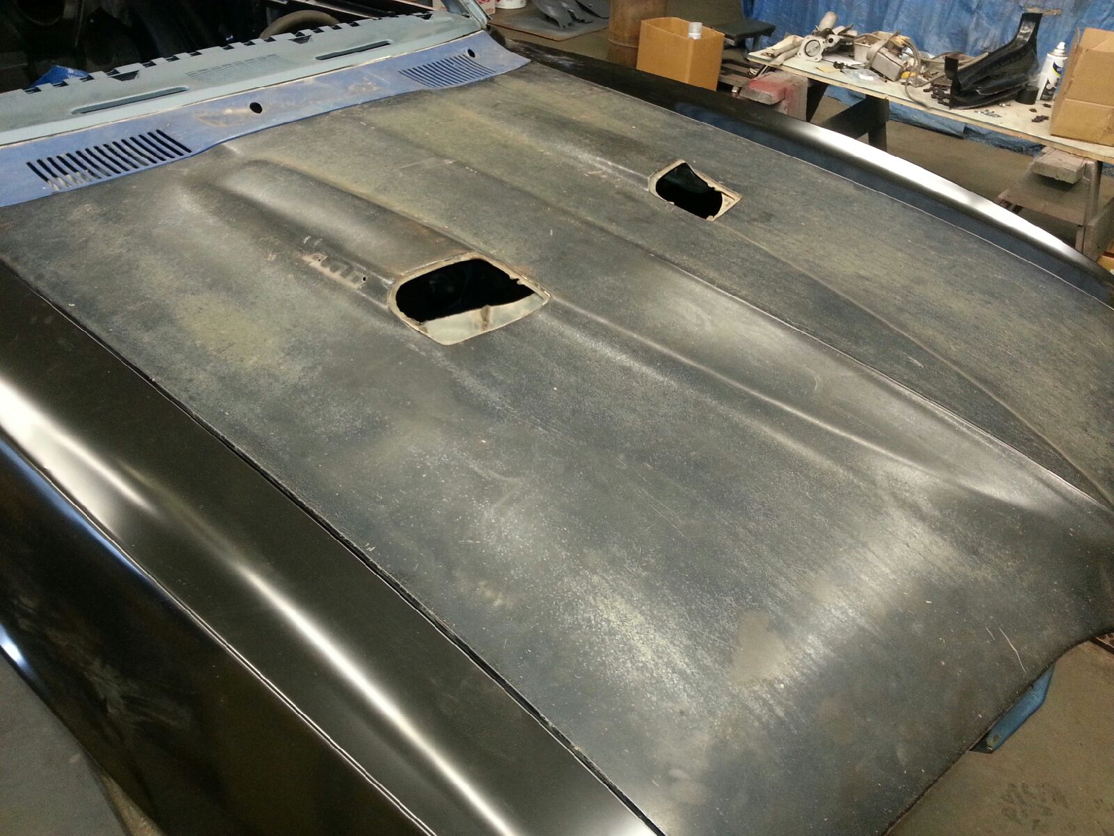

Here's one with part of her new skirt on...
Looking good brother!

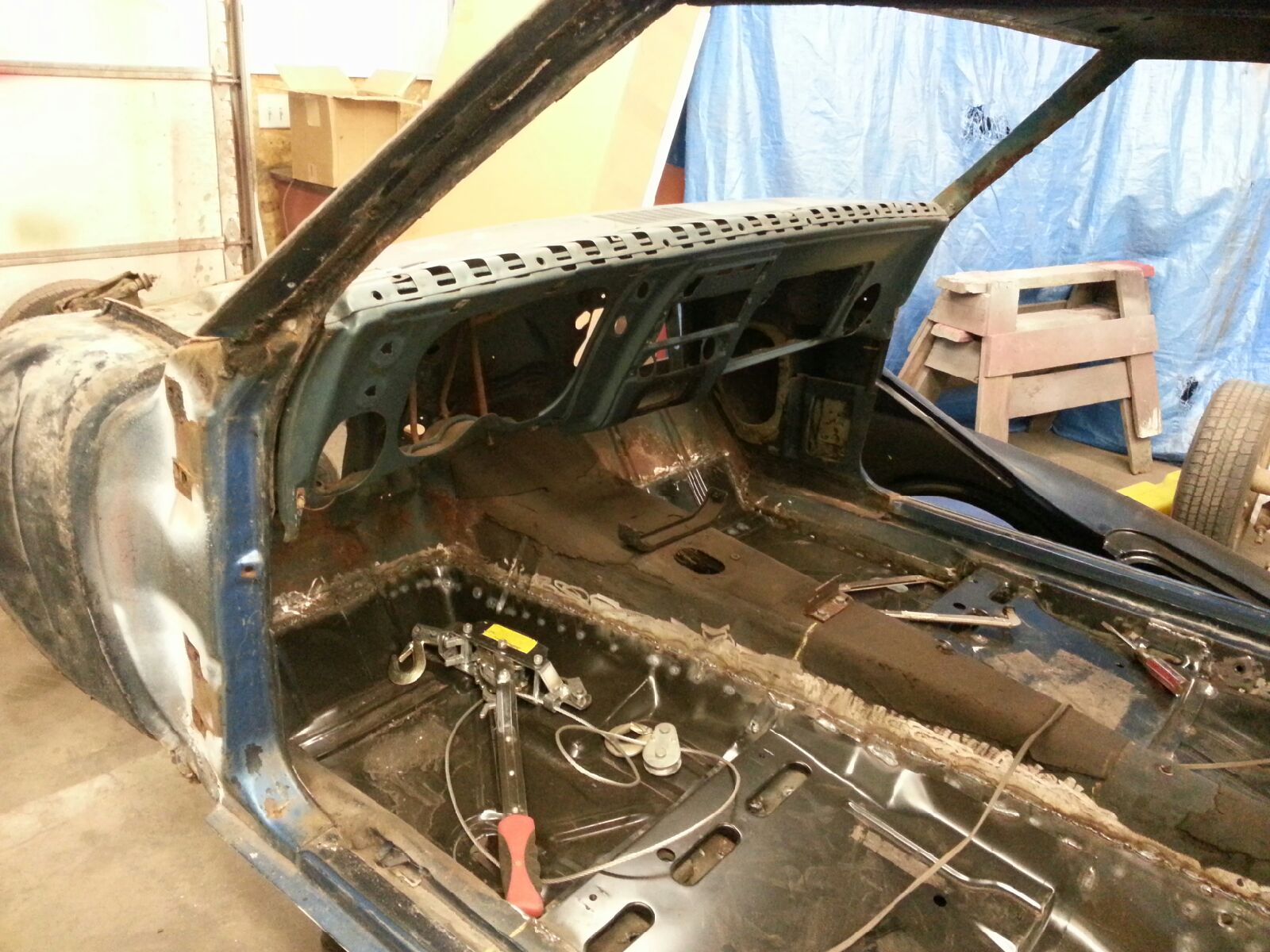

Here are a couple from this past weekend: Lots of dust in there. frown

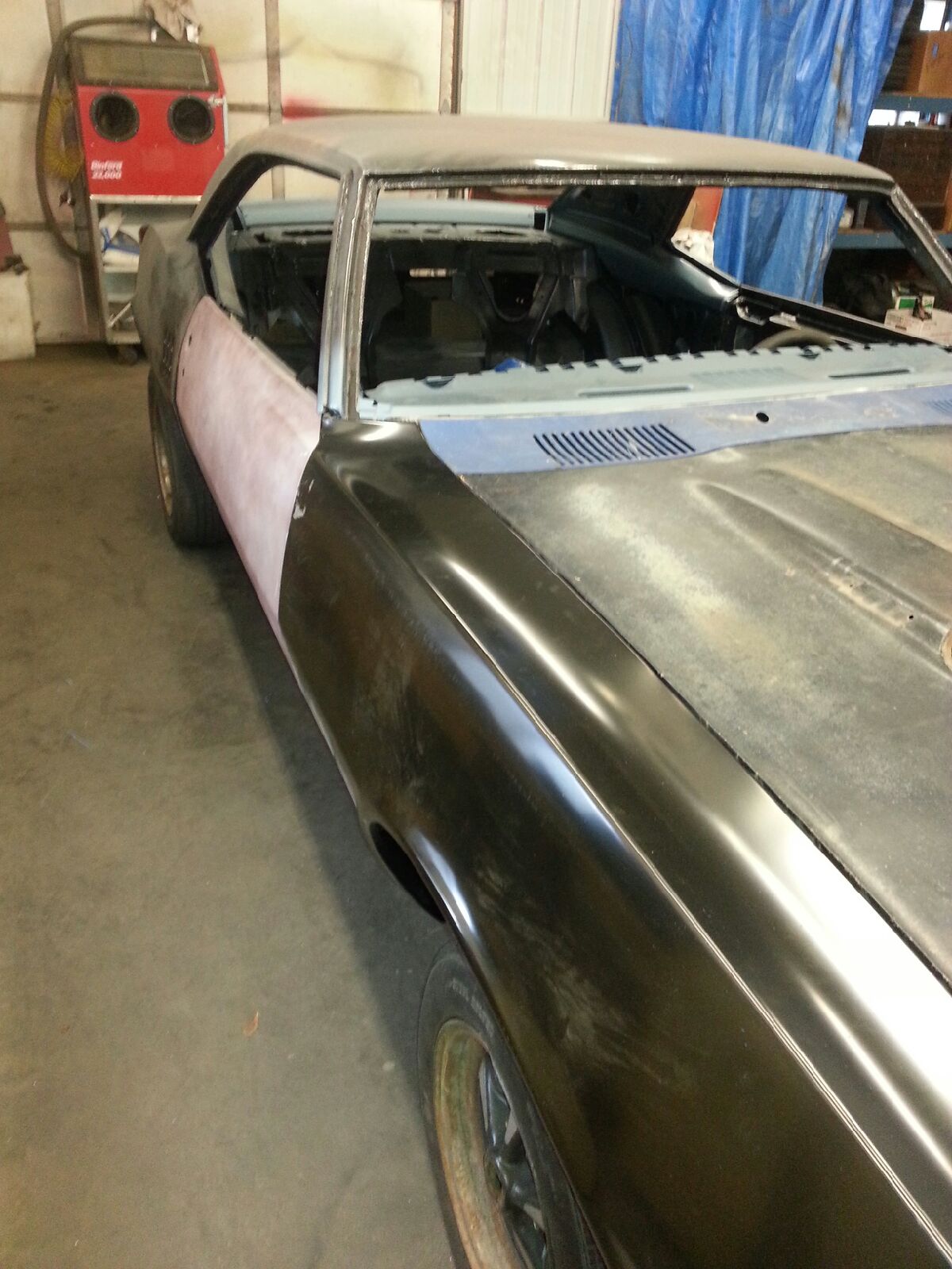

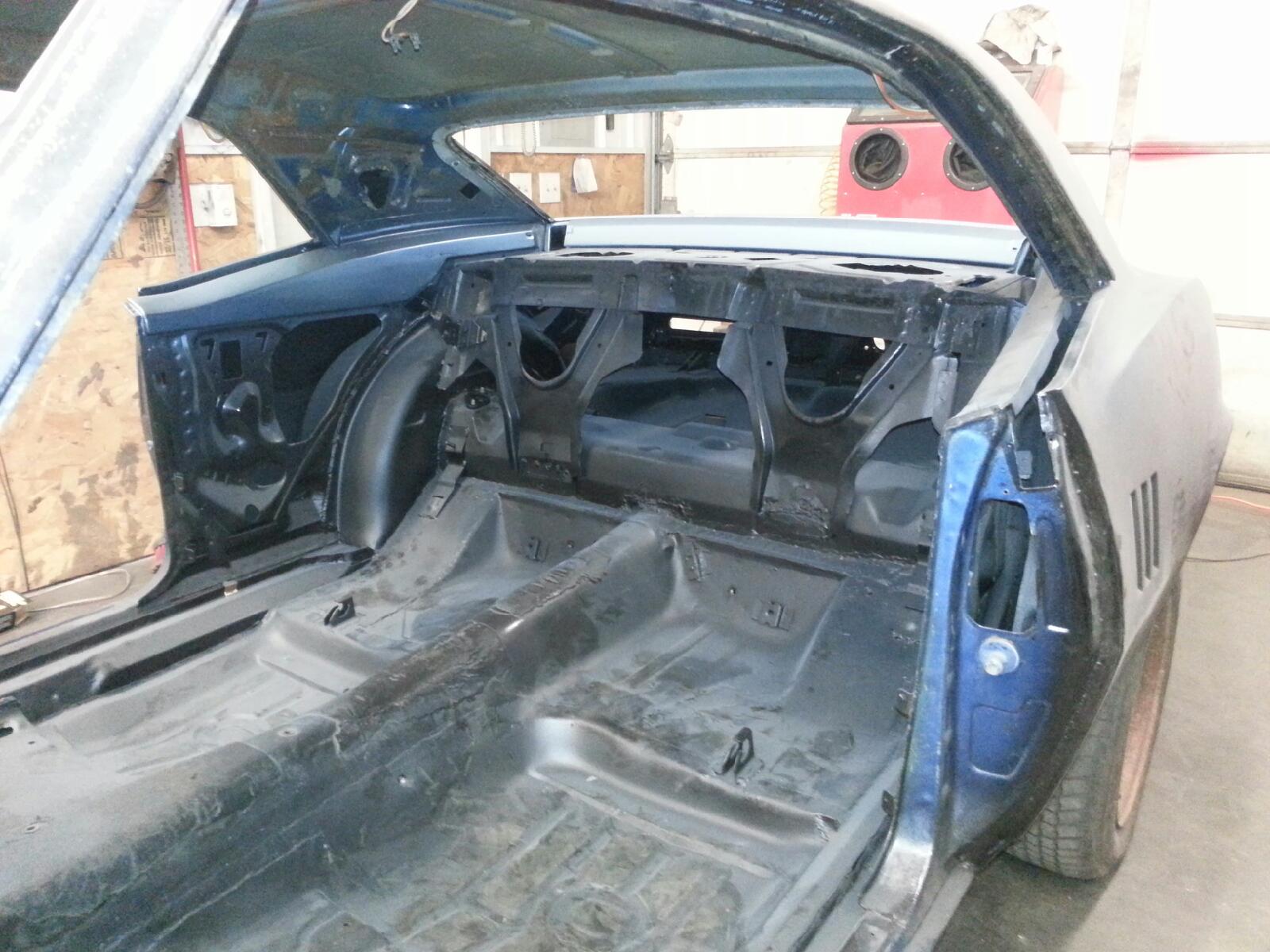

Look great. I have a question though. In the second pic where you can see the seat area there it looks to be like there is two layers to the floor. A riser for the seat to bolt to maybe? The floors were already in my car when I bought it and I do not have that top layer. Can I purchase just that part and weld it in? If so where do I get it?
Larry, do you mean the second picture at the beginning of the post? That is a picture of the front seat mount area? The bottom would be the floor pan. Then there is the seat brace section. Then over the top is the seat pan. You must have that, or there wouldn't be anything to bolt your seat tracks to. All of those parts are available from all of the repop shops. Or do you mean something else?

The second pic from the top is what I meant. I have this frankenspacer thing in there now and never thought it looked right. I have the ames catalog out on my desk right now and see what they call a bucket seat platform. I have the seat brace I think. Gonna order the platforms I think.

I probably have the old ones if you want them. Cutting and shipping might be a pain. I think they are somewhere around $40 a side or something for new ones.

Appreciate the offer buddy. For what they are worth new I will probably go that way.

One more question. Does the top panel raise the front of the seat?

I wouldn't say raise it. But it makes them level. I guess relative to the slope of the floor pan, the front would be raised.

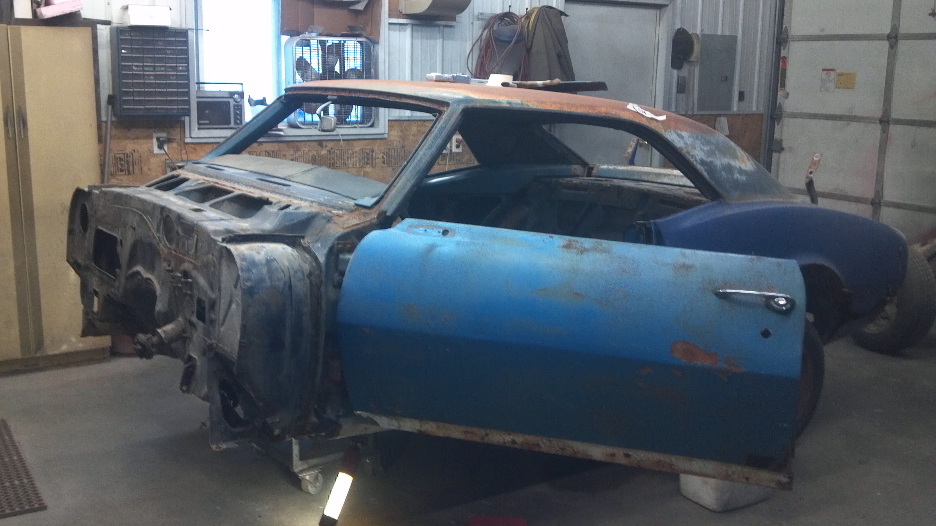

A few more from this past weekend. Body all back together, ready for the ride to the paint shop for final bodywork and painting.
Summer is coming fast!
