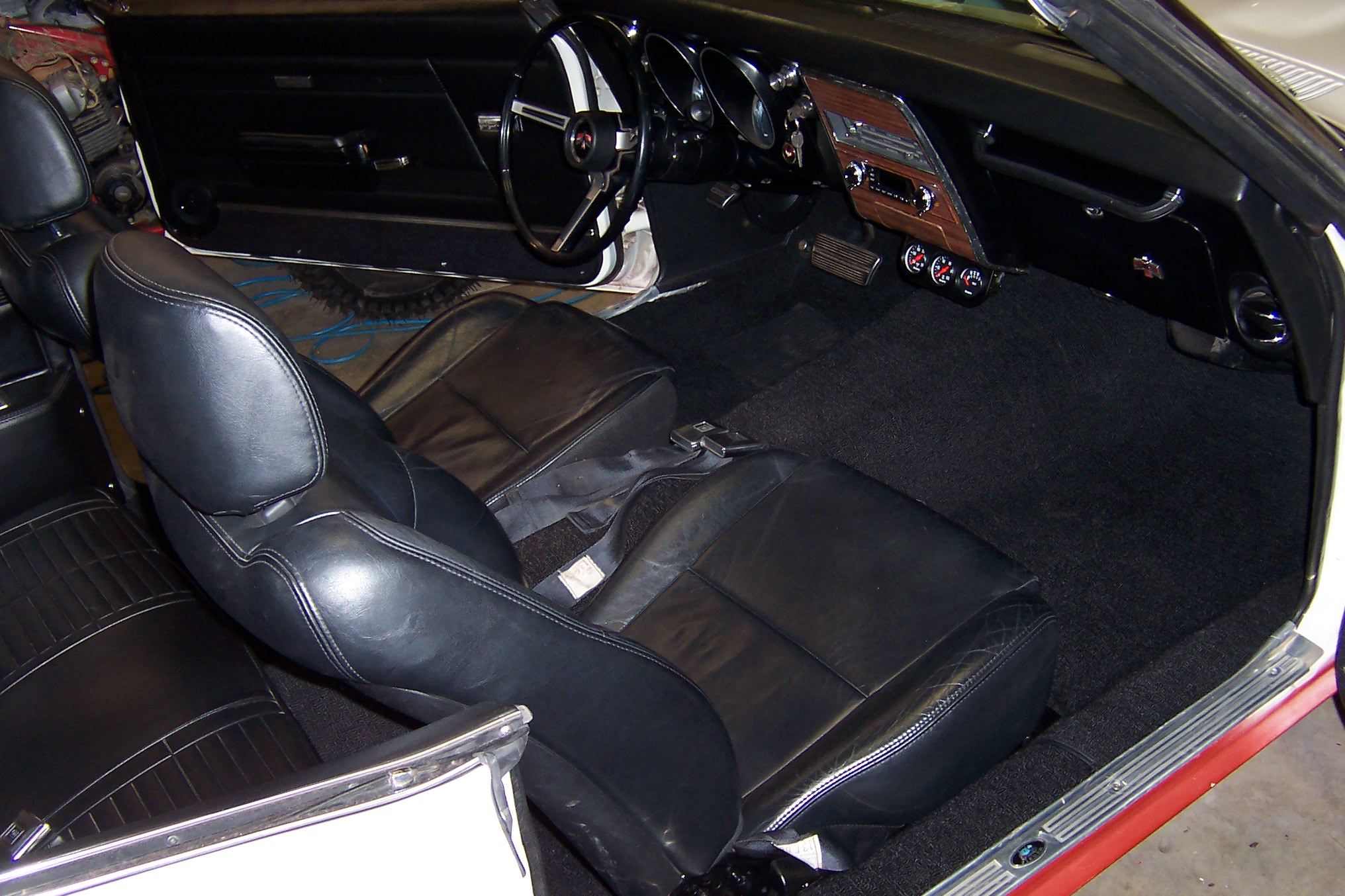

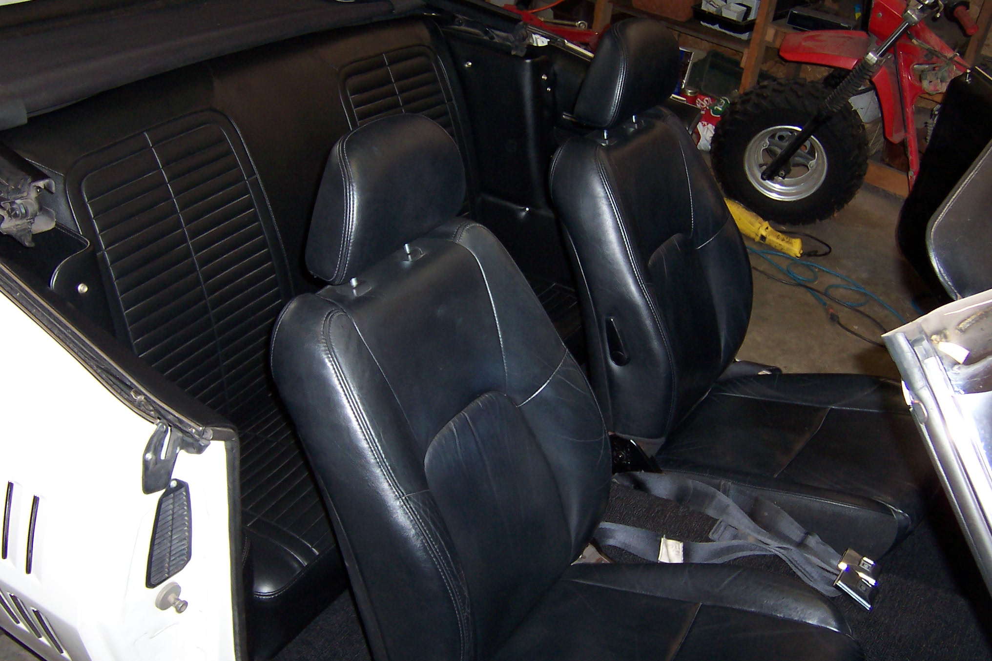

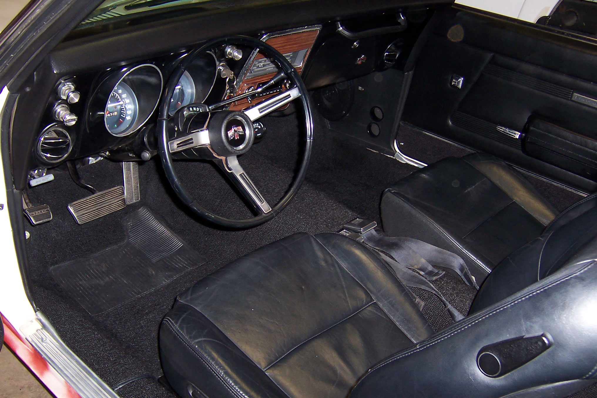

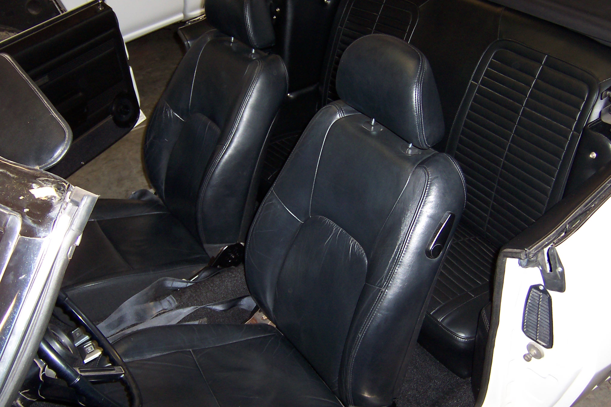

lots of seat eveidently fots...friends have used Sebring seats, late model GTO seats, late model Camaro and firebird seats , BMW seats....
