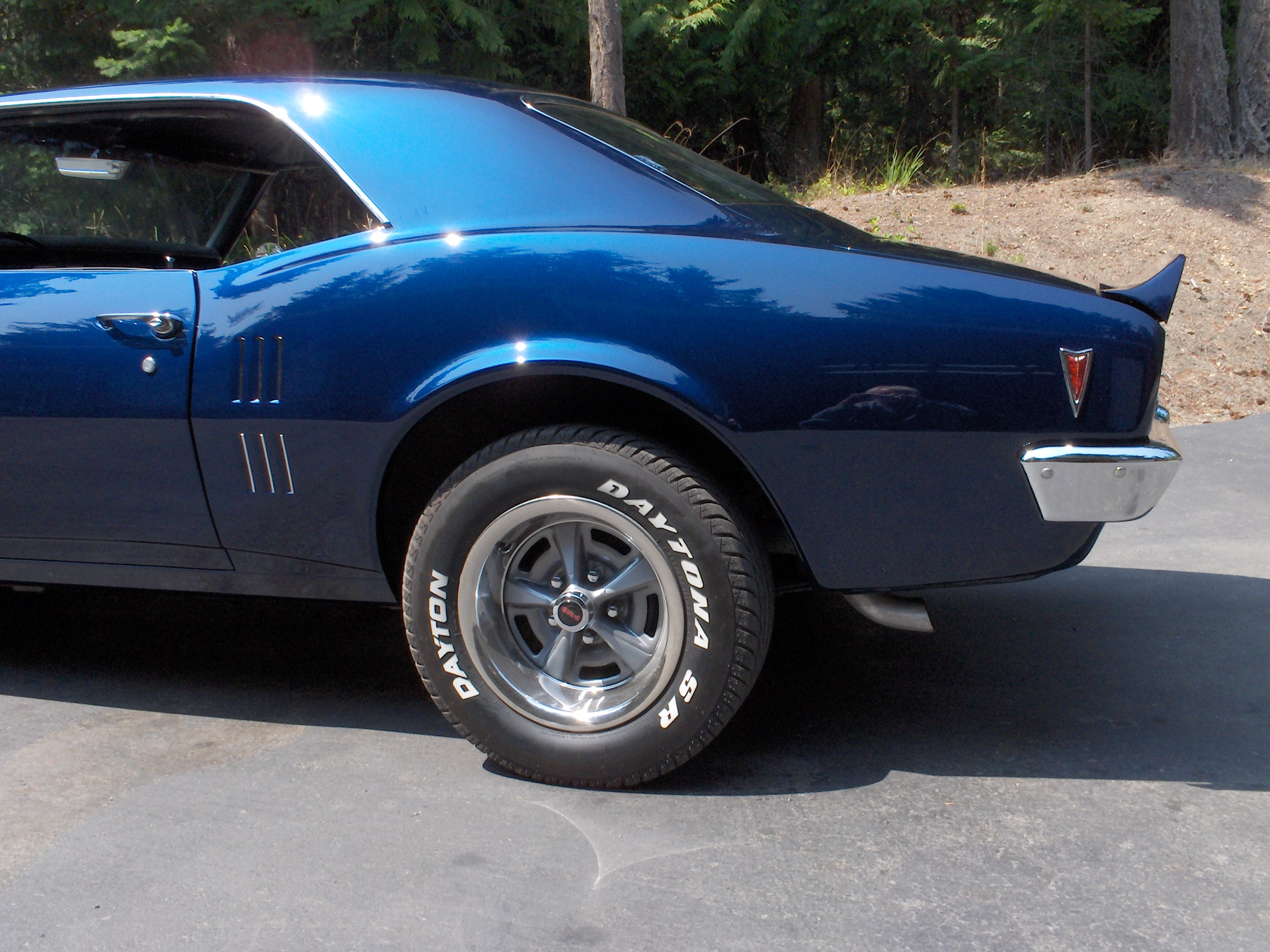

Yeah I need to do something with my tips. They just left them as 2.5" square cut downturns poking out in about the right place, mine are a bit further back toward the bumper than Bluebird's pic shows, but they were cut kinda rough on the muffler shop's chop saw (I cleaned it up some with a file and grinder when I got home). I might cut those back and make just myself a set of splitters one of these days, for a better and more original look.
But I've got other priorities for this car first...what the shop left me with works just fine for now.

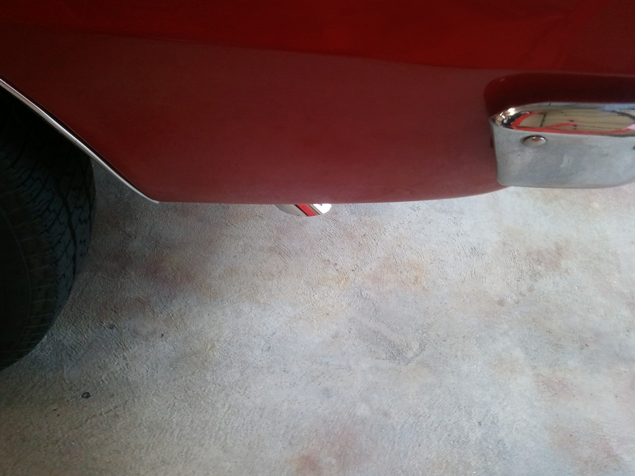

When I bought my car it had the straight out the back look. Couldn't stand that look. Had a local custom exhaust shop cut them at the bend and weld on chrome tips. Was about $100 parts and labor. Much cleaner look now in my opinion.

John, It's a GM paint "Adriatic Blue". The Oct 2007 issue of High Performance Pontiac featured a 68 built by a person named Doug Baril, he did a fantastic job on a car that most would have stepped away from. I'd been trying to get a paint shop in Sidney BC to match the dark candy blue I have on my 51 Panhead and put it on my Firebirsd. He couldn't do it. When I saw the paint on Barils car I contacted the shop in FL, Huegenics, and got the paint code. It was an almost exact match for the pain on the HD. My painter used that code to get the paint for my Firebird. The pics don't do the paint justice. Barils car is about a million classes above mine and the paint as well. I have the code somewhere but it may be a chore finding it.
