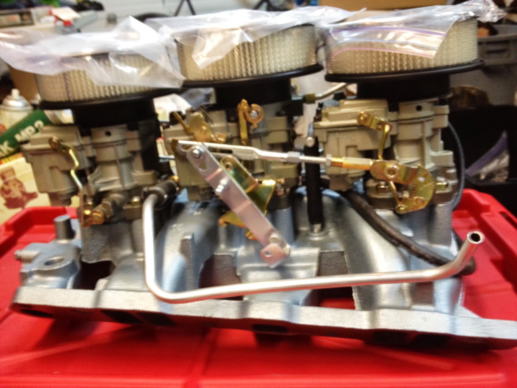

Thinking about a tri power set up on a '67/68 400 and have been told that a '66 GTO manifold will work. However, I am wondering if there will be hood clearance for the carbs/air cleaners. Anyone have any info on this?

I have a 65 Pontiac 389 Tri-power battleship. I will upload some pics and measure the clearances for you.

I had 66 trips on mine with no clearance issues.

Had a 66-3x2 on my 67FB back in the early 80's.
From memory it's lower then a stock 4bl.

It's 6.25" from the top of the intake to the top of the air cleaner.
