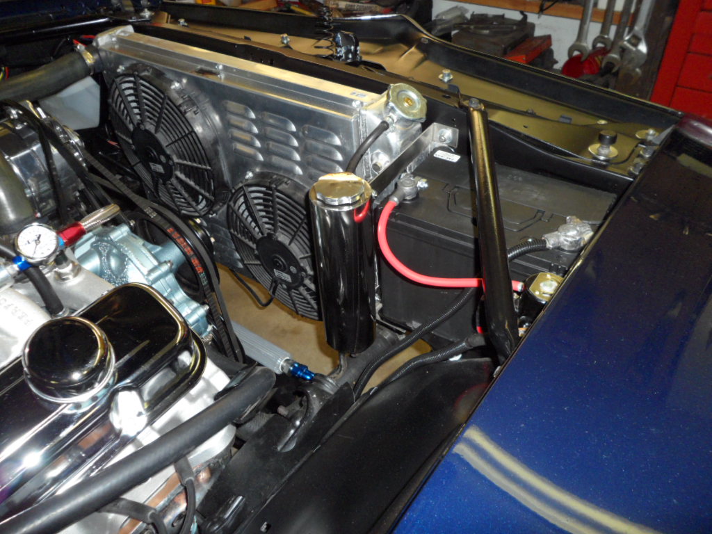

I agree with the plastic see through tank, I have to take the top off mine to see what's in it. I have the hood open to check oil etc. anyway but a pain.
