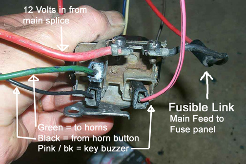

Having problems with horn relay,not sure if relay is bad. need wiring diagram for relay, and how to test it. I am new here. Thanks

Does this help you?
Diagram
or this image below?

Yes Both do. That is the best wiring diagram I have ever seen for my car. Will be great for future reference. The pic of horn relay helps a lot also....Thank you!!
