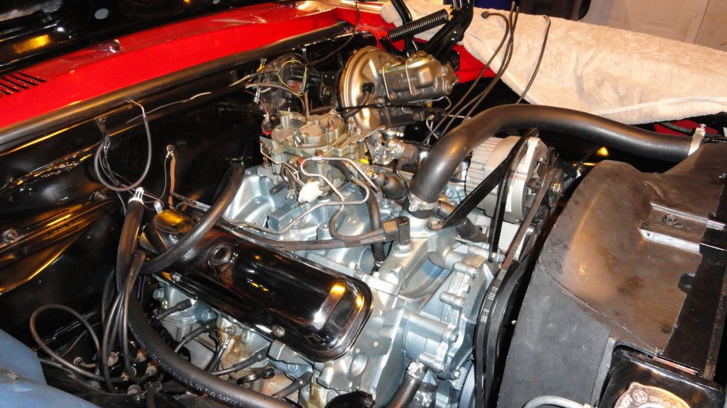

I used the Hirsch paint. I called them and they recommend primer on the steel parts and to spray directly on the cast iron. They also recommend 2 weeks dry time before starting.
Best to read the instructions or even call them on some of the best practices.

2 thumbs up on the Hirsch paint.

That is a beautiful motor rohrt....

Duplicolor D1616
