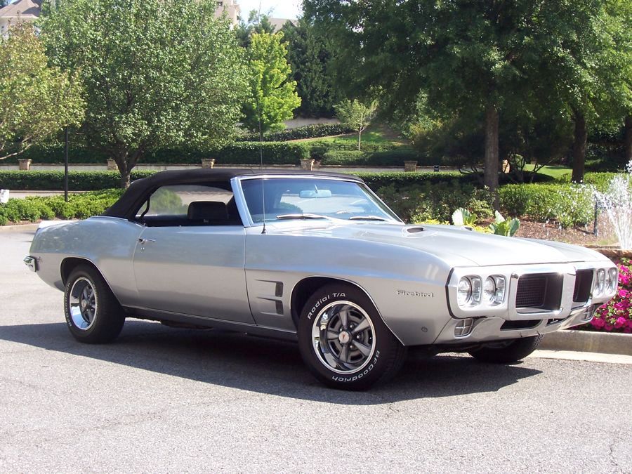

I have seen a few pictures of 69's with Rally 2 15" wheels and they look awesome. Do they fit without modifications? What would it do to mph on the speedo? Any concerns over which tire to go with? I have BFG and would want them again.

Mine has the factory 4 wheel drums and no plans to change them. I looked at the fronts a little closer and it appears that the 15" wheels with a similar sized tire from what is on the car will fit. I would want a overall larger wheel/tire look if I were to do it.
