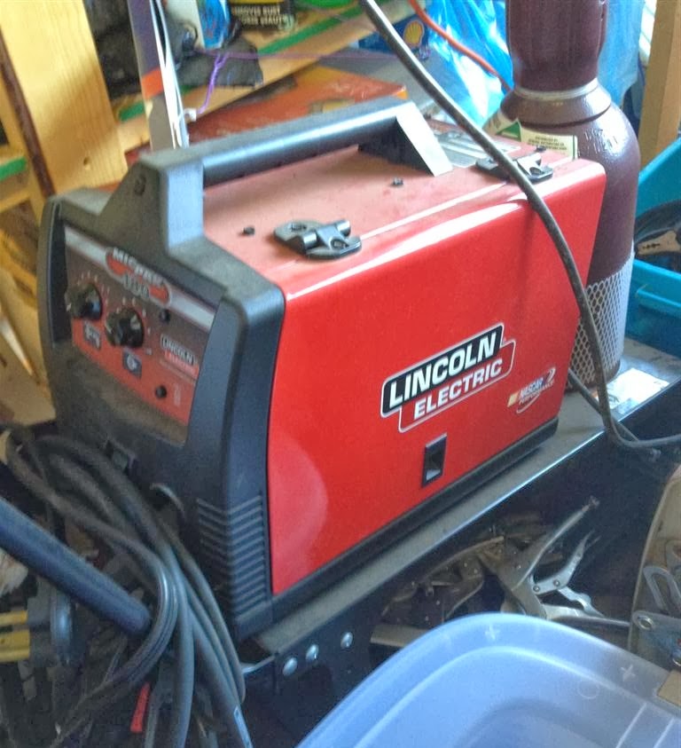

Well I got a Lincoln 180 HP on Monday. It was 160 bucks cheaper than the Miller at KMS. I used the difference to get an adjustable auto darkening helmet. KMS advertised they are a gas fill station and sell tanks but the store in Victoria has been waiting three years to start filling so I didn't get a tank or gas. Any suggestions on how large a cylinder for a casual user? They said the gas place in Victoria only exchanges and only one size. Gotta be someone who will fill whatever size cylinder one has? The welder specs at 20 amps input but has a 50 amp plug. So did all the other welders I looked at. I was going to cut off the plug and put on a 20 amp but the store said it would void the waranty. I bought 150 amp receptacles for my garage and car port. Now that I got it home I see I should have just rewired it with a 20 amp cable/plug that I could switch if I needed to take it back. How many units of gas does one use for every hour of welding?

a 4 foot tall bottle lasts us 6 months at work, sometimes doesn't get used for days but probably enough for you for 6 years. We buy from Air Liquide, I have a bottle that I bought for myself from them that's about 2.5 ft. tall that I just exchange when its empty, no refill and I don't have to re-certify the bottle after ten years, it just gets taken care of and no 70 dollar a year lease. I think the other suppliers do the same. Sorry I don't remember how much it costs to exchange.
68 ohc convertible 68 400 coupe 69 350 coupe(455 4 speed)
Joined: Dec 2008
Posts: 626
Joined: Dec 2008
Posts: 626 |
Gas lasts FOREVER in hobby-only usage. You won't need a huge bottle unless you want to ignore it forever which is convenient. Mine's about the size of my leg I guess....3 ft tall? I don't know the names of the sizes. I think i went 6 or 7 years of occasional usage and a near-full structural rebuild of my Fibird before it finally ran out. Most important IMO to pick a supplier that's convenient, and tha allows direct bottle exchanges. Recert fee will kill you in 10 years if you actually purchase a bottle and it eventually expires. $125 just have have it certified again I think?
Gas never expires so no harm in going too big. But don't waste money on a huge spool of wire if you don't plan to use it up within a year or so. Depending on wher eyou store it I've had entire spools go bad from just taking up humidity in the air over the years. For that reason I favor the small 2 lb spools since it keeps me from tossing them in the trash to avoid contaminated welds if they haze over with a dusting of rust.

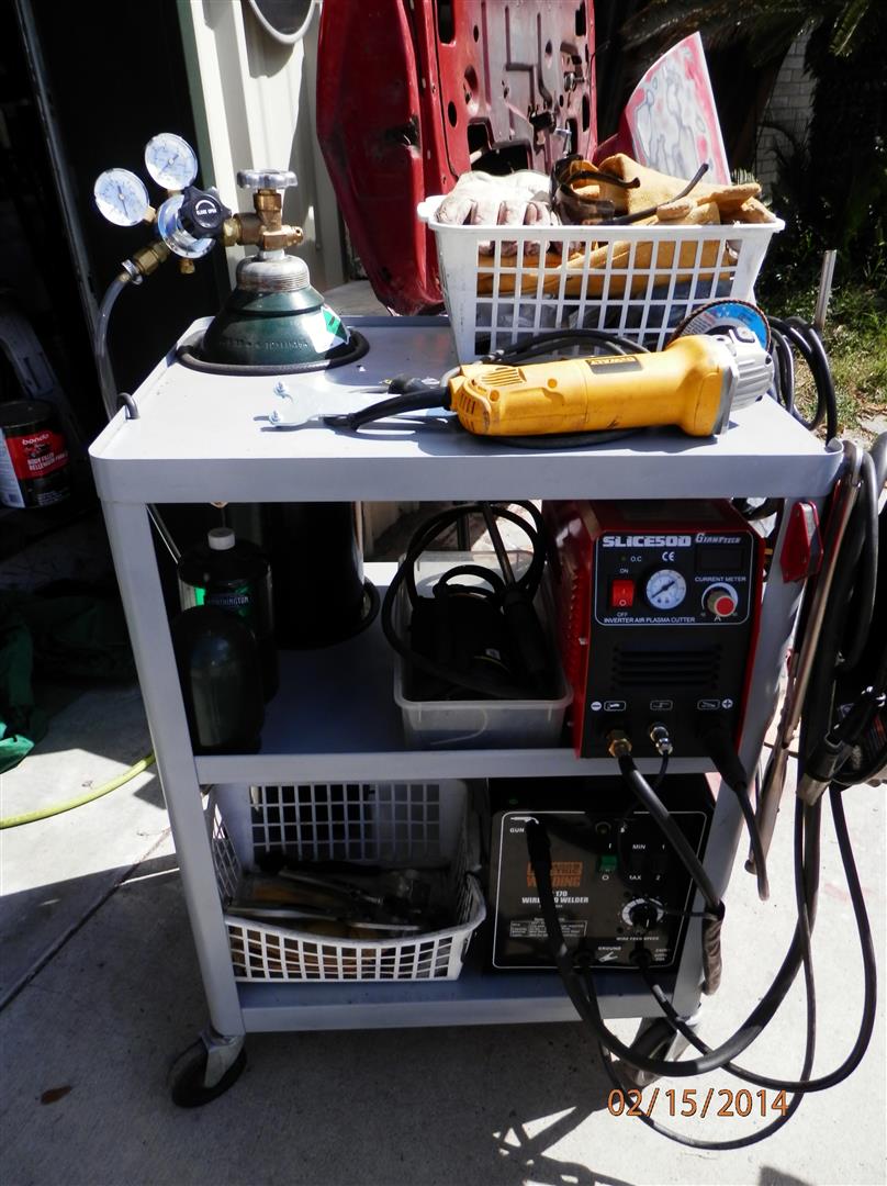

The 3' tall cylinder is 80 CF. The next size up is 125 CF, I think. I borrowed a buddies 125 100 % Argon after using the fluxcore for a short time. I did both 1/4 panels, and several other repairs plus a few little odd & end projects and used about 2/3 of that tank. I went and got an 80 CF off ebay $187 delivered and it came with a 10 year test stamp. I had it filled with C25(75% Argon, 25% Co2). Cost me about $50 to fill it. My welds were better with the C25 than the straight Argon. 80 CF Welding Cylinder

I can now confirm my bottle is the size of 68Blackbird's after seeing his pic, so I guess that means it's an 80 cfm assuming his comments are correct. Appears my 3 foot guess was about right. Photo of mine is not convenient at the moment.
I also agree that C25 is the gas of choice for MIG welding steel. Argon is incorrect as the CO2 is a very necessary component. Pure Argon is for welding Aluminum, not for steel.
Also agree with Firebird's comments...always close the main valve on the bottle when not in use. You don't want to rely on your regulator holding back 1600 psi or whatever these bottles are in long term storage...I believe most will seep very slowly and undetected.
