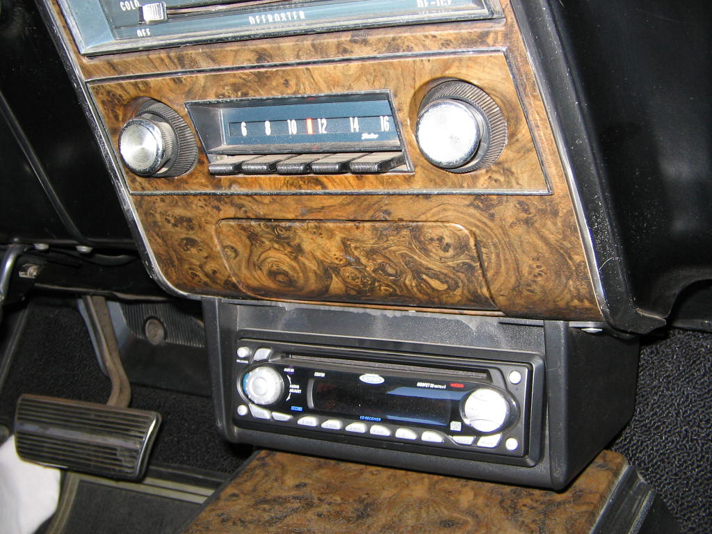

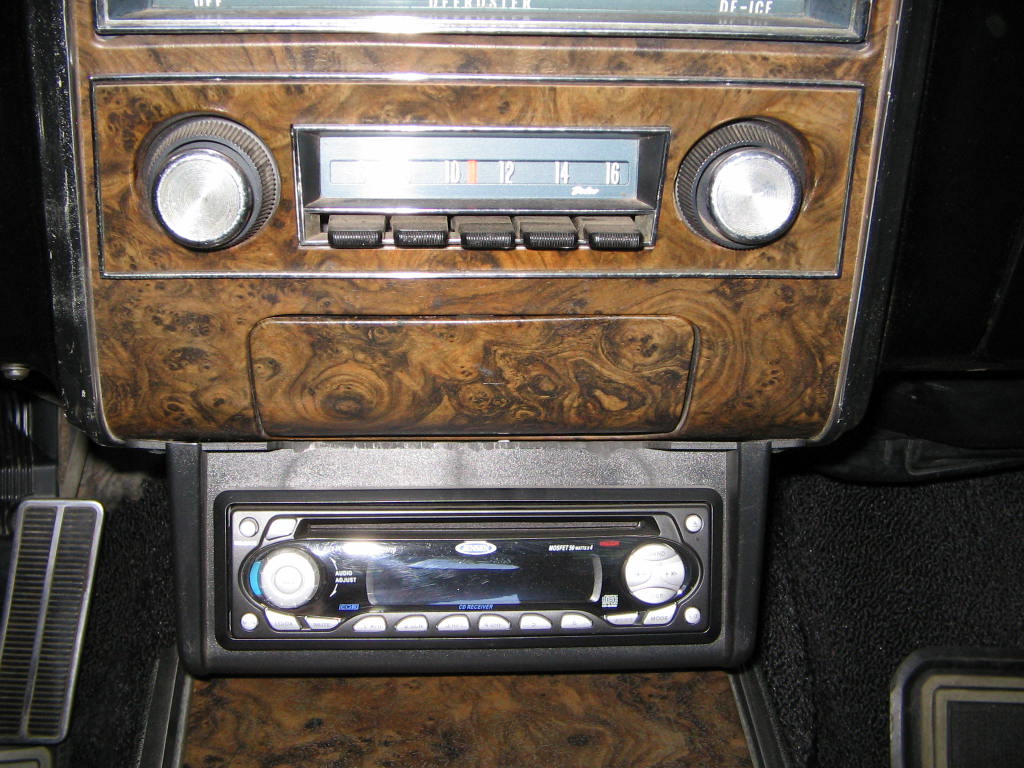

This works well and you can still find these under dash buckets at the radio shops. Totally reversible.
-Jeff
