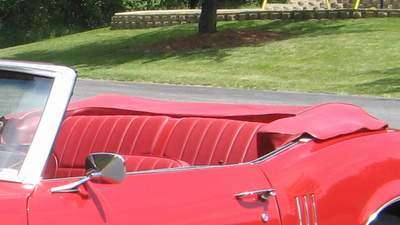

Does any one else have a problem with securing the front flap of the boot? There were a few times when at highway speeds the boot would lift in front and puff up like a baloon. I was worried that it might even fly off. To solve the problem I permenantly attached it between the seat back and the seat frame. When the top is up I lay the boot in the well. To put the top down, I lay the boot over the seat back and flip it over the top once it is down. Works pretty well and no more lifting problems
Does any one else have a problem with securing the front flap of the boot? There were a few times when at highway speeds the boot would lift in front and puff up like a balloon.
Yes, in a high cross wind. I try to tuck and stretch the flap as much as I can down into the space between the seat and the top. I have had the parachute effect happen more than once out on the highway.
Poor design on GM's part. Should have had a channel or clip system (like other Mfr's had) for the flap.
The first couple times I used the boot when I got the car I had that issue. Since then I stop the lowering the top at about a half foot before the down position and tuck the forward fold in to add an extra fold. Then the boot front flap seems to sit well down in the hole. I can't recall it ballooning up much if ever since. (It is still the factory original boot.)
