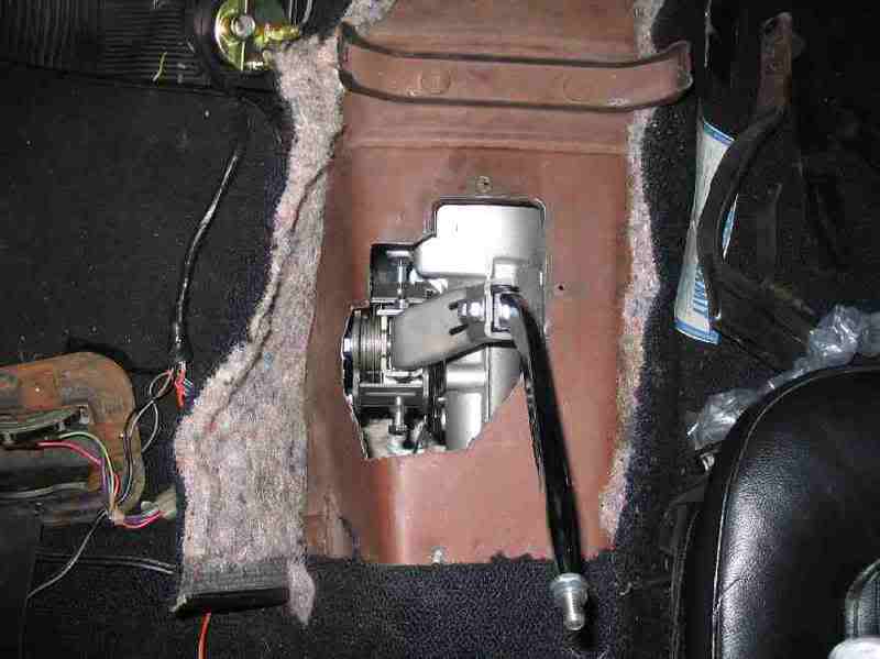

So, if none of the above is an issue and I'm good - I would need to open up the shifter hole so that it is something like the picture below to give myself Reverse/2nd/4th shift clearance.......and that looks pretty aggressive. I do need to measure for alignment on trans output and rear end, but ran out of time last night.

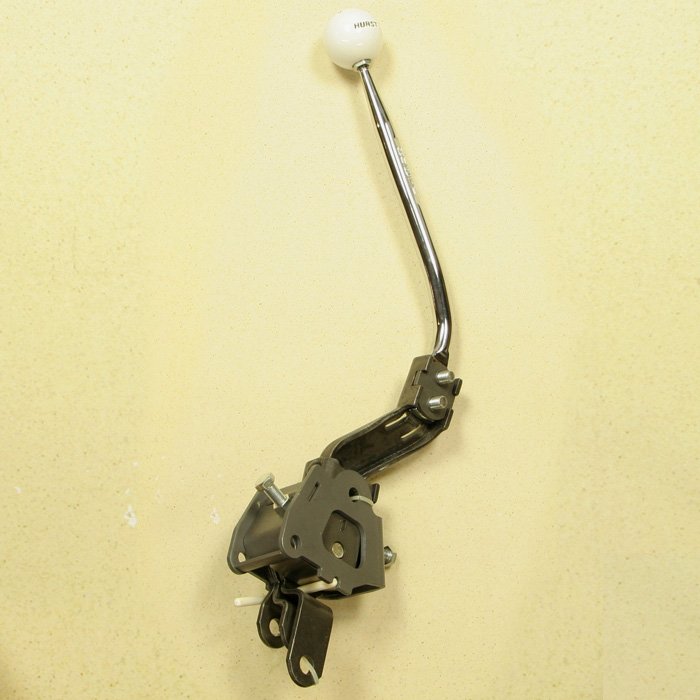

The power of the google may have helped answer this one - should the shifter arm (pre-shaft) relocate as in this picture? Mine definitely does not relocate this far to the right.

It was originally an auto and I don't have any issue opening up the hole, but going down the whole side of the tunnel didn't seem right. Looks like the correct Hurst Comp has a bracket mounting between shifter and the shaft which moves the handle over a few inches. I'll fab or order one and my only issue may then be opening up the rear just a touch.
