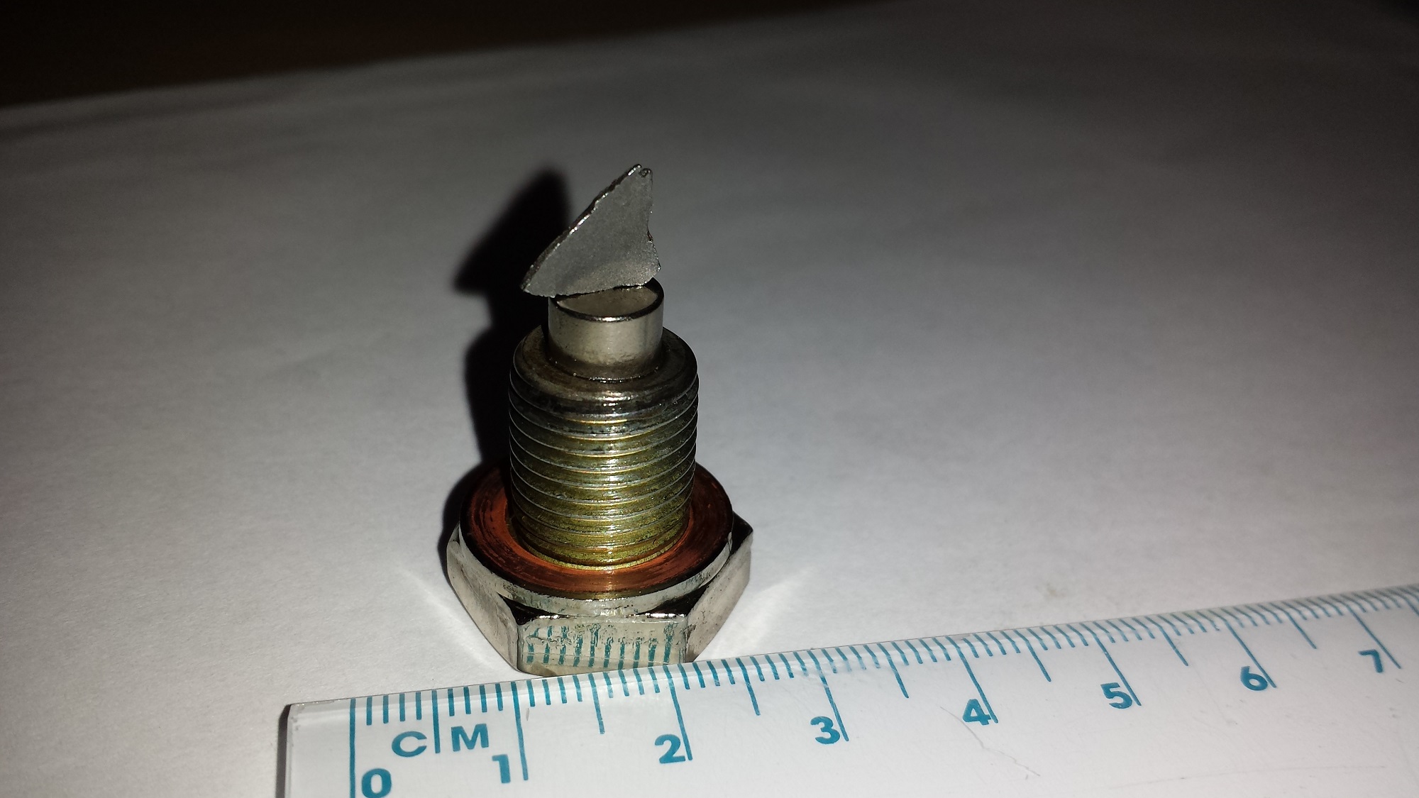

Took the oil plug out and was confronted with this metal fragment in the photos below. No smaller pieces or filings I have found yet. Pulled the oil filter and the oil was clear that came out of it.... I haven't opened it yet to see if anything inside.
Can anyone identify where it is likely to be from?
What are my next steps ... remove the oil pan and check there?

Thanks medhat for the fast reply... the fragment looks to have one straight edge and two jagged and no pressed depression as on the plate.

Is the piece stamped steel as It seems? It has a light area just above the edge contacting the magnet, that looks like it was under a nut or bolt head or washer. Maybe a piece of the windage tray or the oil pickup? What is the history of the engine? Could be someone put some baffling in the pan that came apart or lost the piece when it was assembled. Not much in the way of stamped steel in there to begin with.

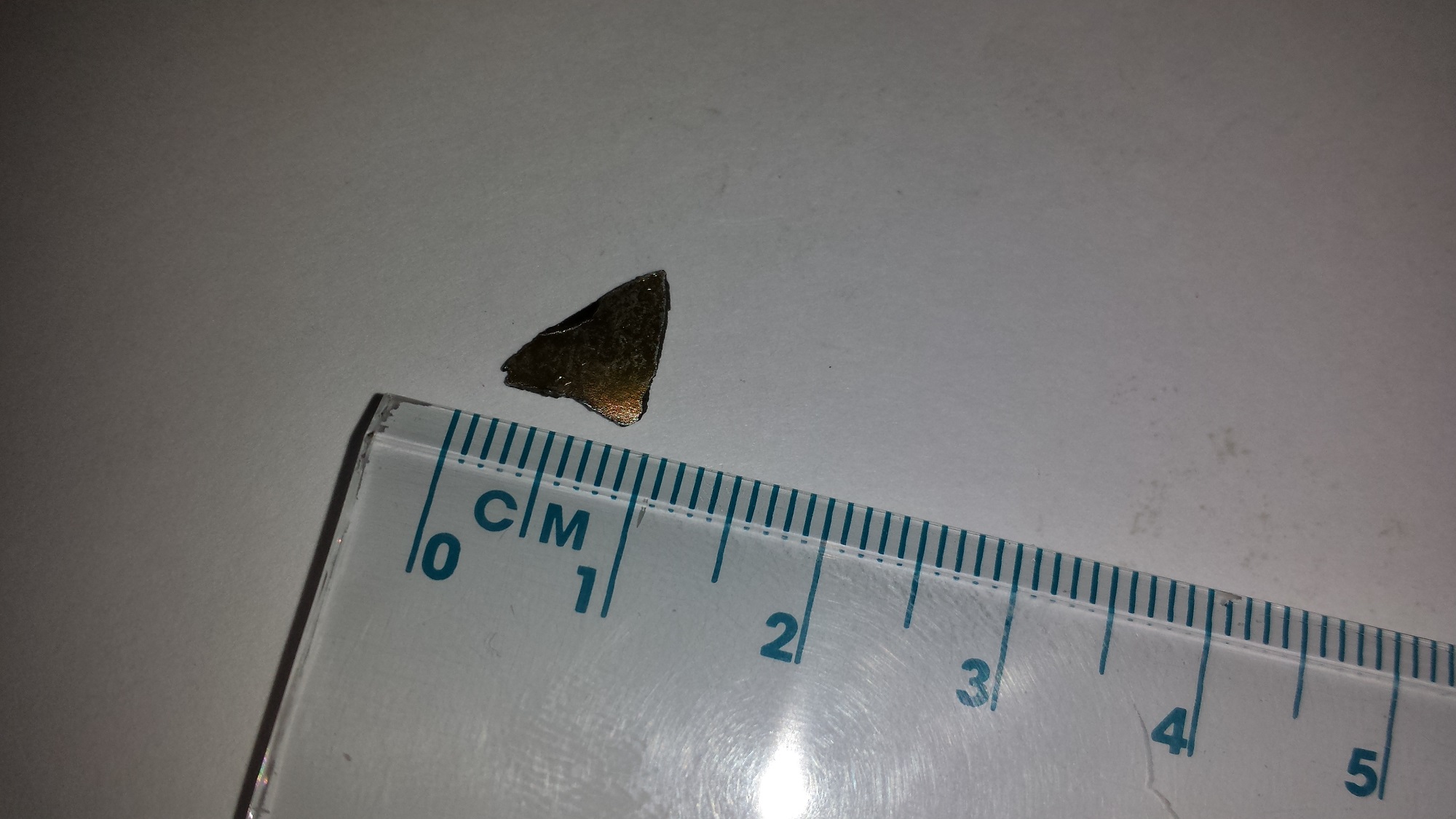

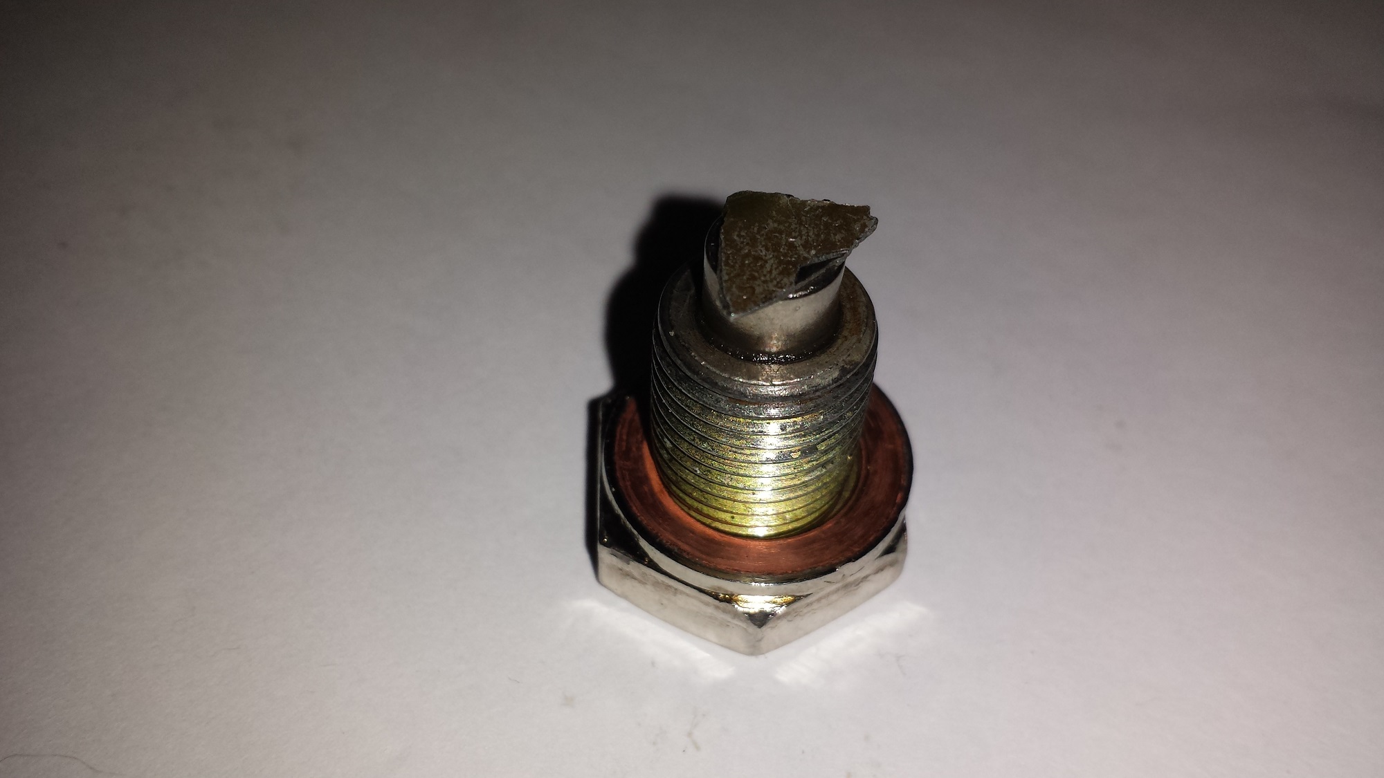

Might be pressed, a very fine bend in it. The lighter area you describe is where the bend is so possibly was under a screw head. Another pic showing the bend at the top of the fragment.

I enlarged the Photo and now it looks porous like cast Iron, maybe a piece of flashing? Don't know about a hole on the right side unless you have an inspection plate made for a right or left hand starter.
You really don't have to many options here. If you disassemble the engine and look for a broken piece you might as well rebuild it. It's hard to tell where the metal piece came from, could be anything from dropping a washer thru the carb to wear of an internal engine part, to something that a previously rebuilder caused. If it was me and the car still runs good, I would flush the engine with 4 qts of 10-40 and 1 pint of Marvel oil, let it idle for 15min. drain and refill with 10-30 and have fun driving it and have a Fosters! Sometimes we drive ourselves crazy over things we can't control...

Just a guess but to me, it looks like the stamping which stops the oil fill cap rotation on the underside of the valve cover. If you have chrome valve covers might explain the shiny side.
Looks like casting flash from just underneath the valley pan...webbing between lifter areas. If no other metal came out...wouldn't worry. I would however take a rare earth magnet and move it around outside of pan....or a new extendable probe with magnet and move to around inside of pan. I'd do that before pulling pan..oh..and id open up oil filter. And before I pulled the pan...id see if I could rent, borrow or buy a flexible camera to peek inside..I bought one for $85.
