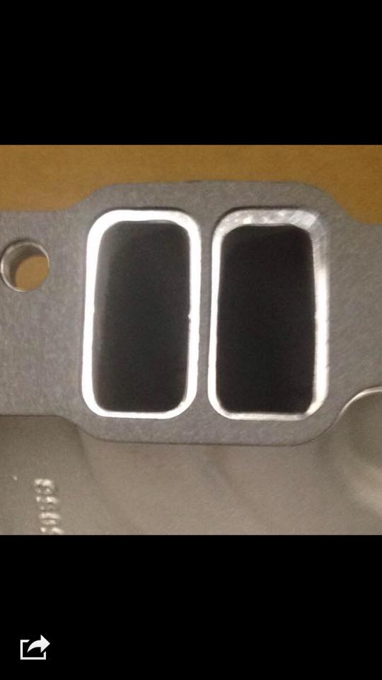

I’m in the process of changing intake manifold gaskets (stock cast iron intake) and was wondering if anyone has any thoughts on intake “port matchingâ€. Thought while I have it off I can fudge it a little, but reviews seem to be mixed on this subject, do, don’t, don’t use gaskets to match, etc. Any advice? Good results/experience on why to do it or not?

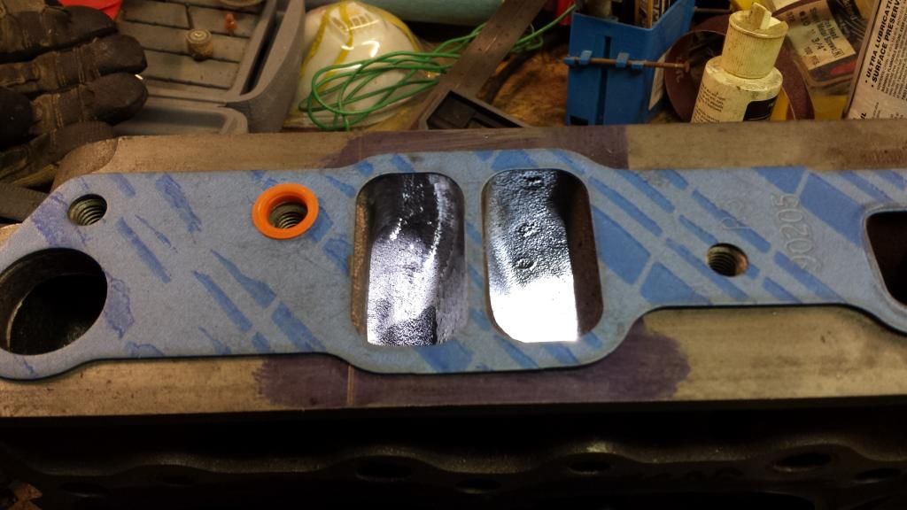

Use the orange locators in the felpro gaskets to line up your gaskets.
Need to index the gasket with a fine tip sharpie marker. Make marks so you can line up the gasket both vertically and horizontaliy. First I liine up the gasket on the head and trace the gasket along the top on the head itself and also make some tick marks up and down. Then line up the gasket on the intake and do the same.
I cut the crossover on the intake for a better alignment and so I can remove the intake if needed.
