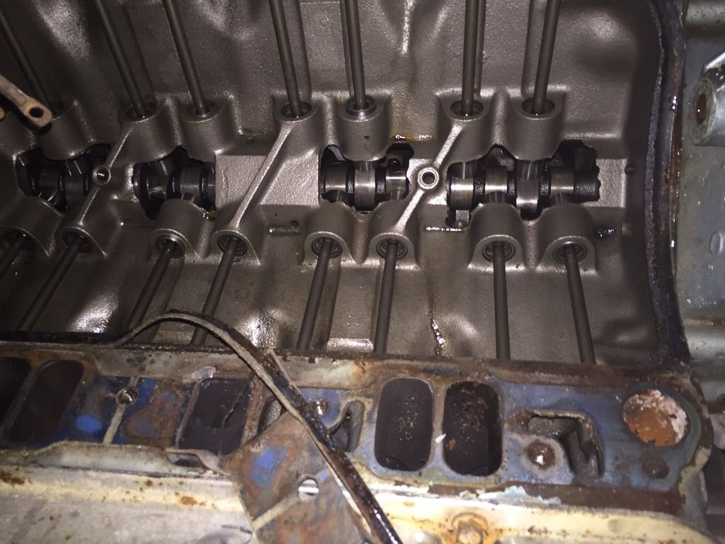

Finally took a valve cover completely off and the intake manifold. Can you guys tell me what Im looking at as far as how healthy it is? There is some sludge in two of the ports in the front but everything else looks pretty clean to me. How the heck do you get the left side valve cover off? I couldnt get a socket in on the far back bolt.

I think the motor looks pretty clean except for the sludge stuff in the water galleys! When I took mine apart it literally had carbon wrapped around one of the lifters. I had to knock it off with a hammer it was on there so thick. I had to have a rebuild.
The valve train, cam, and lobes look clean. I would get some assembly lube and smear it on the cam just like they do for a break-in procedure. Find someone who can lend you a priming tool or buy one for $18. At this point you only have less than a dozen bolts on each side to get the heads off. Then you could really see where you stand with the pistons and If all looks good and there is no rust, loosen the belts and you can turn the motor over by hand to see if it is frozen.
If that proves to be good I would coat the walls of the pistons with oil. Clean the water galleys in the heads as best you can and put the heads back on with new gaskets. You will need to flush the coolant out once you get it back together but now you have a better idea of where you stand.

It looks very clean on the inside. Water gallerys look gummed up. Possible head gasket leak?

Back when it was running there didnt seem to be a headgasket leak. Is it possible thats just from sitting for so long? You think a flush, new oil and some isolated fuel and I will be good to fire her up?

I can understand not wanting to pull the heads. Then you need to disconnect the exhaust manifolds, take off the mounting brackets for the alt and power steering, air cond. stuff. It really does look clean inside. It is up to you. If you don't think that you will have the "would have, should have, could have" and you are confident then put it back together. I would still put break in lube on the cam since everything is really dry from sitting. pour some oil on the lifters and let it soak down inside. also try some lube in the pistons (it will smoke for several minutes till it burns off). maybe rebuild the carb and see what happens. Use wisdom and read what others have offered. I am no expert.

Engine looks fine inside the lifter galley. The coolant passages are typical for an engine that sits for years with old or no coolant. Unless you want to pull the engine the best you can do is try and flush as much as you can with a garden hose. They do sell chemicals that supposedly help clean out the coolant system but it would take a few times and you would have to keep flushing out the system to remove all the residue.
a good radiator shop could check and flush out the radiator and even take the tanks off and rod the core.
Remember never to fill the system with tap water and only use distilled water and the proper antifreeze ratio.
