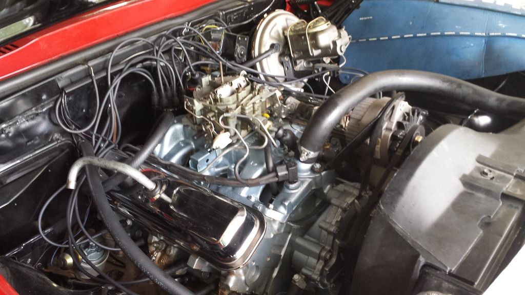

At random times under hard acceleration my belts have a tendency to screech. Not sure if it is too loose, too tight, or what but its embarrassing when you put the hammer down and the screech is almost as loud as the exhaust
Restored by me. Not a professional. Restaurant worker by trade. YouTube forums and some trial and error built this beauty. Sheet metal replacement. Body work. Paint. Rear gears. Interior. And engine. ALL ME. Toot toot

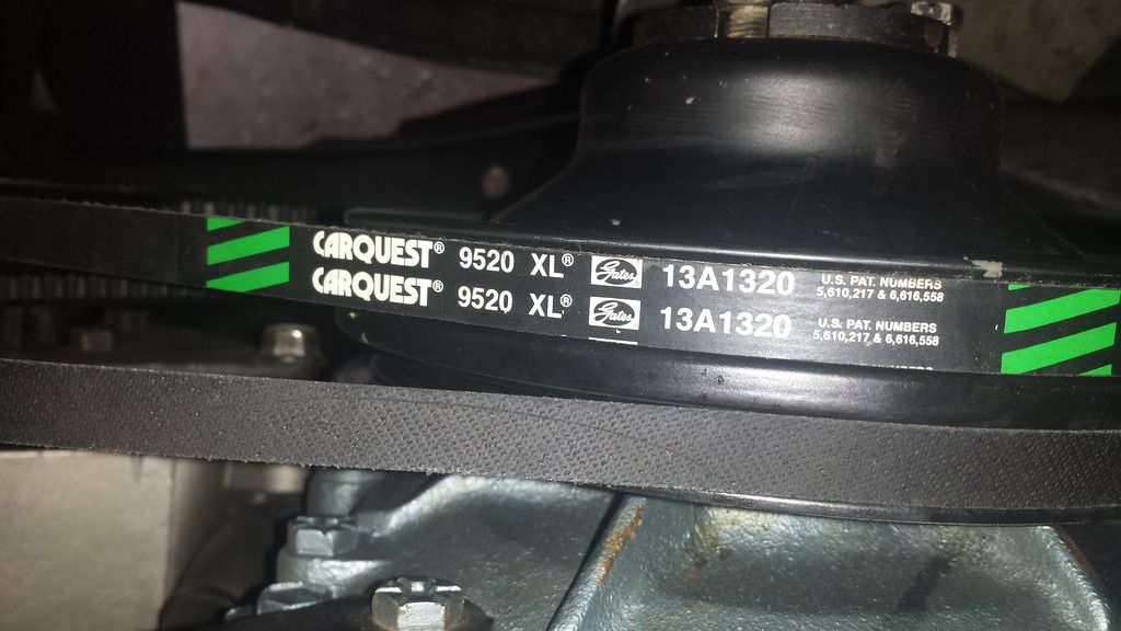

Here is a pic of my belts. The carquest belt is wider. I thought it was a 17xx belt. I might be wrong. The Alt belt was the 15xx belt. I tried to use the original size 3/8 and 1/2 belts that I got from Grainger. Gates has them. But the 3/8 is just to small. When I would rev the 455 it would throw the belt. You can see from the pic they ride a bit high but not excessive.
Thanks for clearing up the size. I read that the 15mm was in between but never verified. 1/2 = .5 3/8 = .375 15mm = .59 17mm = .669
Just remember, it's not just the width that you are looking to find an equivalent to, its also the cross section (height and angle) when moving from an original standard size to metric.
