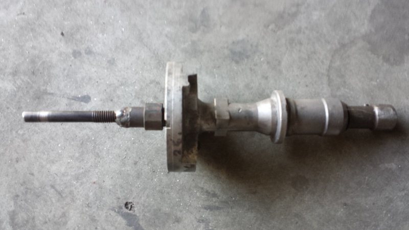

I have an old distributor that I modified that I use to spin the oil pump drive using a 1/2" drill.

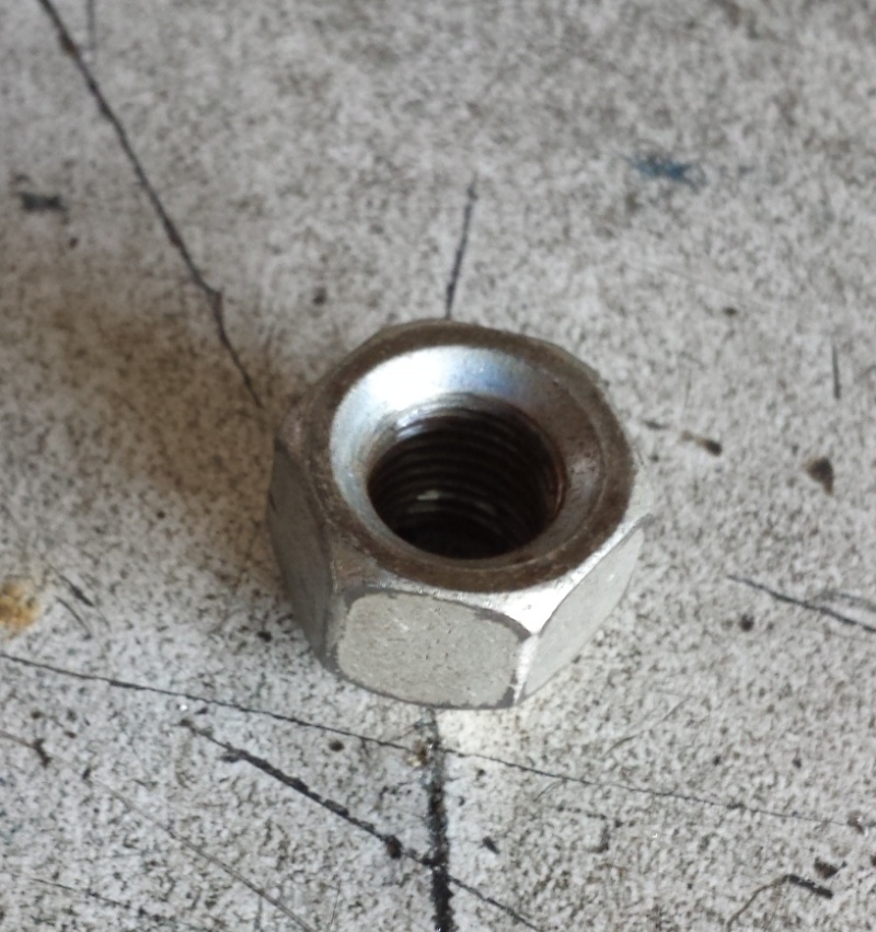

The factory rocker arm nuts that you torque down on the bottle neck studs are different at the bottom than regular type locking nuts. So you can't just use any nut and torque it down.

What did you do to modify the distributor? I have an old points distributor I can modify if you give me instructions.

On the distributor I cut all the teeth off the distributor gear and cut the top plate off the shift and welded on a piece of steel to extend the shift so I can attach to my drill.
I'll try and get pictures today.

Here is the modified distributor and the correct rocker arm nut for the bottle neck studs.

Thanks brother. I can build that
